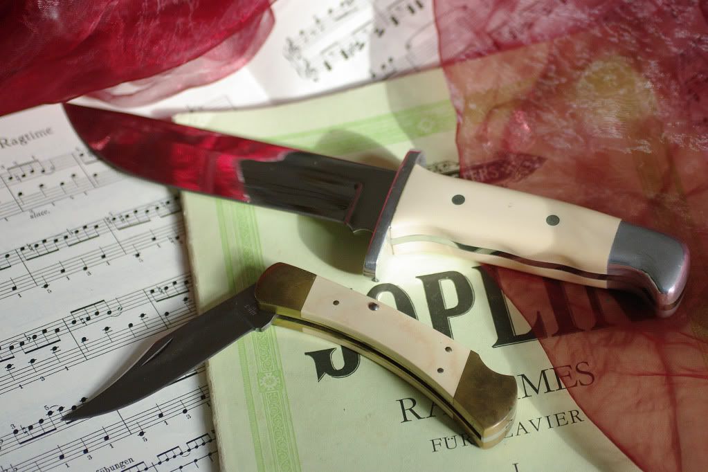

One thing I wondered about is whether when Buck made the transition from hidden tang to full tang construction on this knife if they also switched to the ubiquitous aluminium guard and pommel at that time. Or did 124's continue to have stainless
guards and pommels through out the rest of it's original and subsequent run?
The catalog descriptions and photos I've seen of the 124 le (reproduction) indicate it's aluminum. Magnets make testing this very easy.
What's the material of these components on your white 124?
The 122/124 was first issued in 1967, Phenolic handles & stainless guard & Butt. In 1971 Buck went to Micarta handles & sainless guard & butt. The switch to aluminum guard & butt took place in 1973. Hope this answers your question. This information is in the Dec 2006 BCCI news letter.
