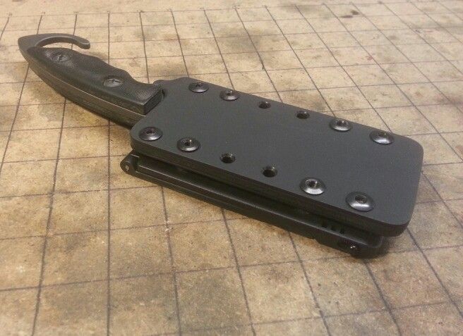

Most of you guys know I don't make tactical stuff much. I use it a lot, but I tend to stick to the outdoor theater and natural materials... Not because I don't like it or buy/own it. Mostly because there are a lot of really good (most of them right here in this forum) makers in that arena that make outstanding knives.
That said, I do think there could be a few more sheaths out there for tac knives that fully disassemble. When we use OC/CN/CS or go into a lab or really dirty environment that crap seems to get in every nook and cranny. And the last thing we want it to carry that crap into our homes, offices or vehicles.
I did the below knife and sheath as a request, and designed the sheath to be broken down. It can also be mounted in a variety of ways. Pictured with Blade-Tek MOLLE-locks. The sheath itself is .060 kydex front and back with a 3/16" center section. All bolted together. (I originally used aluminum for the center section but even with little bumpers in contact areas you'd get a clink lr rattle here and there. This is quieter and lighter...) Not tooting my own horn but would like to see more sheaths done this way...
-Eric
I have found that .060 works great for neck knives and .080 for tactical and hunters. Thicker kydex does not form as well for me.

Oooooh. Share? If not, I completely understand. I like to contour the front of the handle which feels great in the hand and locks the knife in tight to the sheath.

Eric,
I like a lot your sheath concept, what do you think about the center section made of leather? I think this way don't dull the knife.
ABS doesn't dull the knife actually. Probably easier on it than 90% of stuff the knife is put through. And leather doesn't decontaminate. Which was the goal ITFP.
-Eric
