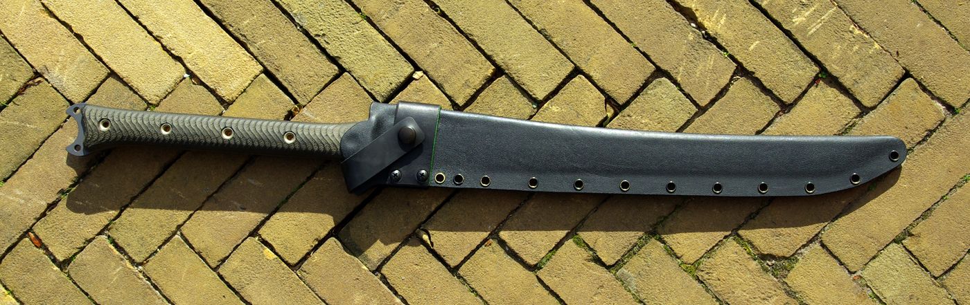

does anyone use .125 for sheaths or is it too thick? i want to make a sheath for my waki and i want it stout. would .093 or .08 be good enough? i want to order some camo kydex but dont know a good source. any ideas?
This one is 0.125", but 0.093" will also do.
For camo kydex go to knifekits.com or interstate plastics.com.
Good luck!
thanks martin, its funny that YOU answered me since i am going to get a leather waki sheath from you after i get my waki. wanted to try my luck at the kydex.
i prefer .060 for just about everything. i've only made two Waki sheaths - one from .080 and one from .060 i carry the .060. it's not flimsy, at all. however, it's a sandwich, you might need thicker if you're making a taco.
.125 is fine for a Waki. As Martin said, .093 would be fine as well. Depending on your press, .125 may be harder to get a good form on, but the stiffness will make up for it on retention.
I wouldn't go to .08 myself on something that size, but others may disagree there.
