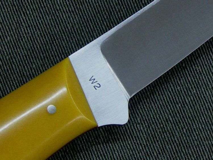

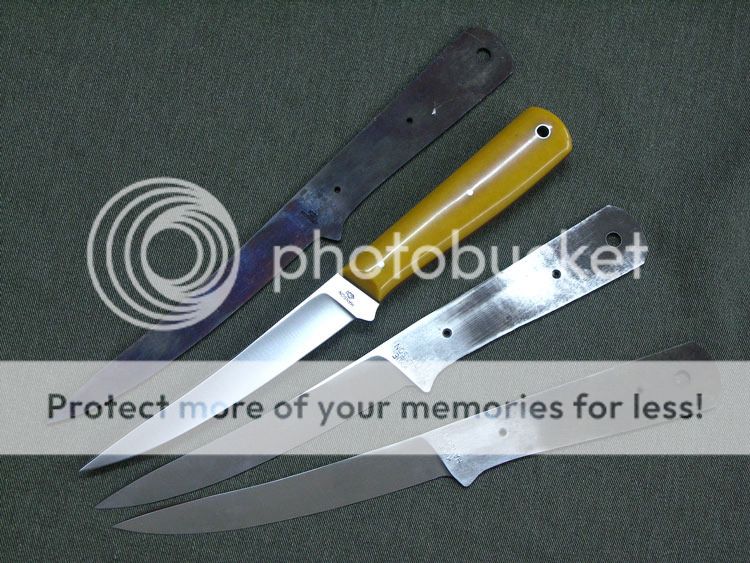

12C27 is a fine steel for a fillet knife, if you want stainless. I use W2 for the knives we use here.
Nice looking knife Don,
Is that linen micarta used for the handles? Also how well does W2 hold up in saltwater use?
Sent from my SAMSUNG-SM-G890A using Tapatalk
Thanks Travis. This is very old micarta and appears to be paper based. W2 will hold up to saltwater like any other carbon steel, 1084, 1095, 52100, 5160, ect. I used carbon knives in the commercial fishing business in N Florida around saltwater and never has any rust issues at all. But I did take care of the knives, kept them rinsed off and dry.
