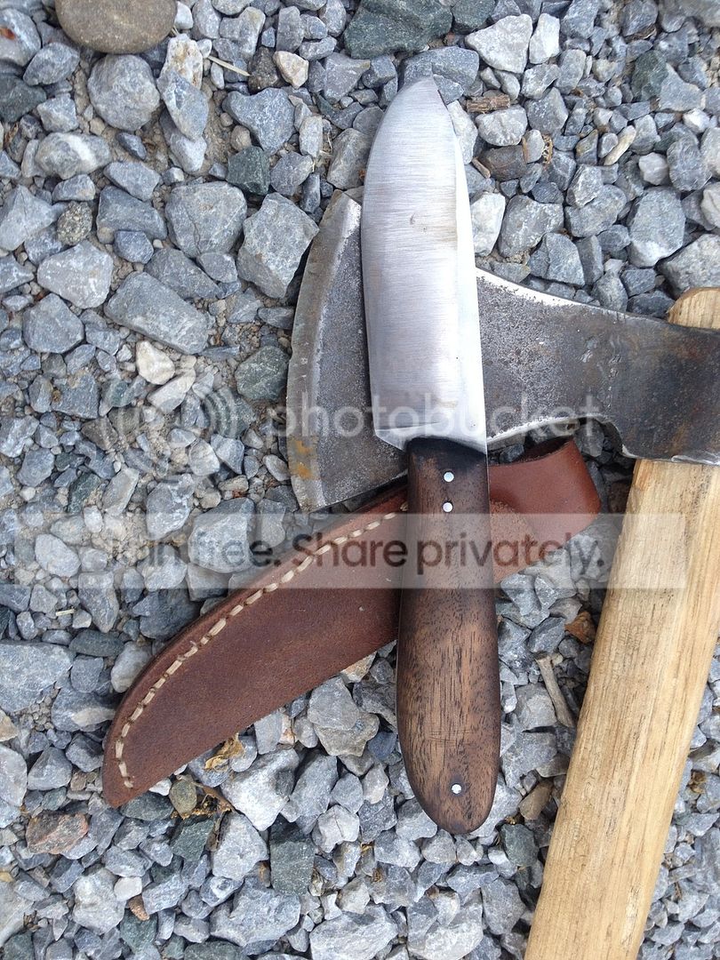

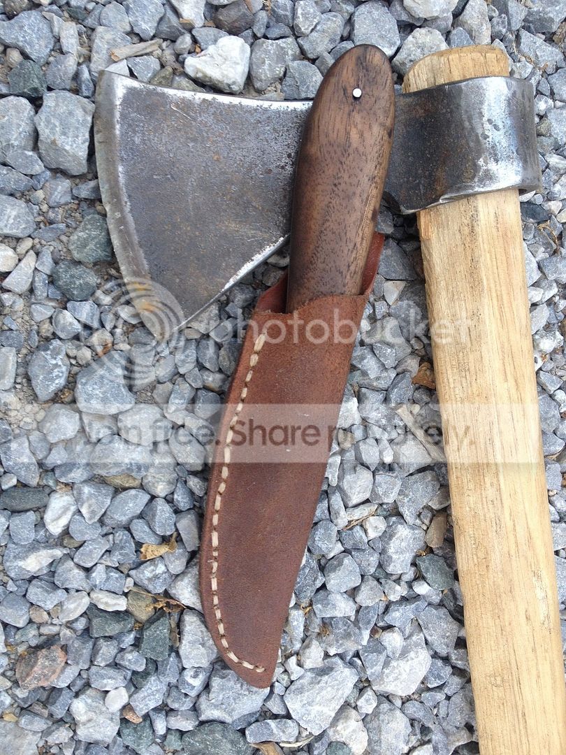

Hey all! Here are two new knives, both 1084 and walnut. Also, I started making sheaths, so there is some leather work in there too. The first one is a small 5 inch OAL knife... my first try with any filework. I was actually going to throw that blade in the scrap pile because of some imperfections, but then I wanted to try filework so I pulled it back out, After that, I liked it so i decided to actually make it into a knife..so now its my beater :). The other was a bushcraft knife that a gentleman ordered from me, OAL is just over 8 inches with a really tall grind, its a slicing machine! The sheath for this one was suede side out on request.
Congrats on getting two more done.
Comments and suggestions for areas of improvement:
The overall fit and finish need some work. You need a lot more sanding and evenness.

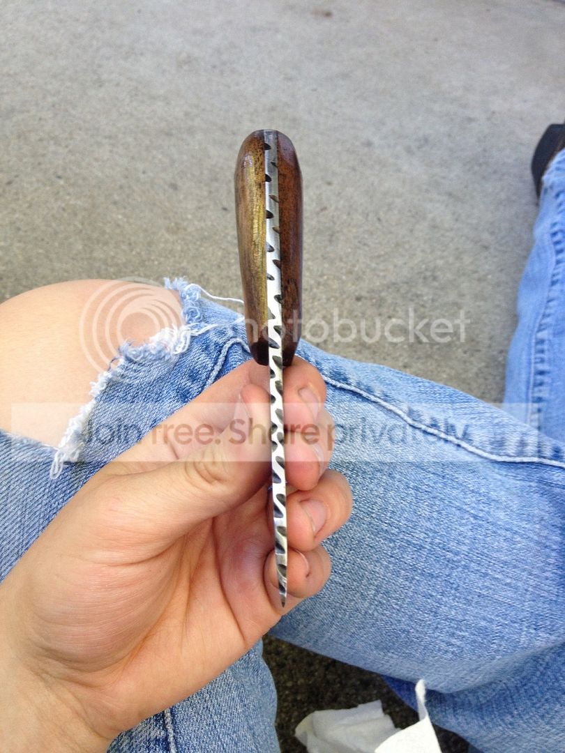

The filework up under the handle on the top doesn't fit. Maybe spend more time on the finish and less on the filework. Filework needs to "fit" the knife style...it really doesn't here. It is also a bit wide in the pattern. Tightening it up a bit would help. Also, filework should taper in spacing as the blade tapers toward the tip. By the time it gets to the tip it should be really tiny.
The tip looks like it broke off in the first photo?
The handle looks a bit "fat".
It also looks unfinished. A few coats of sanding sealer and then sanding to 1000 grit would make a big difference. Other choices would be Tru-oil or a similar finish.

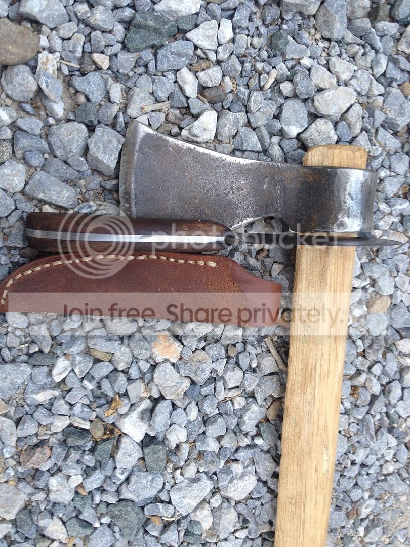

On the last photo, the butt looks uneven from side to side?
The pin placement need to be re-thought. They also need to be installed much better. The holes are oval and blown out.
The blade looks quite thick. On a small knife like that 1/8" ( .125") is thick, .090" is about right, and .060" isn't too thin.

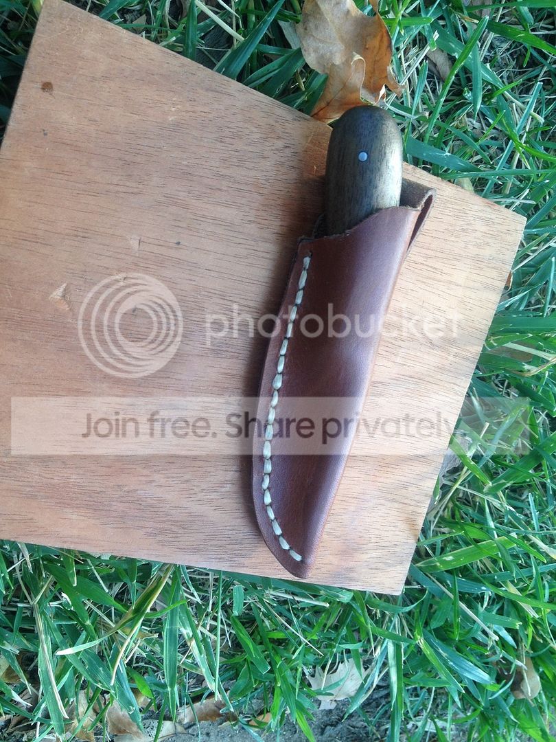

Look at a few sheath tutorials and learn how to "saddle stitch".
White thread shows the stitching boldly. If it isn't dead right it will show. Dark thread hides the stitching better.
The flesh side (suede is something different) doesn't really work well on the outside.

The file work was my first attempt on something fun to try....I'm practicing the climbing vine pattern. I had to re-establish the tip, but it has one. I sanded to 1500 and it has 5 coats of boiled linseed oil topped with paste wax...I'll try tru oil since it builds up better. Pins are something I'm hsving an issue with...the backside of my holes want to blow out. I need to peen them better to fill that I guess. Ok. That was done saddle stitching. I'll post pictures later of my better sheaths I have made, those were some of my first ones

Your knives are getting better each time. I like that you are bringing the bevel up higher. Drill your holes from the outside of the scales so when it blows out it is on the tang side. Drill them first before any shaping and you can sand them clean.
I don't like the handle wood, it's too boring. Is it just flat sawn walnut? I would try quartersawing it and/or hunt for prettier grain. And as Stacy says fill the grain and maybe an oil finish.

Once you drill through the tang and handle material, install a temporary pin. Then drill the other hole and put in another temporary pin. Now trace it on the handle material and cut it out. Use this for the other side and your hole will be drilled the right way. If you sand enough it shouldn't matter which way you drill it. If you are using 1/8" pins I would recommend using a #30 bit which is .0035" bigger so you don't have to force the pin. The function of your knives are getting better and better. Now, focus on the finish and you will have it!
