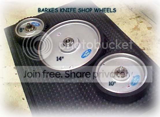

I use a 8" 10" 14'' inch wheel. I love them all. Its better to have them when you need them. Then to need them and not have them. -------:thumbup:
Here is a photo of my wheels. Just for hollow grinding. The 8 inch wheel will give you a deep hollow grind. The 10 inch wheel will be in the middle. but the 14 inch wheel will be almost flat but you can still see and feel the Hollow in the blade when you pass your finger across the blade. I hope this is the information you was asking. I had to stop and think about it for a minute.
Terry
I've got 8", 10" and 14" wheels without a doubt the 14" I used a disc for a long
time for flat grinds but rarely flat grind anymore. Ithink they hollow grind straight razors
for a reason.
Ken
