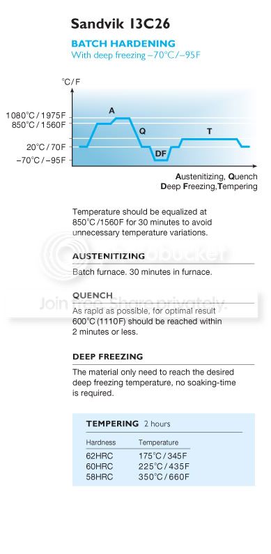

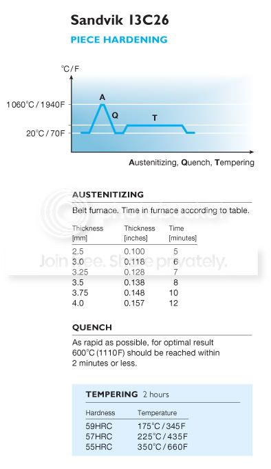

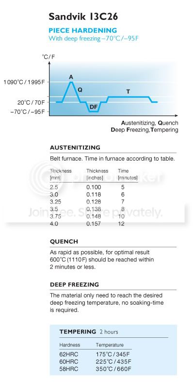

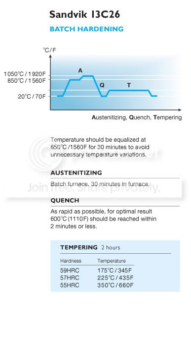

Does anyone have a good heat treat schedule for Sandvik 13C26 blades and springs as it pertains to slipoints? Thanks.
Sandvik's website recommends 1995F/345F temper. It gives 59 rc without cryo-quench, 62 rc with.
Here's some info John

Thanks very much....now I just rneed to find out spring temper temps for R 47 or so. Thanks again
