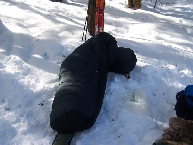

Here is what matters. It's 36F and raining. Why are my hands turning red? Why am I concerned?
It's the liquid water all around me. It's dripping off everything. The snow is slush. It penetrates everything. It sucks the life out of you. It's a nightmare. You're wet inside and out.
Ok now why am I tossing my down sleeping bag into the snow without concern?
Because there is no liquid water threat. The snow sticks to nothing. Go out in the woods and come back with a cup of liquid water in extreme cold. It actually can be done but it's going to be work or luck. Better take along a thermos as well so it won't freeze. This is why 36F with rain can put the hurt on more than -36F. The pervasive abundance of liquid water. My post makes it clearly obvious perspiration is known by me. I got no clue why your response was what it was. Also I don't know about tennis shoes in Korea. Why do people online know so much about everything under the sun. I mean does anyone in real life know as much as people do online? Not busting on you about this as for I know you're a history buff but dang!
