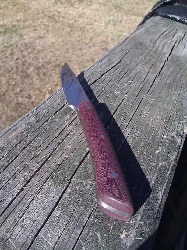

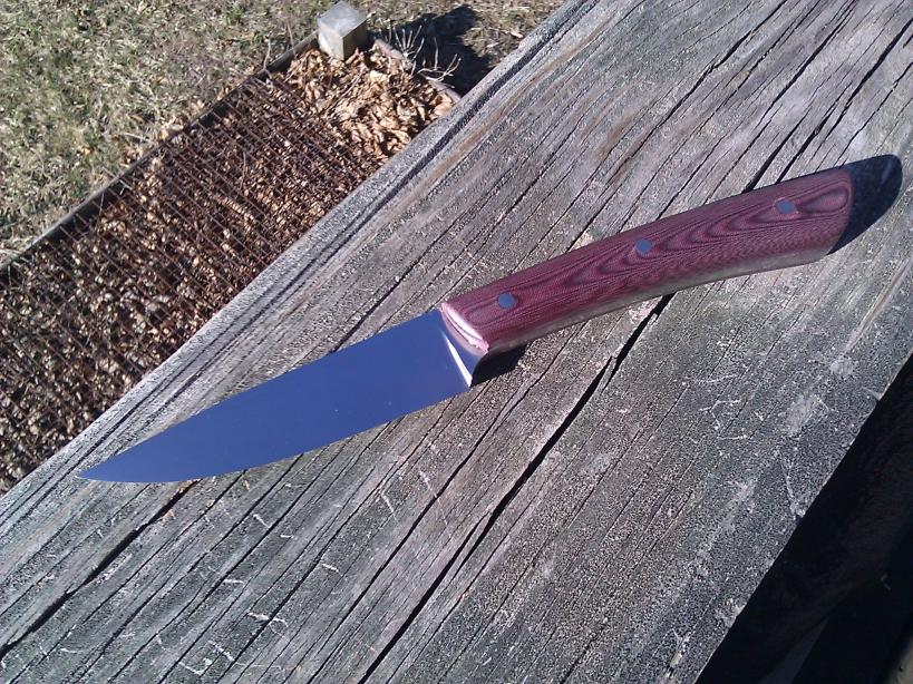

This is my first stainless knife in 154CM. The stock was oversize, so it's a bit thicker than ideal. The handle is marooon linen micarta with 9/64" (don't ask) stainless pins. I've got some 3/32" A2 and will have to get some 3/32" 154CM for more of these.
Blade is 3.4" long, sanded to 1000grit.
Handle is sanded to 600grit.
There's an oddity in the handle around the rear pin on one side, not sure what's going on there. Perhaps a heat effect - the micarta is very burly and could have used a coarser sheet on the disk sander.
The handle is left a little large and blocky for my mom's arthritic hands. This knife will cut a lot of Gin and Tonic limes!

Yes, it's thicker than ideal. I have a couple 1/8" ones that work pretty well. Given where this will go, I'm ok with it. My mom has at least one or two paring knives with broken tips... I'd like to sell a couple in the future, and those will be the 'right' thickness.

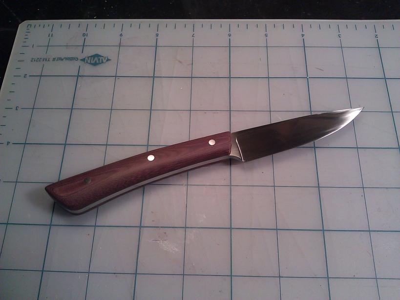

DEllis, technically it's a slim 'Hiker' ;). It's identical to my Hiker model, but scaled down 75% from spine to edge.
The original Hiker pattern was supposed to be a paring knife, but it was too tall found its own niche.
