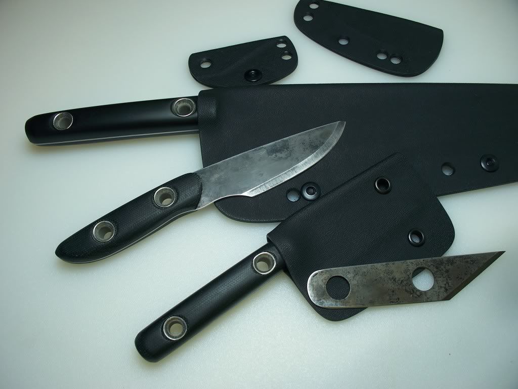

Here's the batch together and oiled up! They are not oiled in the other photos, that is why they look a fair bit different.

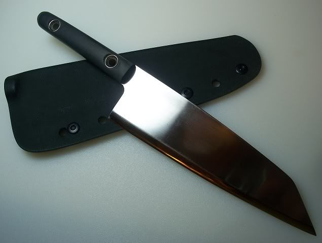

Japanese Style Chef's Knife - Laser! This one is super light and feels great in the hand. Scary sharp :eek:
Black Paper Micarta Scales with Stainless 3/8" tube hardware

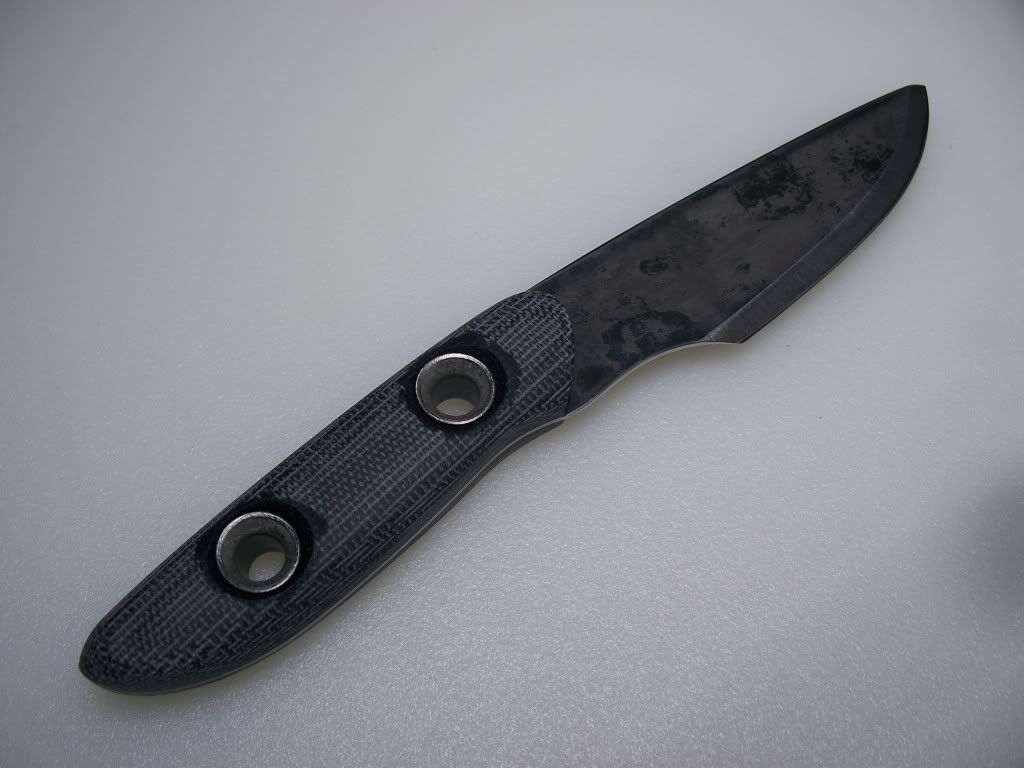

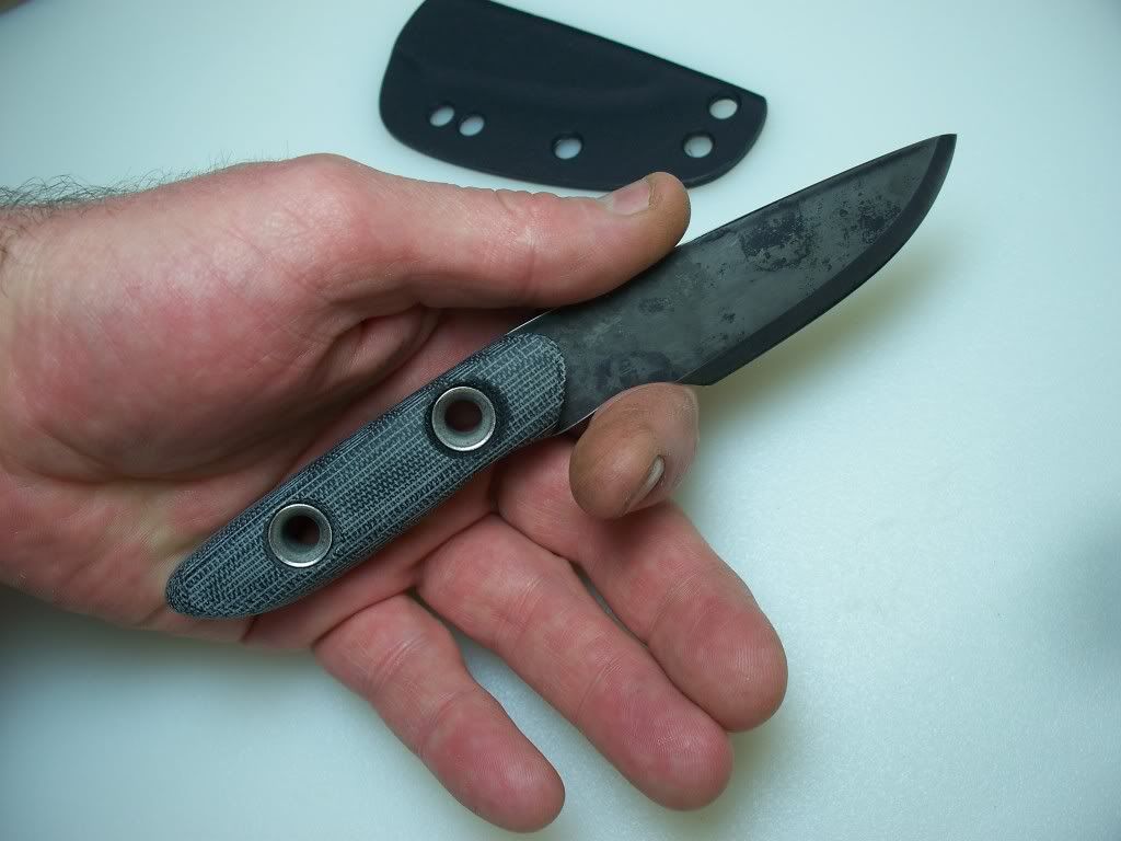

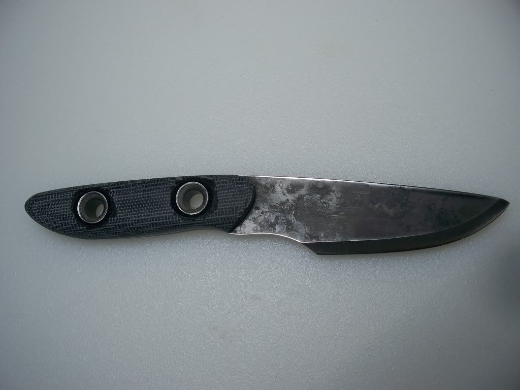

Big respect to Murray Carter for the inspiration for this one. Mine is a lot different but I thought Murray deserves some credit on this one. I have been reading his new book on bladesmithing, great reading material for the master or student.

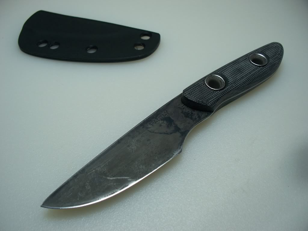

Black Canvas Micarta - 5/16" stainless hardware

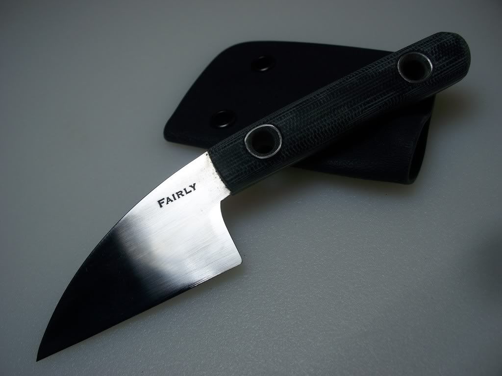

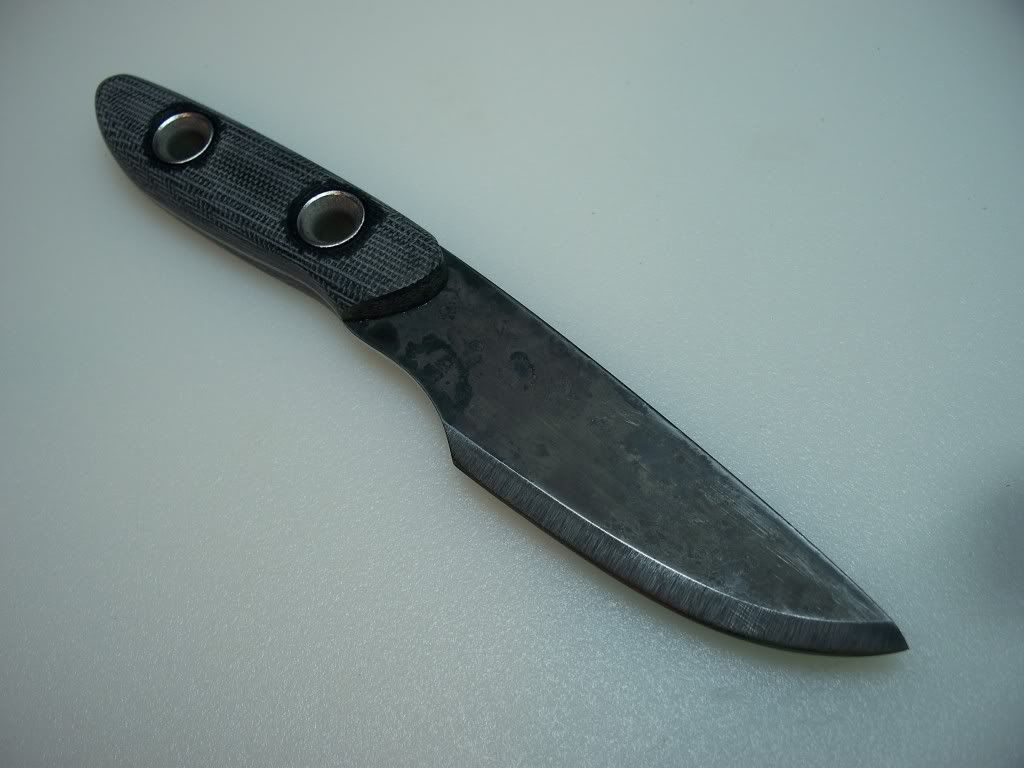

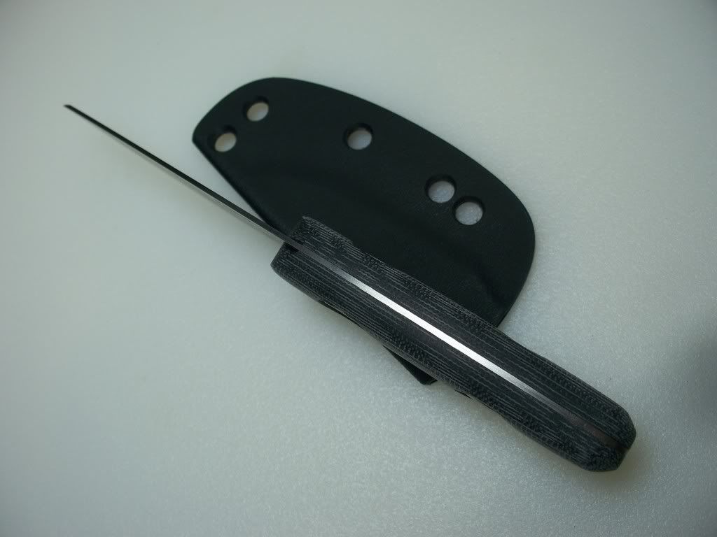

This one has a great grind for bushcraft, carving, general utility use, etc... very versatile, thin and tough. The grind is a scandi chisel grind with a small microbevel on both sides for ease of sharpening and ambidextrous use.
It's very light with an ergonomic handle, carry it everywhere! It is great as a necker, pocket or belt knife. Forge finish for durability... user finish on the blade but lots of hand finishing time in the scales so they are very comfortable and well finished.
The sheath still needs hardware, I can also install a teklok for $10. I have hardware ready to go.
6.5" long - 2.5" of blade - ultralight and super tough! $100 with sheath plus $8 for usps priority shipping in the US (or actual shipping cost for international)

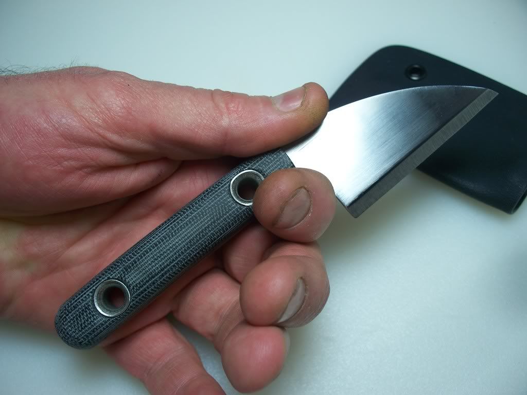

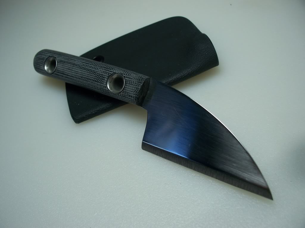

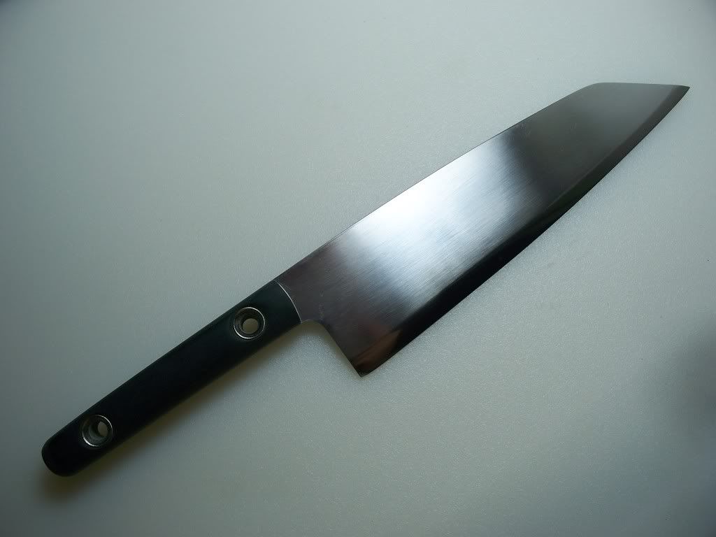

Kitchen Utility!
I made this one for slicing small veggies but it can also be used for detail work and cleaning meats.
I used to be a chef and I have to say, I'm keeping the next one of these! It works even better than expected with great leverage and a handy tip. It is a real extension of the hand. The Japanese (Wa) inspired handle is comfortable and versatile. This one also has a very small microbevel for ease of sharpening and yes, it's sharp! :D
I missed some black compound near the scales, that will wipe right off... oops!

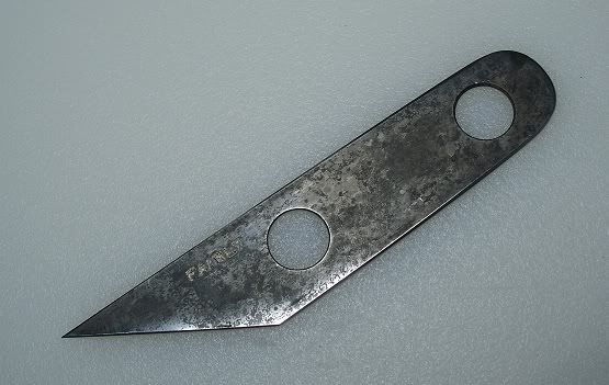

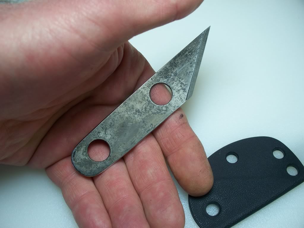

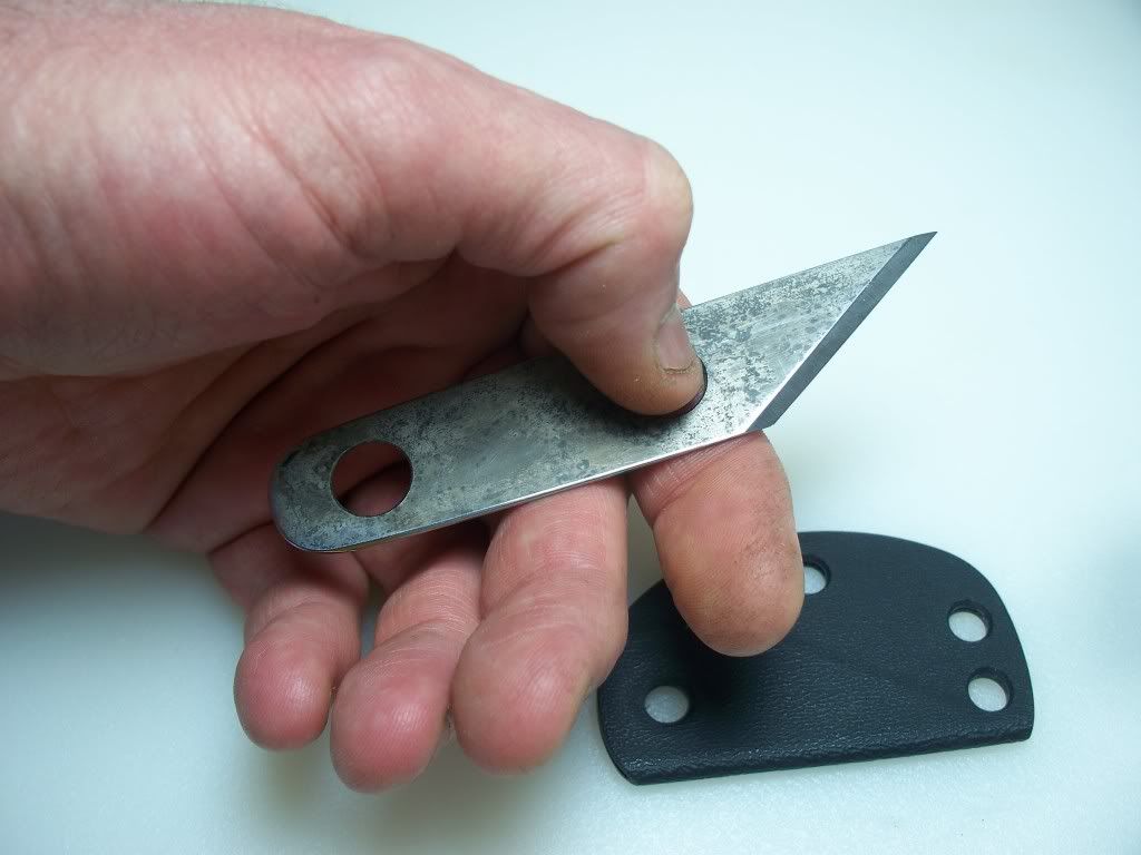

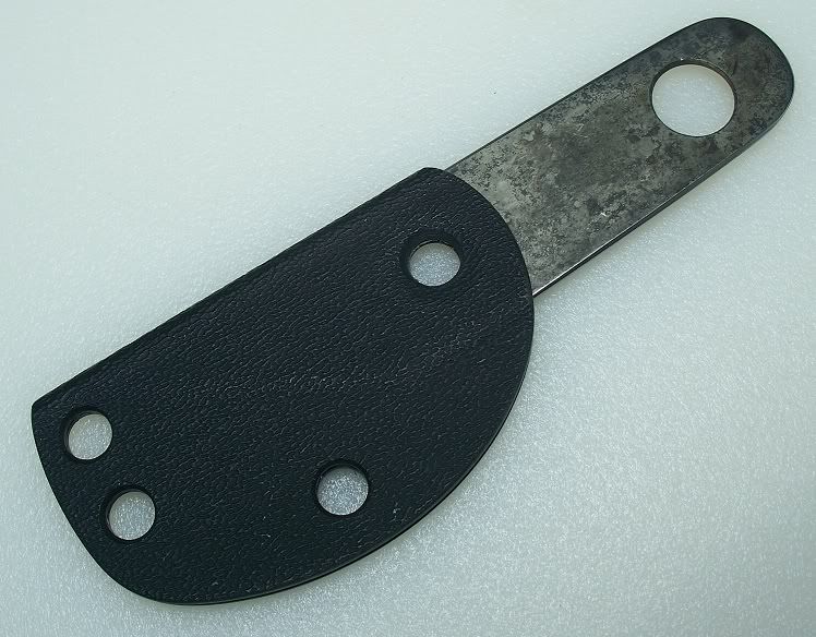

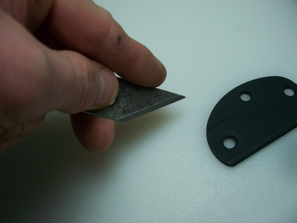

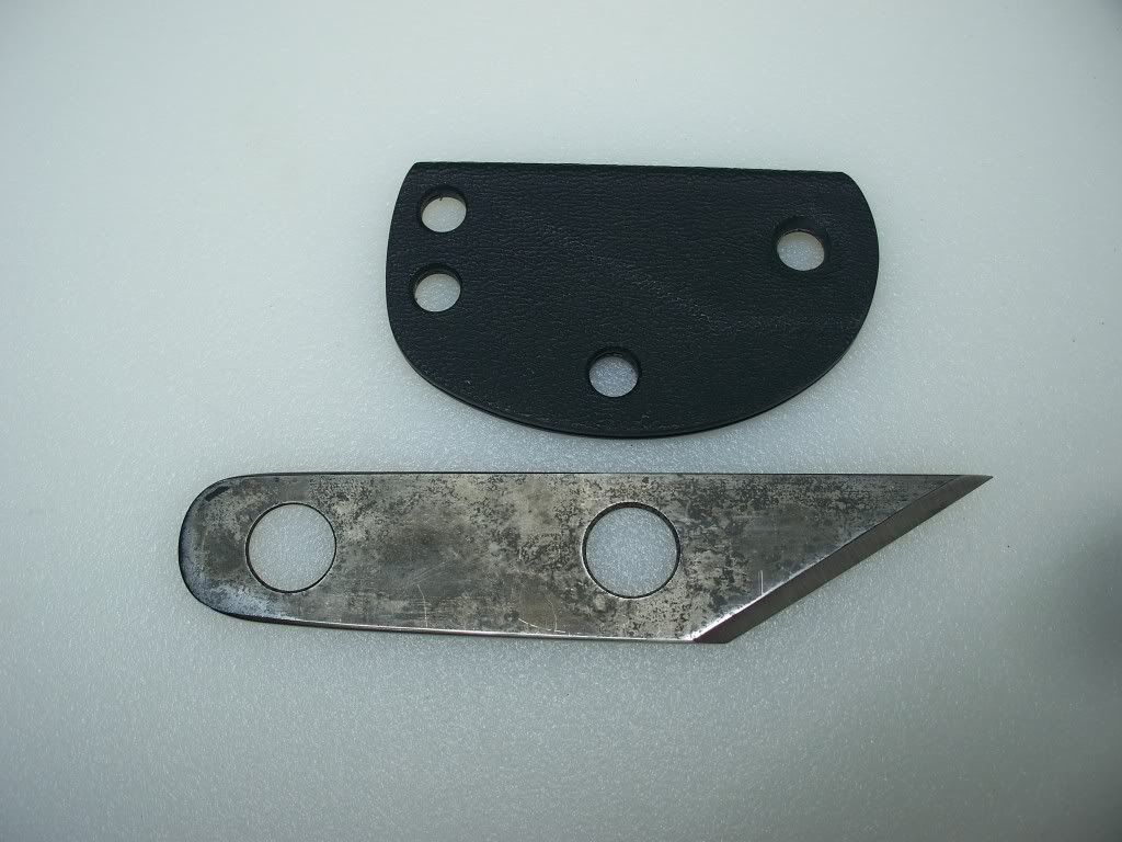

Kiridashi - This is the new ultralight design that I am currently making more of along with my bigger ones. Check the kiridashi thread for the new batch, they are just started. I'll have them available for about $40 when finished.
It only weighs about 3/4 ounce!
It's 4" long and super thin with a chisel grind and an easy to sharpen microbevel on the back of the main grind. The hole in the front serves for grip, indexing and sheath retention while also lightening the weight a bit. It could also be lashed to a stick because of the two holes. They are also great for daily use, cutting cord, opening boxes, etc.
This is made to be stashed in your bug out bag, survival kit, worn as a necker or in the pocket. As a necker is isn't even noticeable. :cool:

Ok, I like it! Multiple indexing too... :cool:
