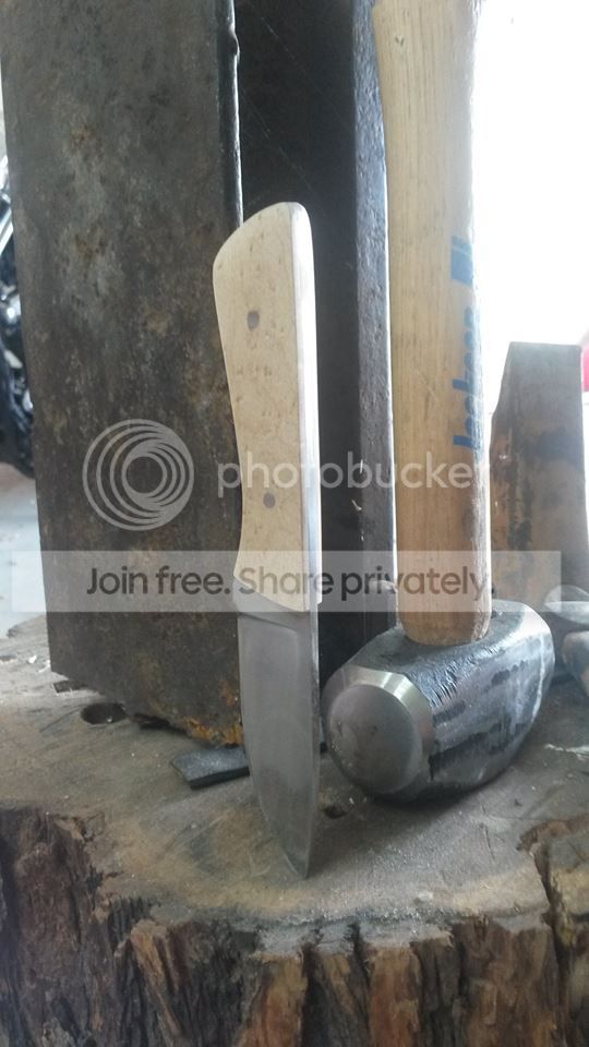

Has anyone used 15n20 solely by itself for a blade? I have 4' of 1" wide 15n20 from Aldo that I want to use to make 6 small fixed blade belt knives for a friends groomsmen in his wedding. The pieces will be small sub 6" hunters.

I have a custom forged machete type blade from 15n20... it is a machine :)
^^^^ I Like the thin handle and overall design, 15n20 treated correctly will give you a very nice knife.
Thank You. I made 6 of them. 4 for the groomsmen, 1 for grooms Dad, and 1 for his Grandfather. People cried. It was great.
