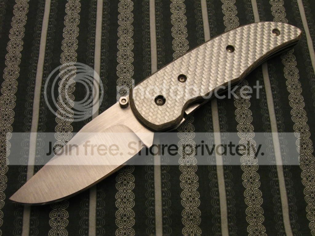

I built a quick liner lock for a friend's b-day a couple years ago, had no Ti on hand so I used bandsaw blade for the liners and clip, and W1 for the blade. It worked fine, I drilled everything and bent it without annealing first, although I broke the first clip when bending. Bimetal blades to cut it, HSS taps, and cobalt drill bits, worked well enough.
Might I add though, if you shop at Alpha Knife supply, you can usually easily find a piece of 6Al4V Ti just the right size for two liners, or four if you mess them up, for $15-25, in .060" thick or so, with enough left for a clip.
That's not too expensive to start out with, and will be easier to work with than spring tempered 15n20 IMO.
You can get a nice pivot from them too- I use them and they are my favorite.
You can buy small pieces of titanium from Alpha Knife Supply. It isn't all that expensive when you look at one folder. Frank
Salem - I wish my "quick" worked looked half as good as that. That thing it a beauty. Thanks for the info Ill keep all of that in mind while I browse Alpha.
