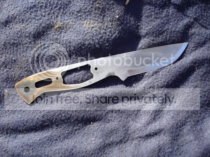

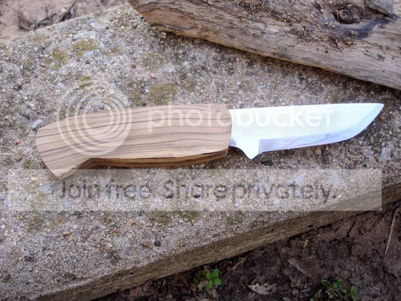

Back to the topic, this little blade was made with 15N20. I've really enjoyed using the steel. I'll put start a new thread with pictures open for full out critique once the scales are attached and it's finished.
Walter
