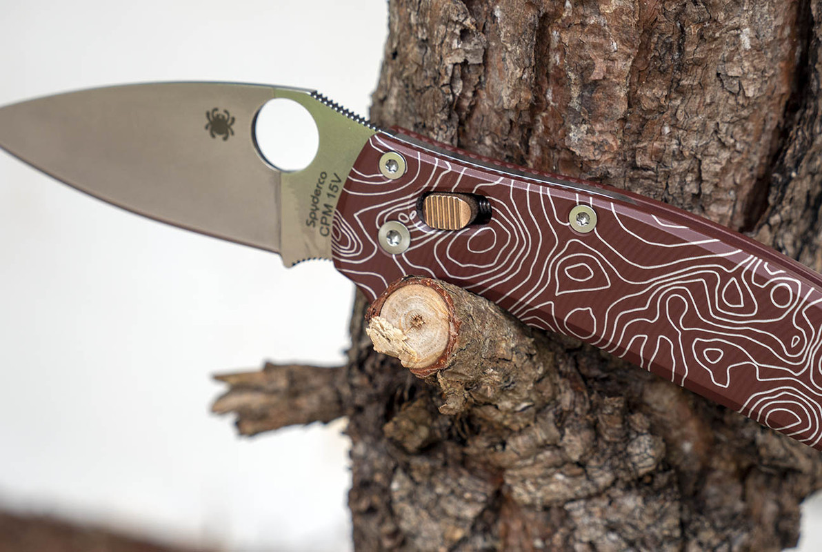

Three or four weeks ago I posted about how impressed I was by the edge retention of s110v, and specifically a Manix 2 LW in that steel. Since then I managed to purchase a Manix 2 in 15v. I didn't want to go *right* out and possibly ruin the blade, so I waited a few weeks to run the same test--carving through a 5/8" Dade Pine branch--to see how it would compare.
As with the s110v knife, this Manix was wearing a 15 dps edge that I put on using a Tormek T-8 and CBN wheels. Prior to the branch hacking it had a BESS score of 90g, which falls between a new, double-edge razor (50g) and a new, utility razor blade (150-200g).
So I cut the branch off the tree, basically by carving a notch into it, which involved a fair amount of twisting the blade into the hard wood. After cleaning the blade with mineral spirits, I checked the edge. I could detect no chips whatsoever. The BESS reading, with no stropping, was 107g (average of one reading in two different spots). In other words, cutting a 5/8" hard wood branch in half had almost no effect on the sharpness of the blade. Amazing!
After testing I stropped on leather with .5 micron diamond compound. That had absolutely no effect either. :-) Subsequently, I stropped on leather belts using a Worksharp Ken Onion with 2 micron diamonds (2 passes) and with Tormek compound (2 passes) and the knife was back to 90g on the BESS tester.

Ain't those AWT scales NICE!!!! I wish they'd do Ti. I got the topical map on my first order because I thought it would add grip, it does not. I'd love to see better grooves milled, even though I have no issue with grip.
I had a good reasons to not get the 15V when it was available. Now I have good reasons to get it, but it's not available. : (
I do like the AWT scales. Aluminum doesn't bother me as a rule, but the coating is starting to wear around the lock button thanks to my hyper-abrasive thumbs.
