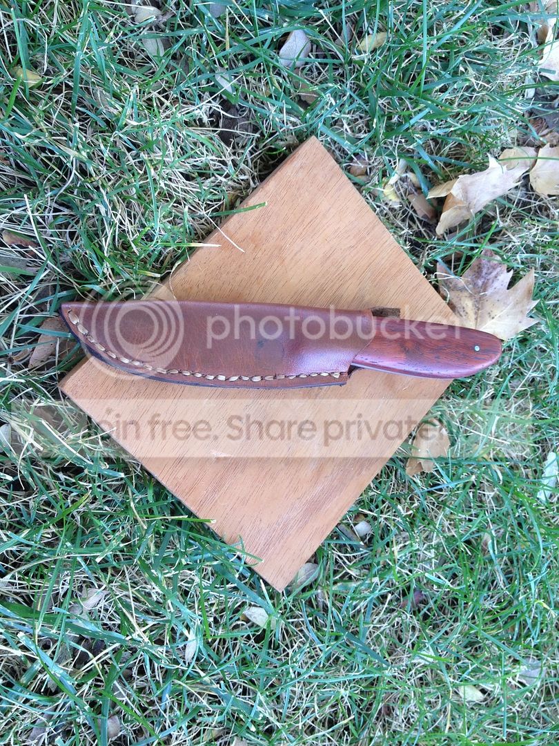

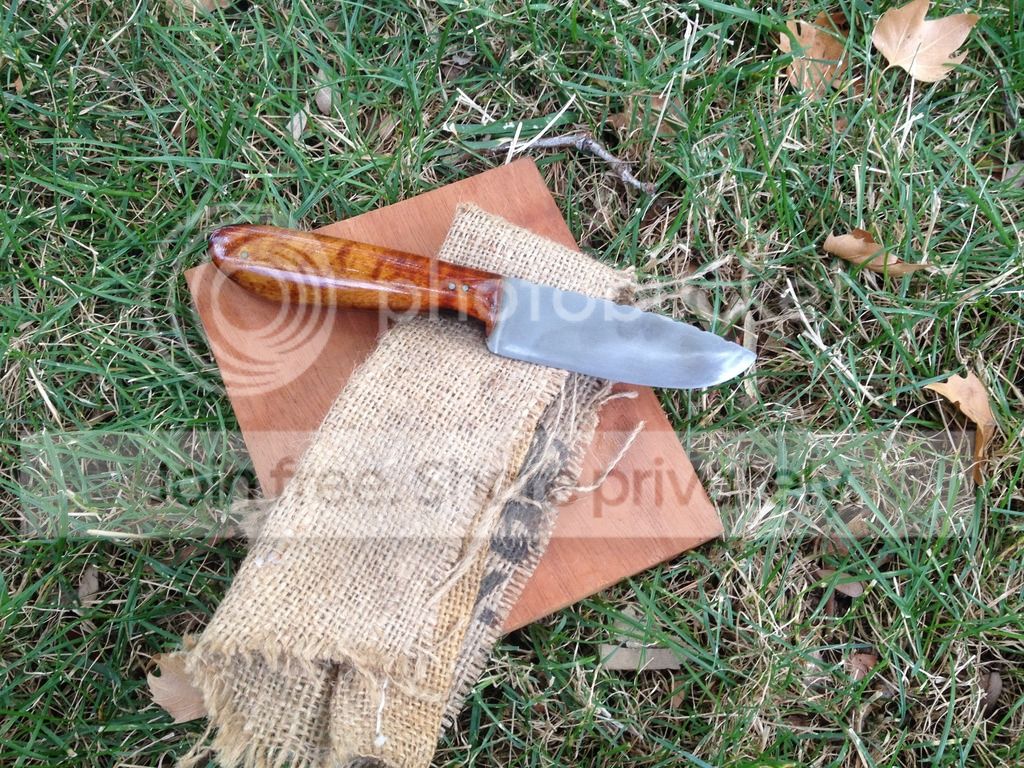

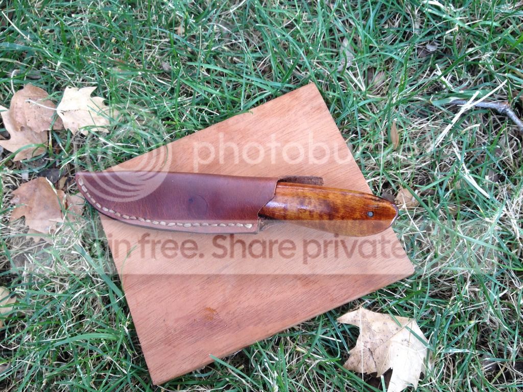

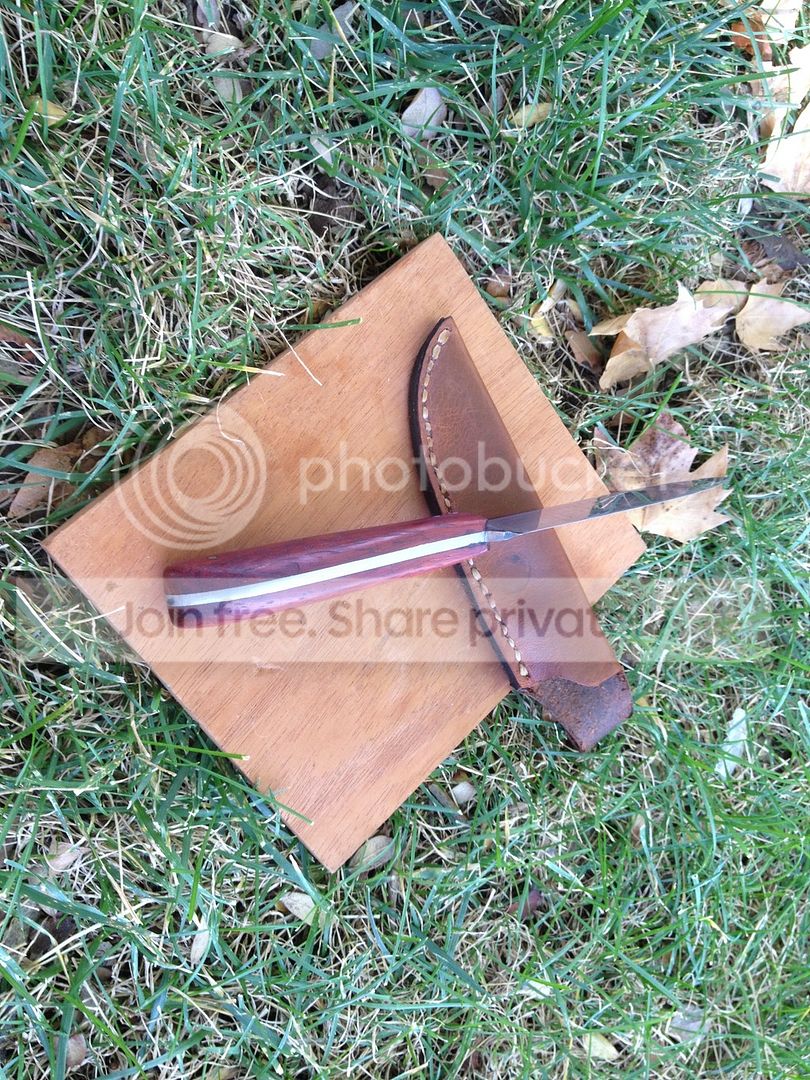

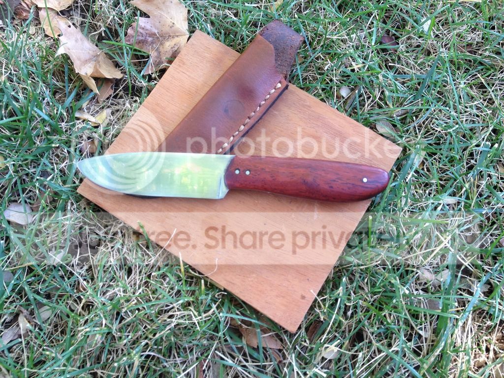

`Hey all! Here are two 1084 Hunter/ Skinners I recently made. The first has cocobla scales and is fully polished to 1500 grit. It is a fantastic cutter and Ive been very happy with it! The second is a blade I made awhile ago and just got back to, I etched the blade with hydrochloric acid and used curly maple for the scales. The fit of this knife is very comfortable; I like this one a lot! What do ya’ll think? Im going to start doing makers marks soon, I just cant figure out what I want mine to be

Ok. How does it not match my style? And purely out of curiosity, what is my style in your eyes? Thank you!
Well, you've mentioned reenactments, and your knives being a hit there if I'm not mistaken. Your "style" I would say is a functional working knife, along the purpose of say a "Kephart". The file work to me at least, draws away from that simplicity. But my brain work in crazy ways!
I think what he's saying is "lessismore":D
What I see as the style of the knife is a simple re-enactor style knife. What I see that isn't in that style is the filework down the handle scales on the second one in the photos.
There are a couple other things that immediately catch the eye. The handle butt, pin placement, and the little tit of wood going down the ricasso on the second one.
Handle shape at butt - the squared off end will be very "hot in the hand". That means that it will rub you and be uncomfortable to use. A slight rounding of those 90° corners will help this.
Pin placement - the pins are too far apart and too close to the ends. Either add a center pin, or move the pins in a bit. I don't understand the double pin in the front, either.
Little tit of wood - that thin piece of wood is going to break off in a heartbeat if the knife gets used. The first time it gets bumped in a cut or in use it will pop off. The front of the handle should round back into the handle bottom, not follow the ricasso on down. I would pop them off with a sharp knife and carefully round them over now......or you may want to just remember that for the next ones.
