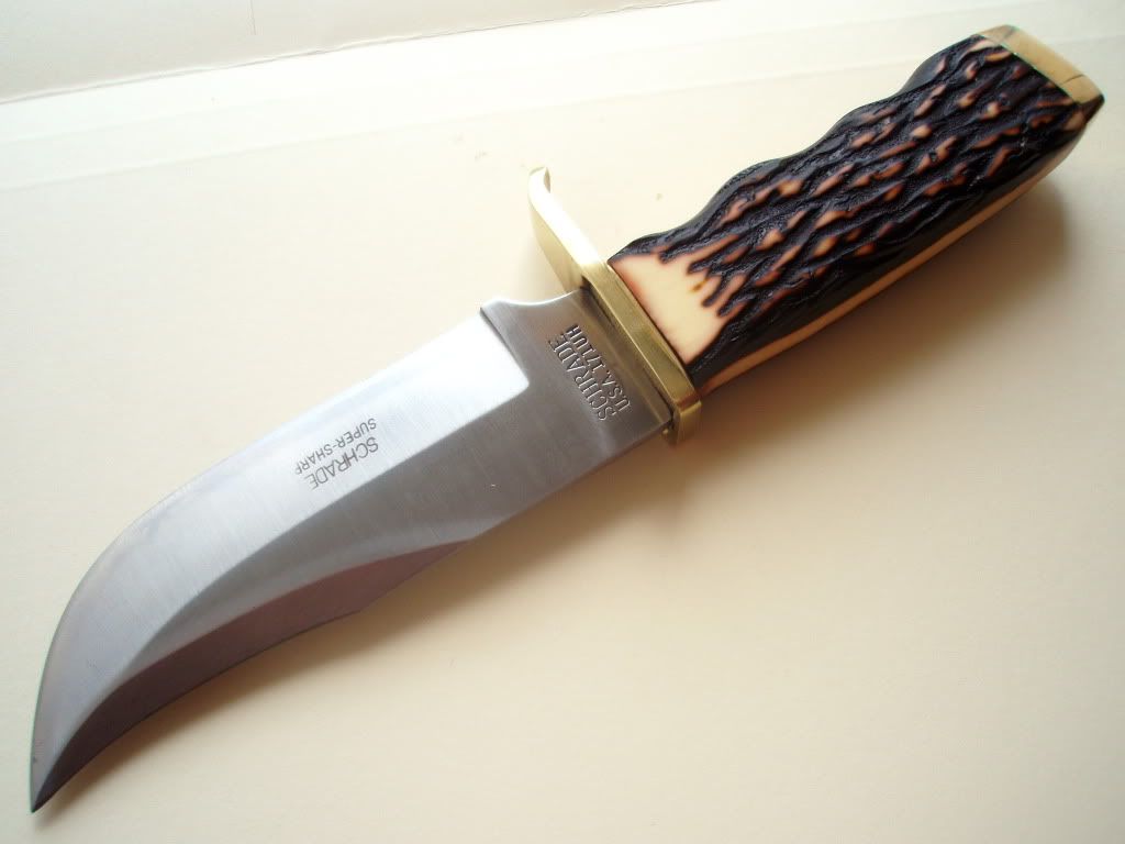

have only seen one type of handle until today when did they change the handle shape? i love the variations that pop up now and then.

I can't answer your question, just wanted to say the handle on my 171UH looks like that, and I don't recall ever seeing a different one. It will be interesting to see what people have to say. As usual with Schrade, you never know what you might see next!
i only slightly remember that and couldn't figure out how to search. thanks for the info.
