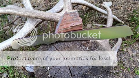

Here is one of my Goloks in .25" CPM 3V, 18" OAL, 11" Blade, 7" handle with double finger choil. the double finger choil gives the Golok an effective double grip option. This piece may be sold but hasn't yet. I'll toss up pics of the entire process. Email if interested at ce_cody@yahoo.com. I have had several people try to follow the email link here on the site and they don't arrive for some reason, so go through your normal email provider.

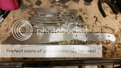

After being cut and shaped, but before pregrind and heat treat.

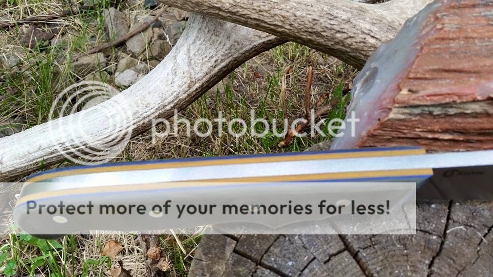

Basic grind finished but before logo etching and handling.

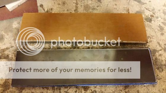

Handle slabs built up for brown and green micarta with a blue liner between.

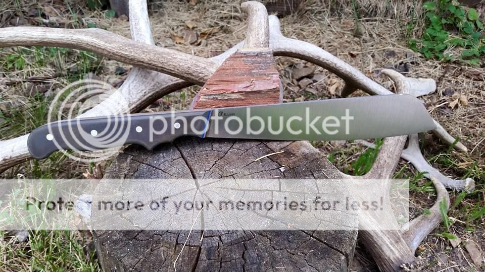

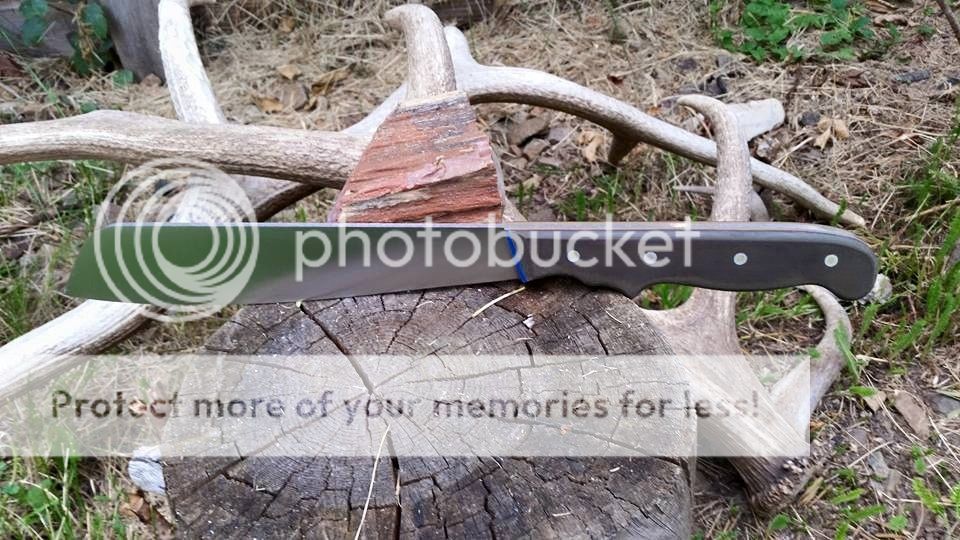

All finished up.
With a full height flat grind and a convex edge this zombie killing beast is hard to beat.
