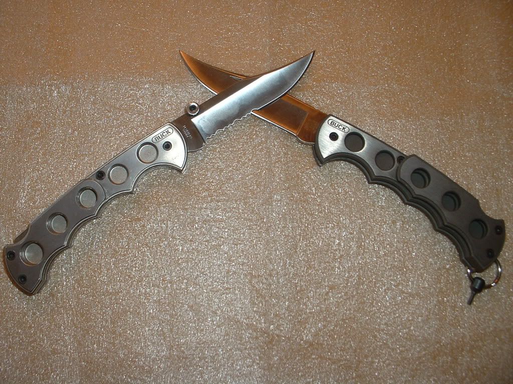

I carry one of these every day. It's a reverse clip custom made by Rick MacDonald PHROBIS Master Machiest.... I was lucky enough to have a BG-42 1/2 serrated in it. I use it for everything...
COMPARISON to normal 186
I've pretty much thought those style thumb studs look like a gaudy wart on the blade . Bought some tried them and quickly removed them . Your taste my vary . DM
I've never held a 186 but a regular 110 doesn't even need a thumbstud to open one-handed...I just hold the blade and flick out the handle part. I assume it would probably work with a titanium handle even though it's lighter.
The thumb stud eliminates the need to regrasp the knife that arises when using the handle drop (shake down) method of opening. Question on the reverse clip: do you carry the knife in your right front pocket or outside your belt on the left side of your torso?
I will take my wider than factory thumb stud (PHROBIS made) any day over a 110,560 or 186 without one.:rolleyes:
