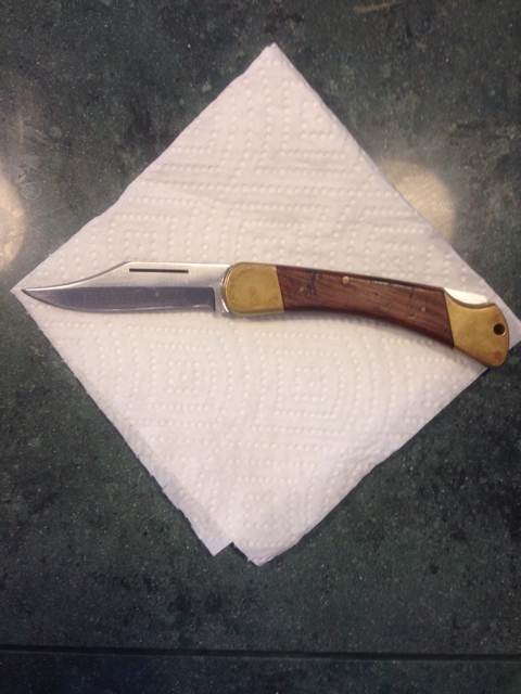

Short back story:
My dad recently passed along this old Puma. I thought about cleaning it up to sell, then changed my mind on the selling part. My dad's mind is slowly giving way to dementia, and this knife is part of a very limited amount of hunting we did together. So it has much more sentimental value than any cash could cover.
This was the first knife that made me want a better knife. I shot a couple of does one morning we hunted together. After complaining about the amount of work we had in front of us, my dad used this knife for the processing and skinning chores. It held an edge remarkably well while I fumbled around with my clunky, dull, cheap knife.
It was fairly corroded when I received it. I didn't have any brass polish on hand, so I looked up a DIY recipe that worked well, at least for removing the tarnish.
The spring inside the handle is pretty rusty. I dropped some oil on it. Should I bother attempting to disassemble and clean the rust off the spring? I haven't taken apart a pinned knife before, so I'm not familiar with the ins and outs of that. The action is a little rough but passable.
Some other initial impressions: this thing is heavy! Brass, metal and wood...what a concept! It's really something to handle an older piece after getting into all the modern stuff.
The blade gets screaming sharp. And I like a good clip point. It's really a sweet knife.

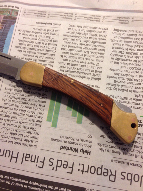

Only took a couple shots of the initial cleanup:
You did a nice job giving it a mild cleanup, while still leaving some character.
I've had good luck with dripping some 3 in 1 oil into the blade well, letting it sit for awhile, dipping the tip of a toothpick in Flitz and scrapping around inside the knife. I then use Wd-40 with the red tube on the nozzle to spray out the well and finally compressed air to clean out any remaining residue.
I suspect that if you can get that joint cleaned out, you will find that it's like ball-bearings. The old Pumas were really, really sweet knives.
I have had success doing things like Last Rodeo recommends, but I think I might give the whole thing a soak in mineral oil before trying the area-specific cleaning. Soaks can cause a knife to "give up" amazing amounts of crud and would probably do a nice job reconstituting the slightly shrunken wood. Nevrdull wadding polish is great for brass (and nickel) and I'm not sure I would have any qualms about shining it all the way up as long as you aren't using buffing wheels. Heck, Brasso would be fine, too, most likely although it has a bit of grit, too.

Great story, thanks for sharing with us. I think that that knife looks great in the second picture, I personally wouldn't do much more to it as far as polishing. The mineral oil soak is a good suggestion. If you don't want to soak the whole knife I've had good luck with filling the blade well and letting it drain between the liner and springs and repeating. It's amazing how dirty that stuff will be when it comes out. Then I'll put a couple good squirts in the well, tip the joint down, and work the blade back and forth until the oil stops coming out the back. Again, it'll come out black and I keep refilling and working the blade until it starts to come out clear. At that point the knife has way too much oil everywhere to carry so I let it sit for a couple of days on a wad of paper towel and it'll just drain out. Wipe dry and you should be good to go.
I don't know if I'm just wasting my time with all of this and if I should just let all of them soak in the oil, but it's what I do. I'm sure the action will smooth out quite a bit once you get it cleaned up.

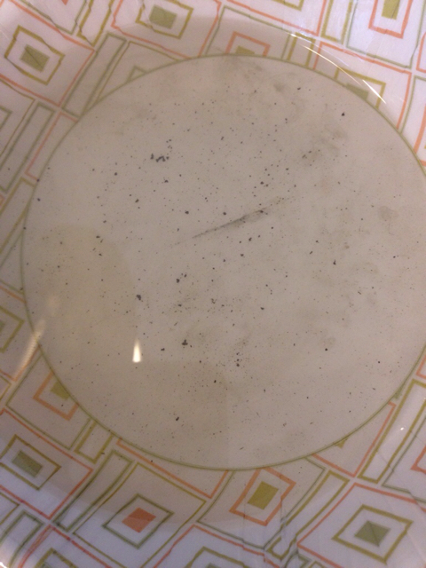

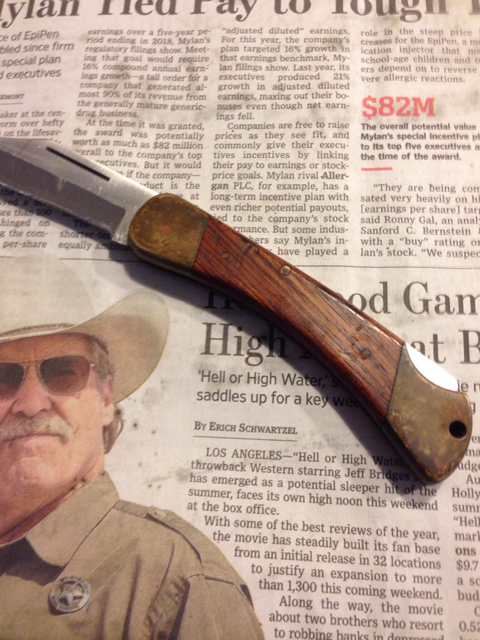

Gave her an overnight soak. I filled it repeatedly and worked the blade both before and after. This is what I got out. Mind you this is after I thought I had cleaned it previously:
The action is slightly better. It still feels like it has a rough spot though. I may carry it a bit and repeat the soak process later.
I didn't notice the wood swelling any to close the gaps.
Thanks again for all the good tips. You guys are better than google! ;)
The action may smooth with continued use. I have noticed my less used brass bolstered Buck knives getting gritty after sitting awhile. I think there may be a chemical reaction between the brass and steel parts.
