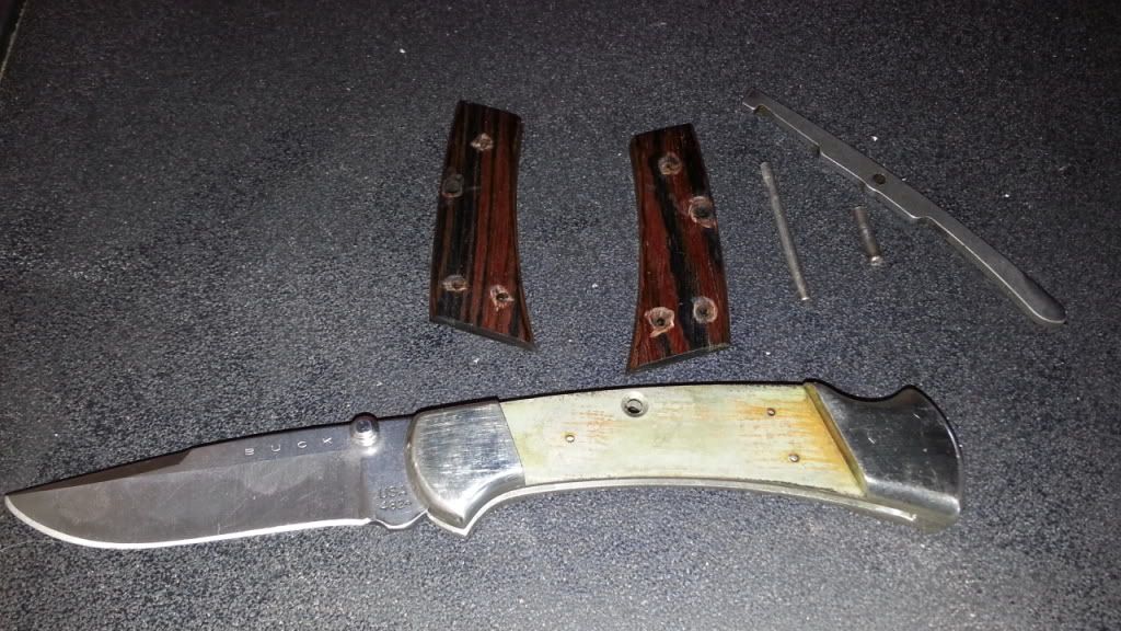

The supplies I ordered showed up a few days ago, so today I had time to play :)
Ground off the rivets
Got the scales and lockbar off

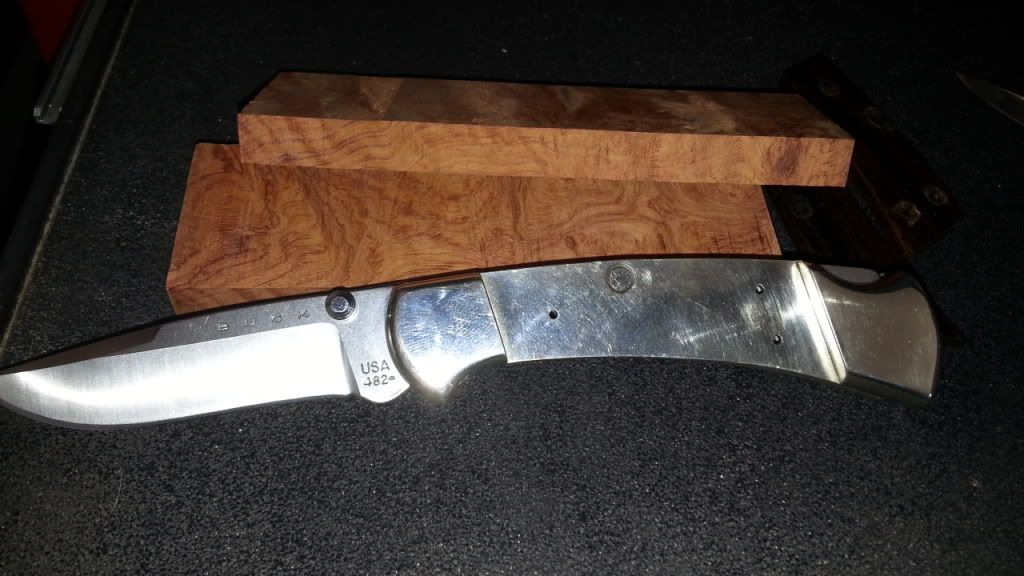

Bookmatched Amboyna Burl for the new scales

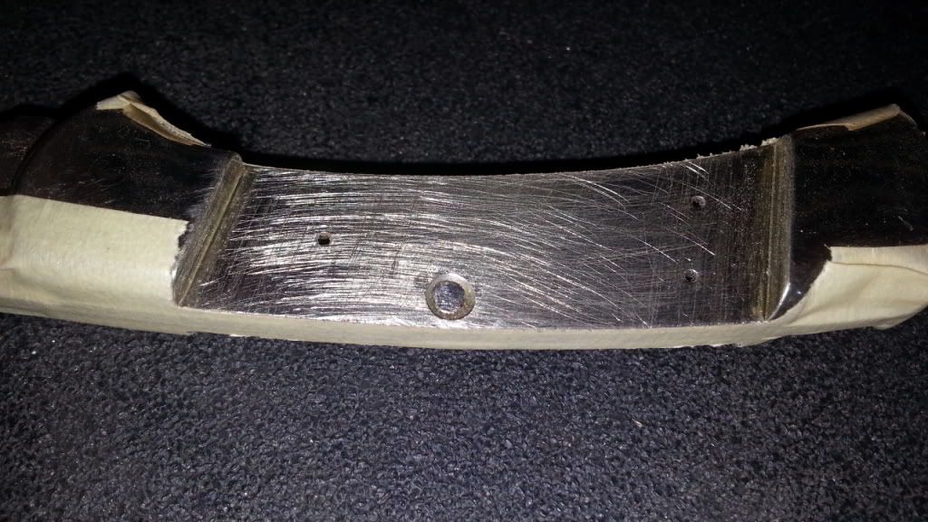

Took a few minutes to clean her up on the buffing wheel while she was "naked" ;)
Then pinned and peened in the lockbar

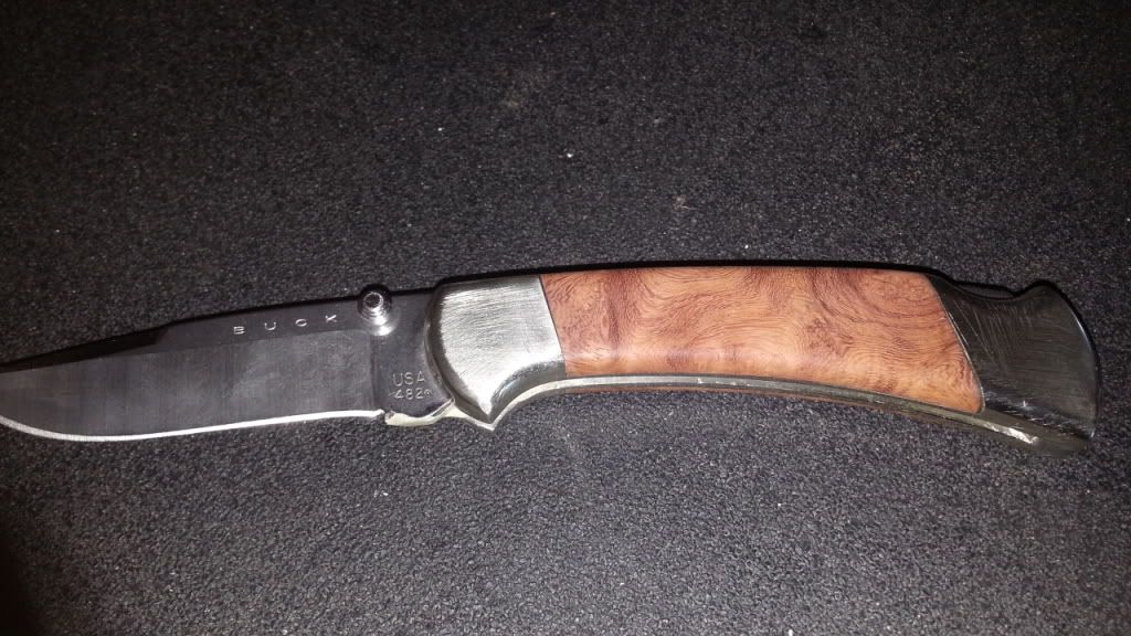

Roughed her up a bit to help the epoxy adhere better
Epoxied the new scales on her and used a vice to make sure they were all snug and secure

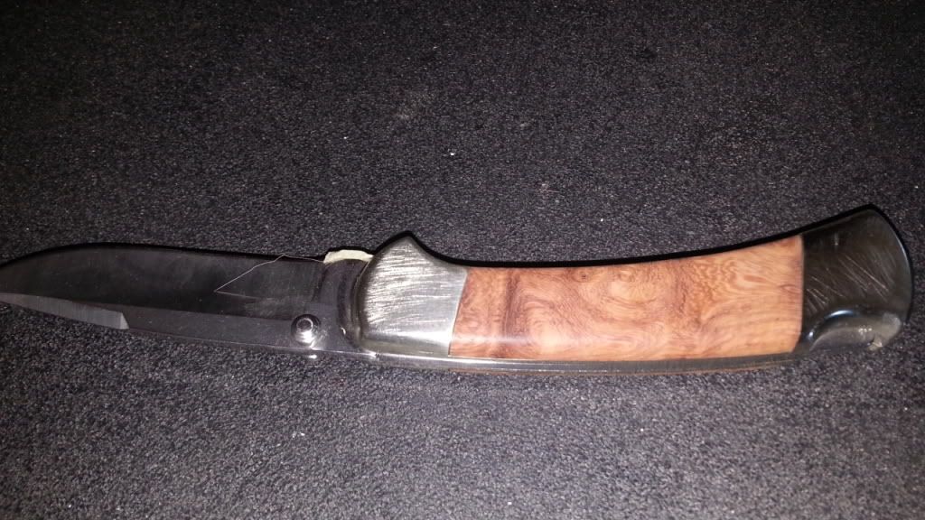

Sanded sanded sanded then steel wool....
Then a long visit with the buffing wheel with the green compound...
Gave her a good soaking/cleaning with oil, and she is now done :)
I like how she turned out!
Definately going to edc this one a lot.

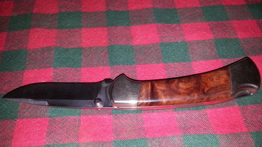

I really like this knife, and it has gotten lots of edc time.
Lately though, I have been edc'ing this other one alot....
It also has Amboyna Burl for the scales :)
