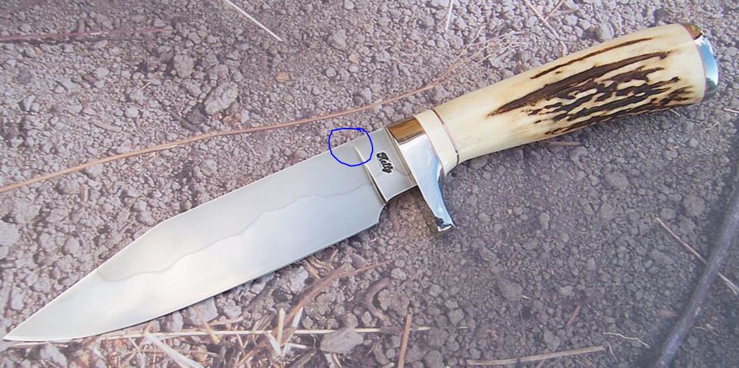

Also to piggyback on Stacys comment. You really want to avoid taking your plunge all the way up through the top of the blade and "breaking" the spine.
Note that even on this full grind there is a little tiny bit left at the top.
-edit to add this is not a knife of mine.
