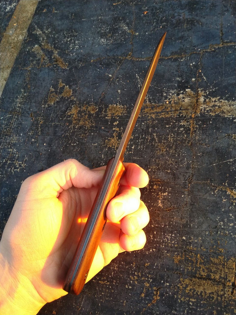

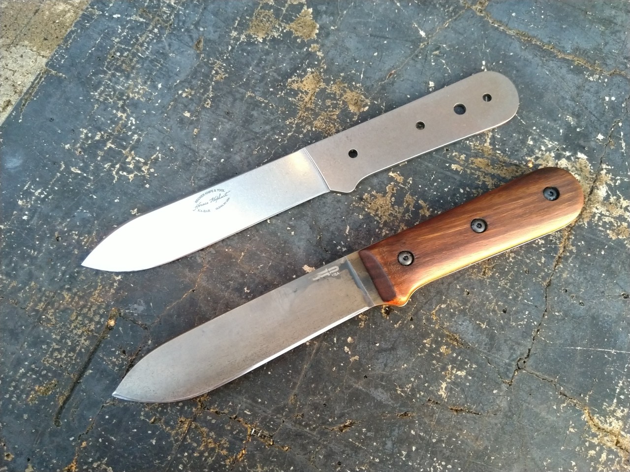

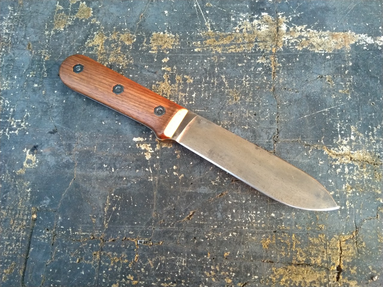

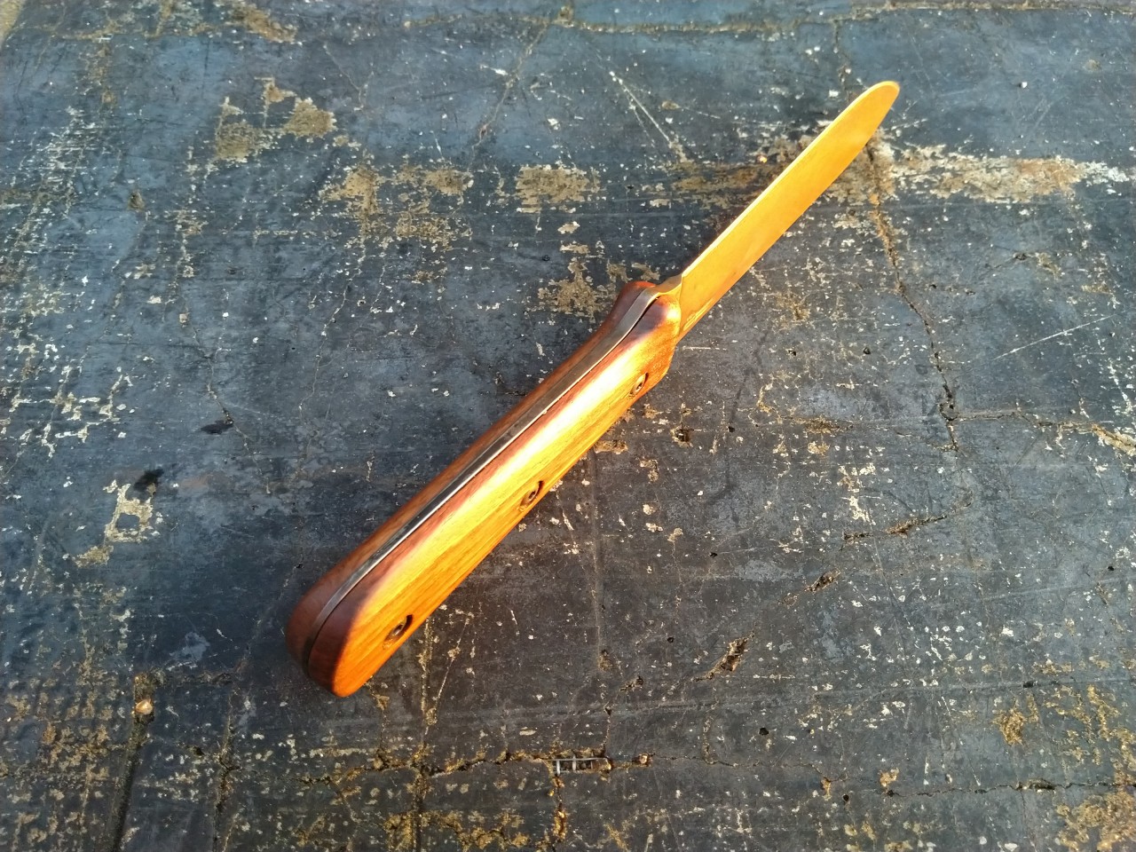

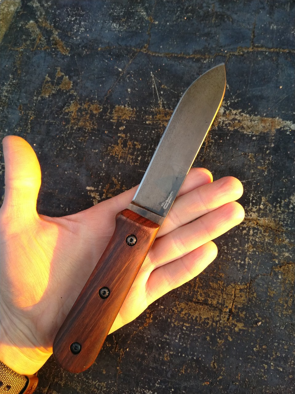

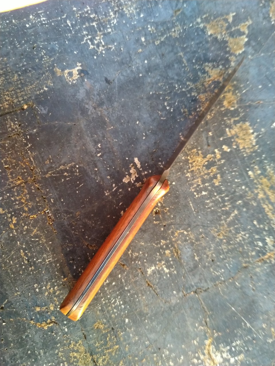

The first Au-Kephart wearing its @beckerknifeandtool #bk62 cousin's scales (pictured nekkid above!). This is 1084 at 59-60Rc, heat-treat finish, hardened 1/3 up the tang. It came out a touch thicker than the model, but same overall geometry and balance. Very pleasing heft. Possible modifications for the next version include making the handle sliiiighly less tall and reducing blade length by 0.75-1.0" for better tip access and control. 1084? A2? AEB-L?
