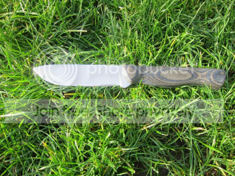

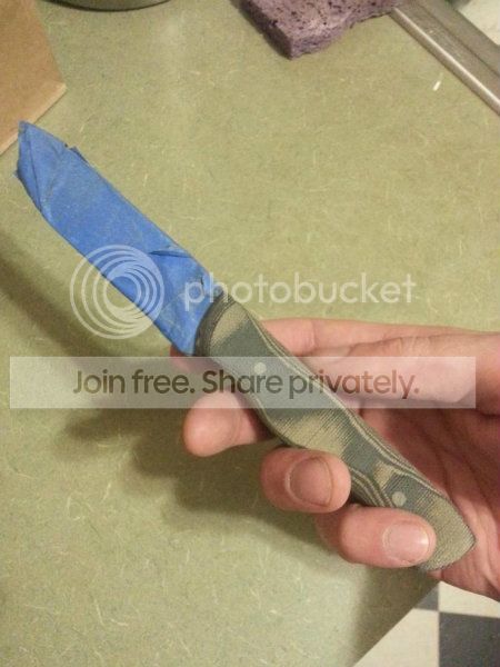

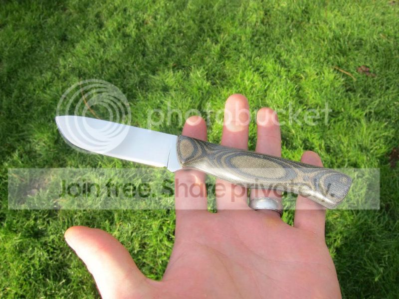

A couple of months ago I decided to tackle making my own knife, while at the same time clearing the mind a bit while grinding away metal. I read that to make a knife you simply take a piece of metal and grind away anything that doesn't look like a knife, which I found to be largely true. I've followed BladeForums for some time and picked up my first handmade custom knife last year (a folder by Ray Laconico), whose work at least partly inspired my own. This creation was also heavily inspired by Fiddleback Forge's work, who I've admired for some time.

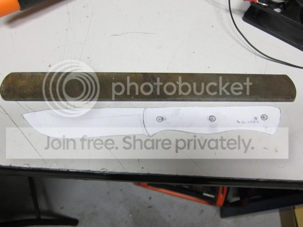

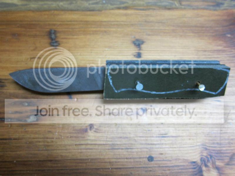

The project started as a very old rusty Nicholson file. I sketched the shape up on paper, cut and glued it to the file, and worked the overall outline down on my bench grinder, going slow to avoid excess heat. I used a 3"x21" belt sander to remove most of the file facing and start the bevel, finishing with a wood block and sandpaper.

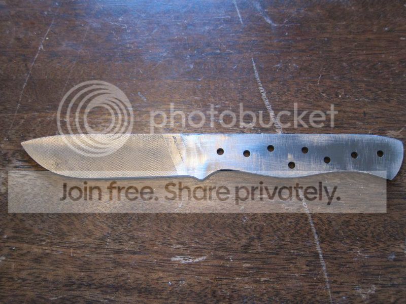

The specs on this one are: 4 ½” handle with 4” blade, drop point with full flat grind and full tapered tang. Handle is composed of a black liner on jade G-10 with black/green canvas micarta, pinned with two black micarta rods.

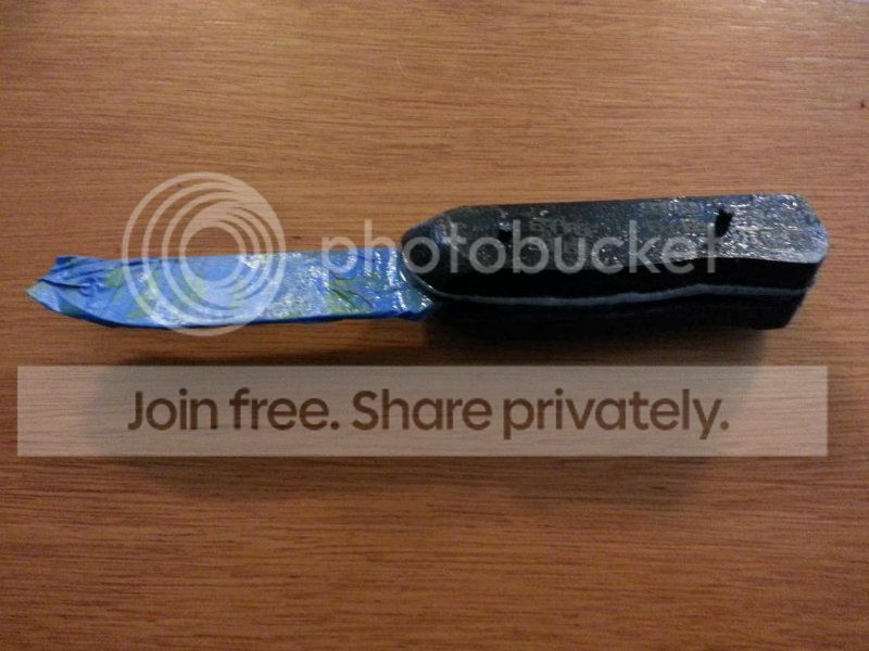

I etched my last name in using a fingernail polish mask with a regulated DC power supply/salt water/cotton ball. That's a bit tricky - room for improvement for sure, but amazingly simple and effective. The handle is epoxied up with Loctite E-20HP.
All sanding and shaping was done in the hardened sate, so required frequent dips in water and slow-going. Handle shaping was equally time-consuming for me however, having never done this I had a hard time with the three dimensional shape and had to work slow so as not to remove too much material in the wrong place.
The blade could still use some work on the final bevel to produce a perfect edge, I really struggled in setting the proper final angle and ended up a bit concave.
Thanks for taking a peak, it's been a fun project and I've already started on a second design for a hunter for my father. All feedback and advice is greatly appreciated.

Looks good. As Silver Pilate said, to get the most out of your next one you should properly heat treat it. Read the stickeys, particularly the one about working with the two steel types, you have some misinformation about heat treating that might be a good thing to replace with solid info. Your work looks clean and well done

Nice job of making that knife. Well shaped and well done.
The one major concern is that you never mentioned tempering the file down to a usable hardness. If it was left as it was, the blade will be way too hard. It will chip on the edge, and may break in half in use. You should have baked the file in the oven for two hours at 400F, cooled it off in water, and then repeated the baking.
Also got one going on with a lawn-mower blade. My grandpa made a knife out of a file though (Never got to finish it) But he took the temper out of it by baking it in a batch of cornbread, and letting it set over night. Ive heard that to put a good temper back in it, you should heat it cherry red, and submerge it in used motor oil. Adds carbon.
The quoted info above is completely to be ignored by any readers. While Grandpa's stories are good memories, they are bad knife making advice.
Raccoon,
First, lawn mower blades make a poor knife. Not enough carbon, and designed to be tough, not hard. They are alloyed to bend, not break.
Second, a 325 bake in the oven will not drop the hardness of a file sufficiently. A bake of two hours (twice) is needed to drop the hardness to a usable level.
Heating a blade red-hot and dipping in used motor oil would be a rather iffy hardening ( not tempering) attempt. It would make a piece of knife steel somewhat harder, but if done to a file, it would greatly soften it. It would add no carbon that was detectable in the finished blade.

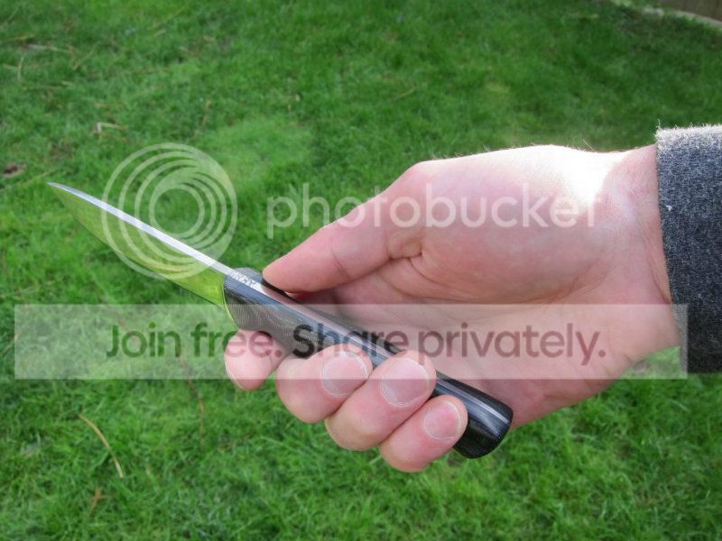

Very kind of you Nathan. I've always felt like if something's worth doing, it's worth taking the time to do right. If I was a garbage man I'd damn well give it 110%. I hadn't noticed my omission of the slight rear teardrop and may very well have to go back for some subtle shaping (this will be round 4 on the handle, after I thought I was done). I appreciate you picking up on this subtle detail.
The blade cuts well and has not shown signs of chipping yet, having only been completed a day or two I've only used it to cut a few straps/tape and open a few dozen large boxes around the shop.

To be perfectly clear (for file blades 2 and 3 before moving to Aldo’s or similar known steel): I should preheat the oven to 400F and set the file on the rack for two hours, cool in water, and repeat. This will leave the file in a slightly softened state, but still hardened, for final use. Please confirm and I’ll get to tempering this second round.

You can temper the blade as you suggested before putting the handle on. If you still notice chipping with testing, you can raise the temperature by 25-50F and do it again. The exact temperature for proper temper depends on both the steel and the intended use. Known steel is always a great way to go as you can send it out for heat treatment and get it tested to verify hardness.

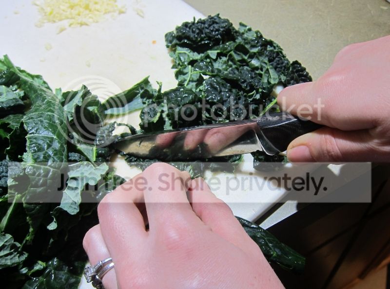

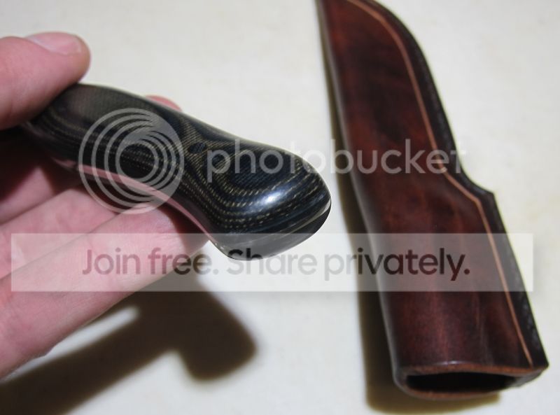

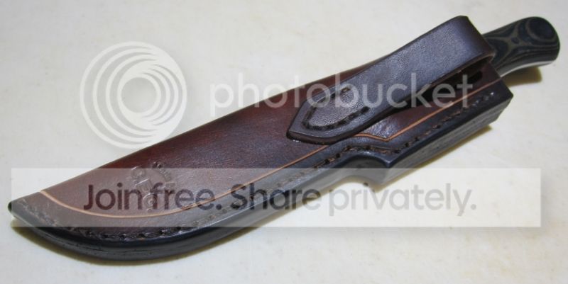

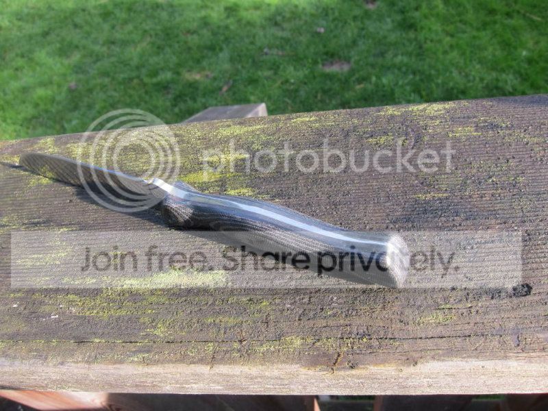

As a small update, I sent my knife away to Richard J to put on a final edge. He did fantastic work on this knife as well as a few other blades – highly recommended!
I also took the time to have a nearby sheathmaker, Chuck Geyer, help in setting me up with a terrific piece of leatherwork.
Here are a few photos of the finished products, including one of the wife performing some light dinner chopping:
A keen eye will note the reworked and more “teardropped” end. I’m learning :o.
