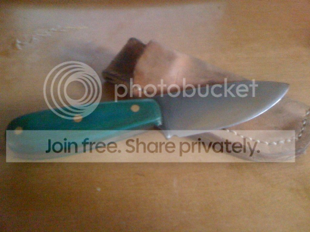

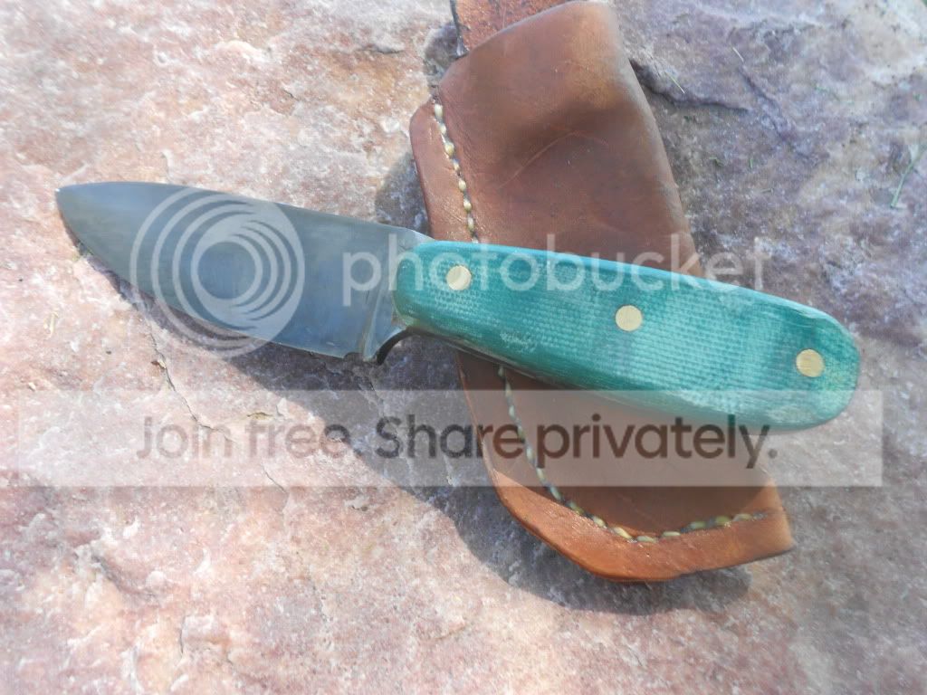

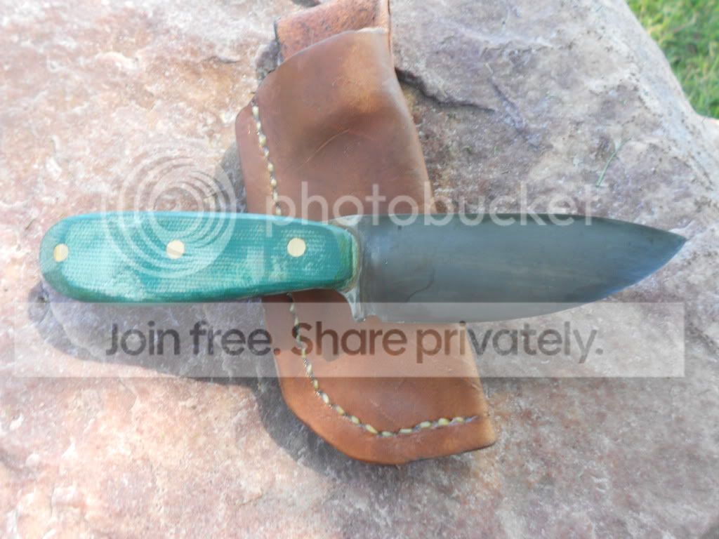

Here is the latest progress on my knife. It is 1/4 1084 aldo. I have learned a lot but am pretty happy with it. What can I do to make the scales a bit darker. I dont like the color. When I got the micarta slabs it was a much darker green.

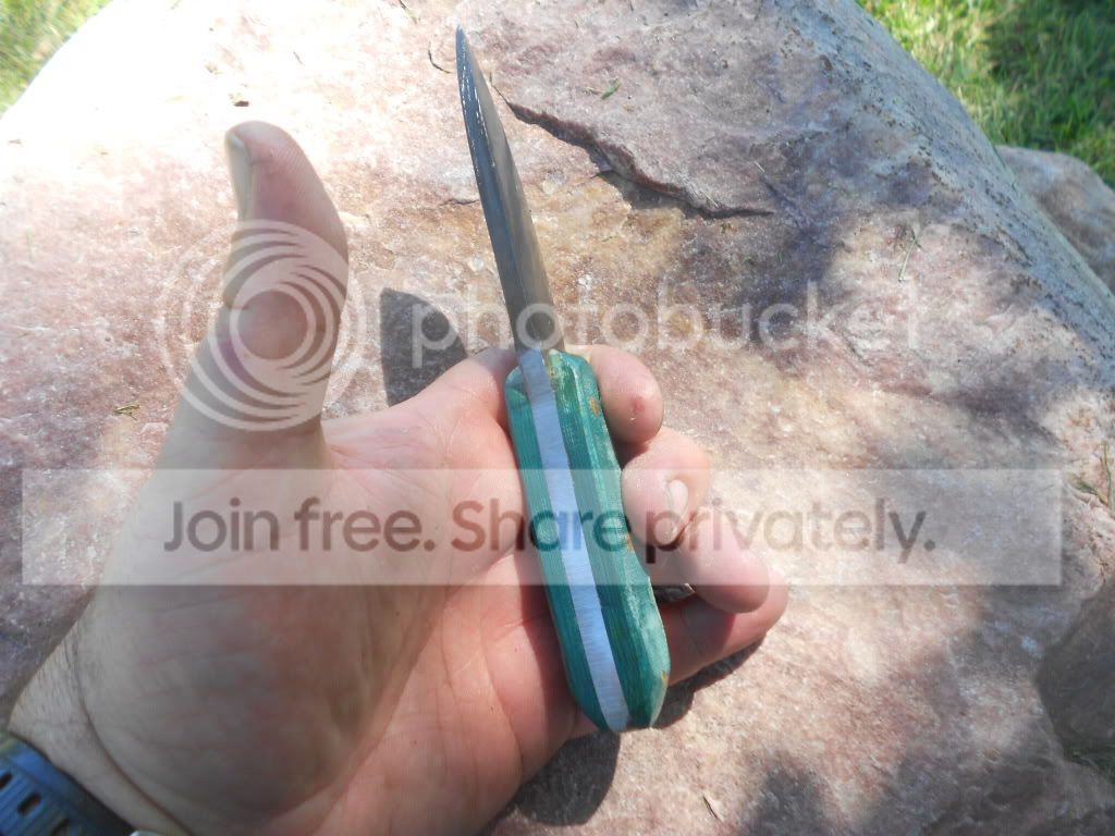

I struggled with shaping the handle and its not as symmetrical as I would like, but it does feel good in my hand.
The finish I sanded to 1000 and then did a hot vinegar patina I think I will do that again to try and get it a bit more even.
I heat treated it myself, but on my next knife I am going to use thinner stock and O1 and send it out to be treated. I put too much work into this knife to be wondering how my heat treat turned out.

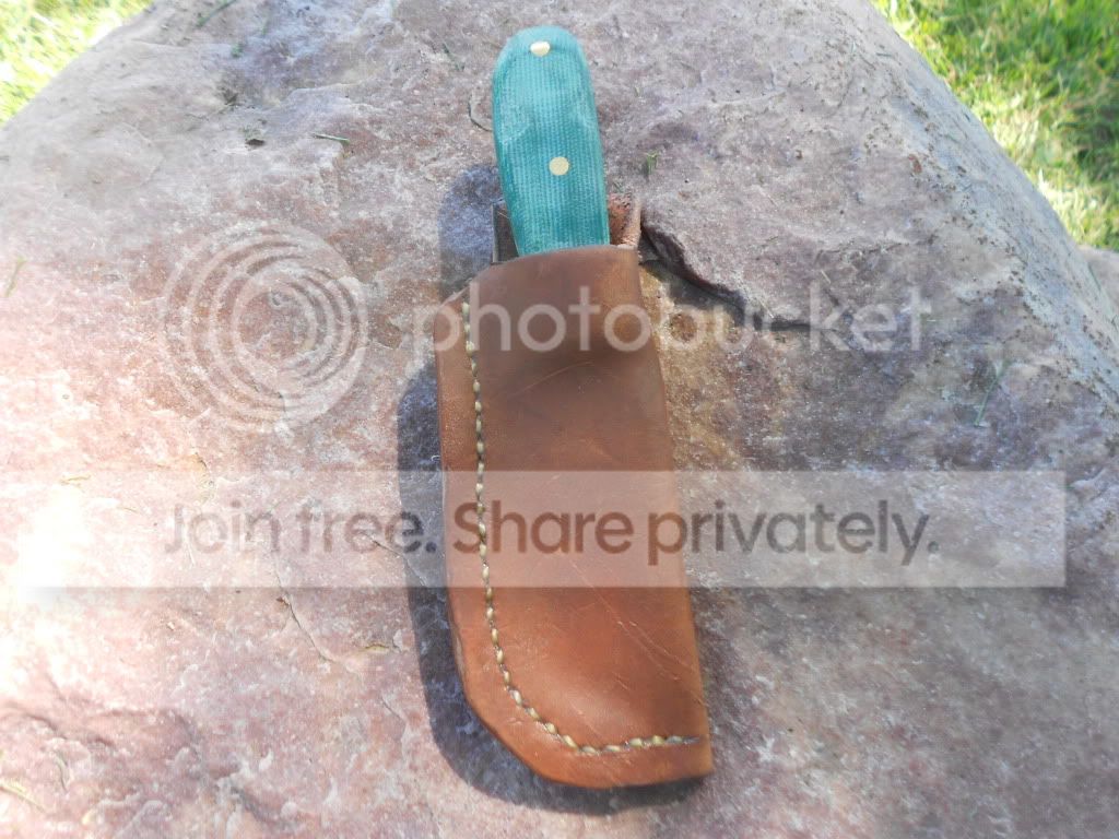

The sheath I made as well. Its about my 5th attempt Im getting better with each one and I hope the same will be true for my knives.

Hey psyop! Good to see it close to done. I assume the scales where polished on the outside when you got them. A lot of mircarta doesn't show its true color until its buffed or polished. Try that, it should darken to its original color.
Hey, good one, Psy. Thick little bugger, eh?
Yeah, like Todd said, you have to sand up the micarta.
That involves bring it to an even finish all around at 180, 280, 360. At about 260 you'll probably find what you're looking for, and can continue to 600 if you want. If you've got a lot of deep marks in the handle, start sanding at about 80.
Thinner stock is easier to through-harden at home. 1084 is straightforward if you have a couple bricks to hold the heat from your torch.
Looks good so far, but you are only about half way done. If the blade is as done as you are going to take it (I suggest some nice hand sanding to even it out) then wrap it in a paper towel and wrap it again in electrical tape, clamp it in your vise and then go to work on the handle and spine. Make the sanding scratches all go the same way on the spine, then scrub that micarta until you can't see any scratches from the previous grit. This also includes "light areas" that you get on micarta from when you grind it on a grinder. I usually take micarta up to 600 grit before buffing it and it buffs out nice and even. Pick up one of Paul Long's dvds on sheathmaking in order to improve your sheaths.

Spent some more time on it. Mostly the handles. I think they are much better now. Sanded to 1000 then a cotton wheel. Should I use some kind of compound on the cotton wheel?

BTW, it could just be the photo angle, but that sheath looks stitched without a glued up welt?
If so, it will cut thriough easily and may severly injure you.
Looking pretty good man! Keep with it, and as Darrin always tells me, shoot to make every blade better than the last. What did you use to make that?
Hey ole buddy. Lookin good. However, my sugestion is this. Believe me. We are our most critical critics. I can waste more time and beat myself to death over things that normal people wouldn't ever even know. Don't go down that road. Its your first knife. Its a learning tool. Keep it forever and take what you learned from it and apply it to your NEXT knife. You can spend forever working on it and never get it to your liking. Because your skills evolve. I promise. Your next will be better. Then the one after that will be better, and so on. Just keep it up. I love seeing poeple experiencing what knifemaking is all about. I'll do what I can to help you out!
I used 1084 Aldo 1/4 that 1066vik gave me. Used a Craftsman 2x42 and various hand tools. Heat treated it myself with a torch.
I hear you. My O1 is here Im ready to start on knife two. I have learned a lot and Im sure it will be better. Maybe wont even take me 4 months to finish it lol.
