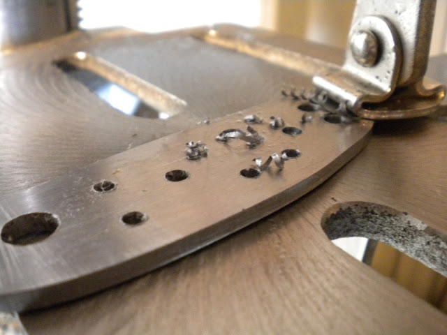

Last night I worked on cleaning up the choil area and drilling both the pin holes and the weight reduction holes in my blank.
Cleanup on the choil area was done with a bastard chainsaw file and 80 grit sand paper. The sand paper was from the loose belt that was giving me all that trouble on Sunday. For some reason or other I had a handle to a plunger lying around and that worked great for sanding that area with a little bit of that 1x30 belt wrapped around it. I then followed up with some 100 grit emery paper wrapped around a paint stick. I don't remember whose idea it was to use a paint stick for sanding, but they are a genius.
Next up was drilling the holes in the tang with my drill press. It is a 5-speed craftsman, so I used the lowest speed which is 620 for the drilling. The machine recommends a speed of about 1200 for metal, but I didn't want to break any bits just yet. I'll try a higher speed next time, unless anyone recommends against it.
By the way, tryppyr mentioned in someone else's thread about getting swivel clamps from harbor freight. Those things are great. I only have one right now, but I am definitely getting some more here real soon.
Here's some pics of the drilling.
This one was taken by my roommate as I was drilling.
Here you can see that I've clamped the blade to the work table with the swivel vise. This thing made it much easier to move the blank around when drilling multiple holes of the same size.
As you can see, when I started drilling any holes over 1/8" I began to get long curly pieces of steel.
Now for the lessons I learned while doing this. I haven't drilled this much metal before and the metal I had drilled before was about 14 gauge aluminum. Quite a different beast.
1. I knew this already, but I went ahead and tested it. Always drill pilot holes. I used a 1/16" bit for the pilot holes and it made things so much easier on the bits and my nerves. I did try drilling a straight 5/32" hole once. It made a hell of a screeching sound and the drilling was very very slow. Also, don't forget to center-punch your holes before drilling. I don't know if I could have gotten away with not doing it with the small pilot holes I drilled, but I didn't want to chance it.
2. Use some kind of oil for drilling. And use it like it's free. Drilling with about 2-3 drops of oil on the bit per hole made things very very smooth. In fact, with all the drilling I did, not one of the bits got too hot to touch.
3. Drill all of the same size holes at once. I was still learning as I was doing, so with the first three holes for the pins and lanyard tube I changed bits and finished out each hole one at a time. This is very slow, since the shaft of a 1/16" compared to 1/8" compared to 5/32" is quite different. I had to move the material rest between each bit change and then realign the blank with the bit. So 11 bit changes for three holes and I probably spent well over an hour just drilling those three.
When I started doing the weight reduction holes I drilled all of the pilot holes first, then moved up to the next size bit in the progression, drilled those holes, then did it again until I was finished. Total time on the remaining 8 holes was maybe 45 minutes.
4. There may be a better way of doing this and I will experiment some more on my own with it, but I found progressing the bit sizes incrementally seemed to be the best way to do it. I went from 1/16 to 1/8 to 3/16 to 1/4 on the weight reduction holes. It looks like I moved up 1/16 in size with each bit change. Anyone that has more experience, please feel free to tell me I'm wrong on this progression or if there is a better way. I'm still learning here.
5. Make sure to clean the material rest every couple of holes or so. I found that bits of steel were getting stuck under the blank so that it wouldn't sit level on the rest. This may or may not have affected my hole orientation, but I felt better with the stock flat.
6. Wear a full face shield when doing this. My drill press is mounted a little high at the moment and when I started using bits over 1/8" the bit would throw smoking pieces of metal at me like it was aiming. I don't know if it would have hurt or not, but I'd rather be safe than sorry.

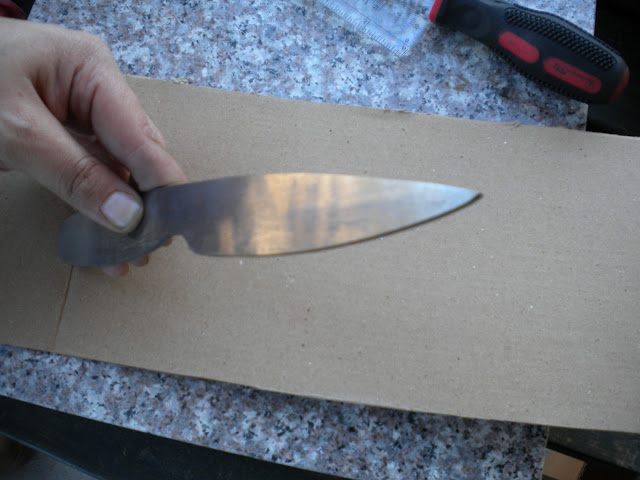

Today I got some more of the Norton sandpaper in grits from 60 to 400 to sand the rest of it.
My question is, how to I bring the edge back up some so that the edge is thick enough for heat treating? I have a HF 1x30 that I can use, but I'm not keen on that idea. I've also thought about just running the edge back and forth on sandpaper. I could file the edge back I think, but I would like to know what someone more experienced would suggest. Thanks.
I know this is hard without a picture to see but my wife has the camera right now. Later when I get it I'll throw up some pics so that you all can see what I am talking about. I'm just gonna work on sanding the knife a bit to get the file marks out.

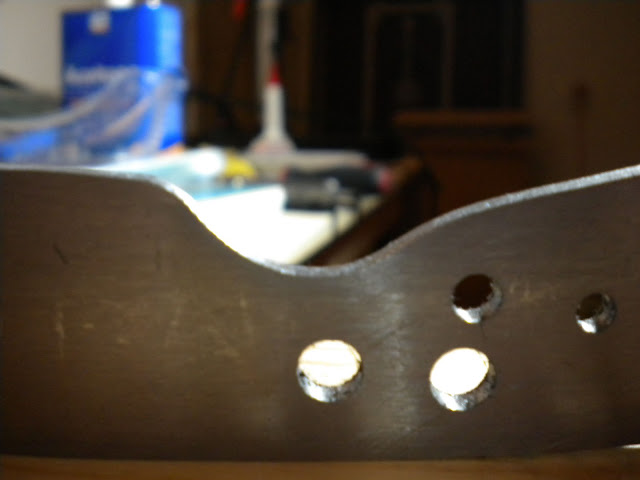

Here are the pictures as promised.
Here you can see that the edge thickness near the plunge is way too thin. It thickens a little toward the point but not much.
Here is the bevel on the left side of the knife. The number 2 is to help me keep track of which side of the tang I sanded first. The tang here is sanded to 60 grit. There were some nasty scratches and it took me a while to get them out.
Right side now. The tang on this side has been finished to 120 grit so far.
Here is a close up of the left side. You can see near the plunge that the steel looks bent. This is because it isn't perfectly even and with how thin the metal is there is has a little bit of an angle. It's also hard to see here but near the spine there is a low spot from when I was draw filing. I could fix this with even more filing, but with the edge as thin as it is I really don't want to remove much more metal.
I'm thinking that after I bring the edge up, still debating on how to do that, I'll use my actual chainsaw file to put in a Spanish Notch. This should help with the transition from plunge to edge looking more even. It is hard to see but I nicked the corner of the deepest part of the plunge with the edge of the file once or twice. I'm thinking that I should round the corner a little to make it so that it doesn't look so much like I messed up there.
For the sanding I used some spray adhesive to stick sand paper to the granite block I have, but I'm having a tough time holding the knife while sanding. I wrapped the blade in tape and used a piece of scrap leather for my thumb on the blade, but the 90 degree edge of the tang is biting into my thumb right now while I'm moving the tang over the sand paper. The only thing I can think of at this point is to tape my thumb because the gloves are too big and get snagged by the sand paper when I tried that. It's a little difficult to hold the tang with just fingertips to move it around on the sandpaper but I haven't come up with anything better yet.
It is looking good for a first knife. If you can get some soft lead sheet for the jaws you could clamp the knife in a vise. You'ld be sanding on the vertical though.
