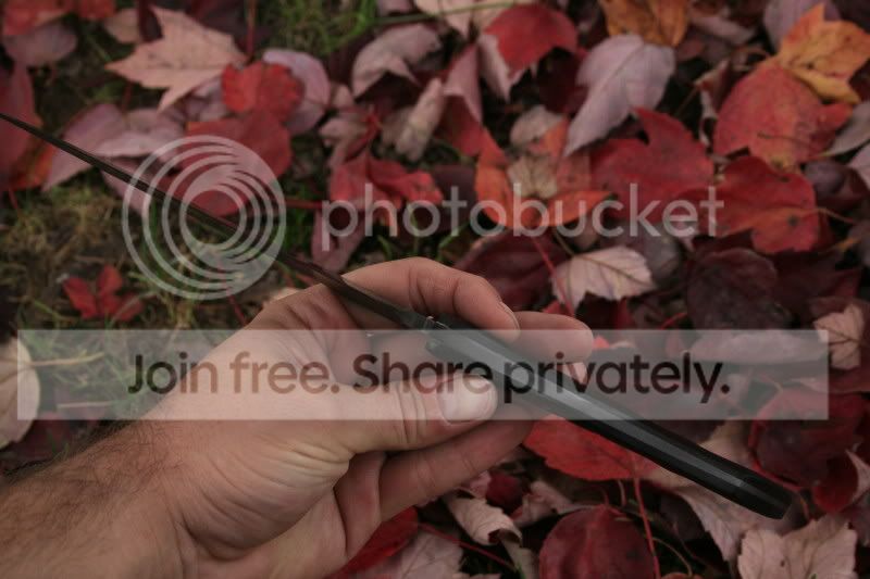

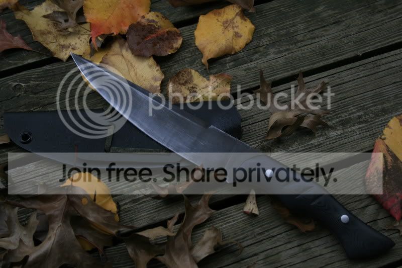

G10 like any handle material is as comfortable as you make it. I like using 1/4 g10 and heavily shaping it. Here is a black g10 and 5160 fighter I forged out.
Kind of hard to see but the handle is carved to fit the hand.

I really like the "finish" of your fighter, I can see how you contoured it and it looks awesome!! I think I got her nailed down for the chopper thanks to you guys :) :thumbup: As far as the handle material I always thought well textured G-10 was awesome for my slicers as they provided excellent grip regardless of the temp or wetness. I was mainly looking for an impact friendly material which is why I chose the above. I love my A1/Outkasts material, love it. But it would be so much easier and cheaper to use the g10 or like. I think I'll give that a shot as I was thinking of switching that up due to the wait and cost of having it molded. Although I have suitable funds for however far I'd like to take it, logically I'd like to keep this project under 400 as I'm sitting now material wise. So thank you for the suggestion Jon :) You've been a great help in me moving forward with my plans man :thumbup: Glad you came back in here and shared your knife as well. I've got a few smaller questions that I'll shoot you a pm on if you dont mind.
