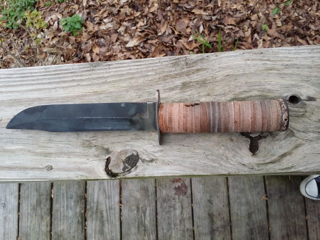

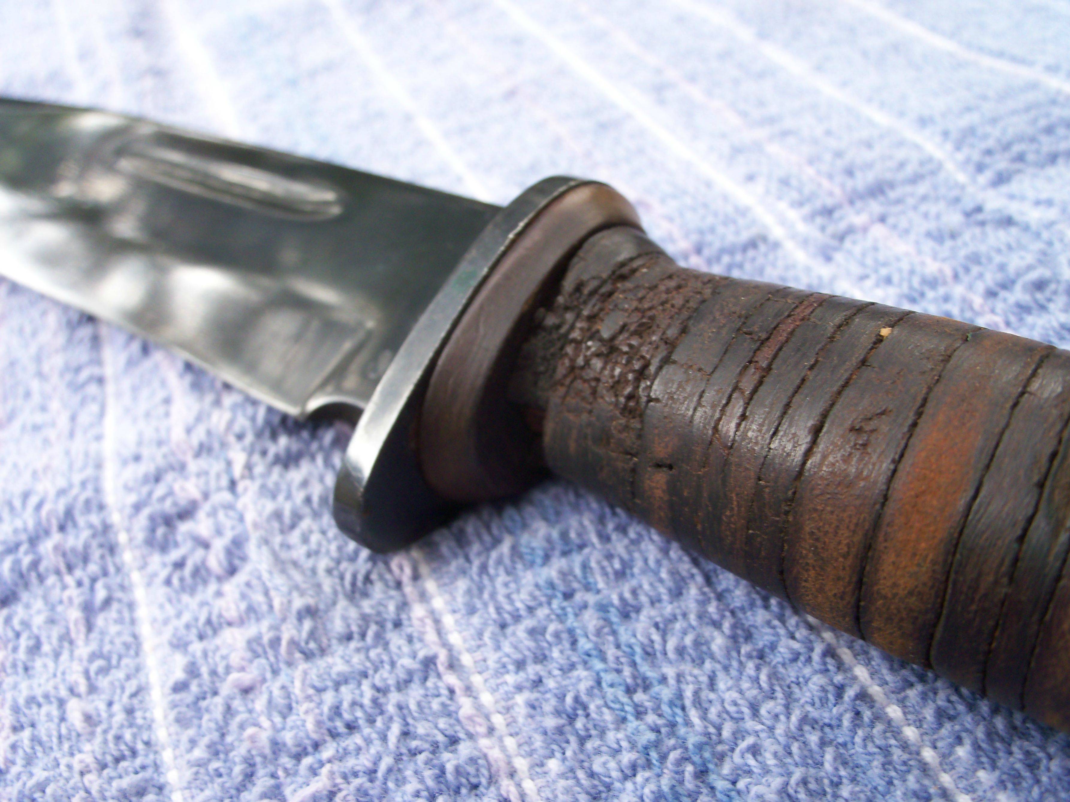

Hello everyone. New to the forum. I was wondering if I could pick your brains about what to do with this old knife I found. I didn't pay much for it, and I would like to possibly restore the handle on it. The blade actually appears to be in very good shape with little to no rust. Lots of parkerization there, it looks like. Not going to mess with the blade. I'm definitely no knife expert (hopefully this thing isn't a knock off) but I am pretty sure the markings read "US" on top and "CAMILLUS" on the bottom. The bottom part is a little sketchy since the guard has been welded on there.

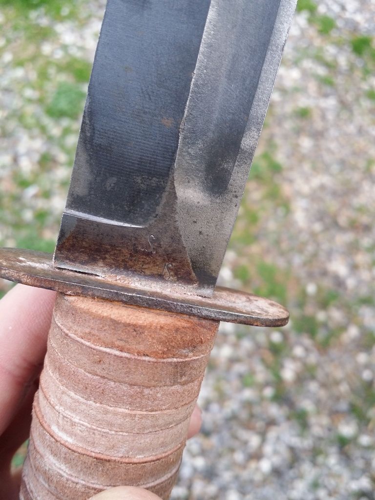

The real issue is with the old leather handle. It's shot. It's dried up, cracked, and mildewed. There are about 3 leather rings that are broken and pop off, revealing a VERY rusty shaft in the middle. The rust is expanding a has stretched, deformed, and broken the leather. This is Georgia. Maybe the humidity got to it?

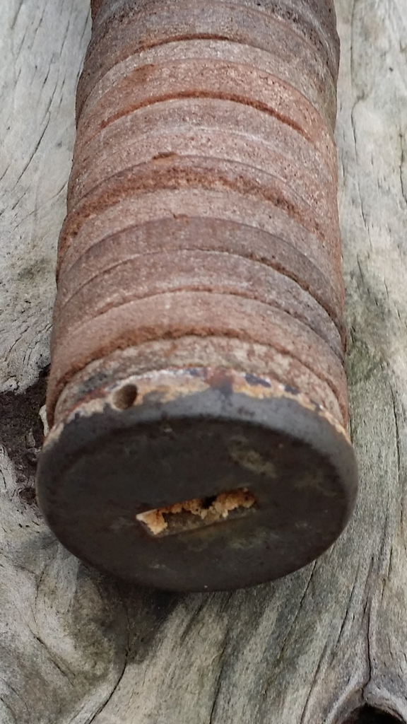

The pommel doesn't appear to be on all the way tight. Some pics I have seen have some metal protruding from the bottom of the pommel. This one looks pretty empty. Is something supposed to be welded in there? Also, here is a hole running through the pommel where it looks like a pin should be. I cal see through it.
Anyway, I'm pretty sure that in this shape it probably isn't "collector grade", so I would like to do some tinkering with it. The plan is to remove the rust and disassemble it as best I can, order a new handle parts set from Ka-Bar (to replace the pommel if I need to only $8.00) and install one of the newer synthetic handles - like the black or OD Green ones that come on their newer models. The handle replacement parts kit comes with those leather washers, but from what I have seen I don't think I want to mess with stacking and shaping those things.
Where should I go from here? Is there anything I need to look out for when disassembling? Is this thing "too far gone"? What's it going to take to get it back going again? And does anyone know a place I can source those synthetic handles? Do I need to get a hold of Ka-Bar? The only replacement handles I can find are stacked leather. I think I would have to get a "pro" to do those.
Anyway, sorry to be a pain in the keister with my first post. Any assistance would be much appreciated. Many thanks. Here are some pics of this beaut:

Ok, well what you have is not a Kabar. It's exactly what you said.... a Camillus. It's a Ka-bar look a like. Camillus' are inexpensive(under $30) knives. The handle has had severe water damage. Needs to be completely replaced. It's easy. I don't believe you can get Ka-Bar parts. Wouldn't anyway because it's not a Ka-Bar. Most people would just make a new guard. And the pommel is welded, or just peened on the end of the tang. Then just cold blue everything. You can find several "how to" instructional vids on YouTube. Have fun!
Oh yeah! I forgot. The previous post was correct. Someone DID try to put new leather rings on. They just never shaped it.
Lots of misinformation here.
The leather washers are new, and are available from KaBar's parent company, Cutco.
It simply needs to be ground to shape.
Camillus Mk2 knives are worth far more than $30. This pattern knife is identical to the KaBar and Ontario models. All were made to the same specs for the US government.
The pommel is held on this knife with a pin-that's why there is a hole in the side of the pommel.

Your correct on the one point. These pommels are attached via pin stock. But those washers are absolutely not new! If you think they are, you've never done a leather handle. It's all dry rotted. And read what I said again. I already mentioned it was not shaped! Last, here ya go.

The leather washers show no sign (to me) of dry rot-though 3 of them are cracked. They also appear to have never been compressed, and they certainly have never been ground to shape.
What I believe you perceive as mildew looks to be paint on the steel pommel. I have a little more experience with things like this than most people.
I believe the Camillus version predates the KaBar version of this knife, BTW- though I am no expert on MkIIs.

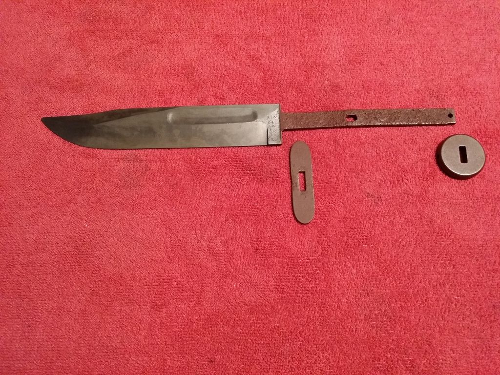

The leather washers were shot. They were put on there and never pressed, lacquered, or ground. Moisture gathered wherever the metal met leather. They could not be saved.
If the guard was welded on there, it wasn't welded too good because it popped off. I guess I have everything I need to reassemble it except for the pommel pin and the leather washers.
Will the leather repair kit from Ka-Bar still fit this thing? A friend of min has a grinder and he THINKS he can accomplish the handle shaping LOL.

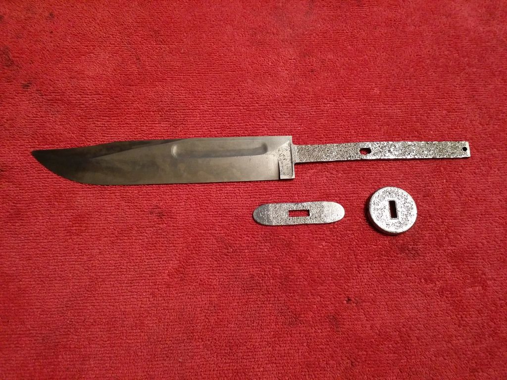

Just got all the rust cleaned off after soaking two days in vinegar and scrubbing with a wire brush, Brillo Pad, 120 & 220 grit sandpaper, and #0000 steel wool.

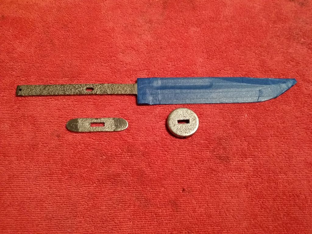

Taped up the blade and applied a coat of Rustoleum "Rusted Metal Primer". Going to paint these pieces flat black tomorrow. Leaving the blade bare for now. May also paint flat black after the handle is done.
BEFORE PRIMER:
AFTER PRIMER:
When you get you new washers and get them compressed onto the tang, grind/file the leather in one direction only to cut it down. You do not need to lacquer it or otherwise treat the leather. After it is finish sanded (in the same direction,) you an put a few coats of paste wax on it.
