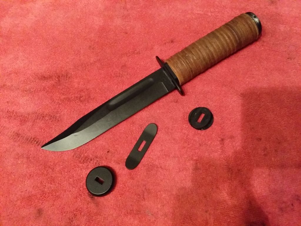

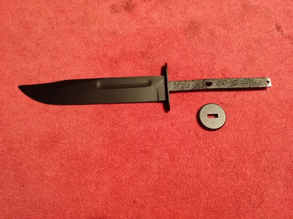

OK. So I attached the guard using JB weld and sanded it flat on the underside. Got it square and flat and ready to add the leather. I then gave it a coat of flat black ceramic engine block paint. Just waiting for the leather rings and spacers to get here so I can get started.
Well, I got the leather washers on. I was able to fit all of them on there, but I had to sand a little off the last one to thin it down. I got the top spacer on, but the one on the bottom wouldn't fit. I used the old pommel. The only parts I used from the kit were the washers, top spacer, and pin.
I have these leftover parts from the kit:
  • Hand Guard
  • Pommel
  • Bottom Spacer
I hope the washers are pressed on there tight enough. I tapped around them with a hammer and used carpenters glue. I guess I will start looking for a bench grinder or belt sander to shape the handle now.

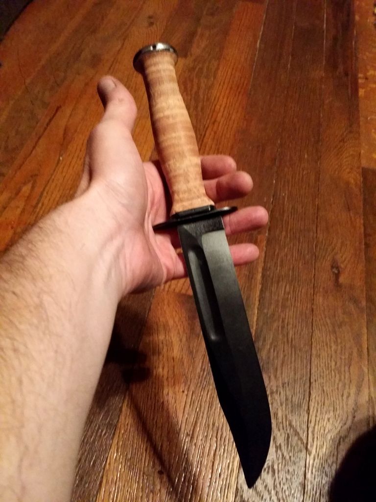

I just hope the washers are going to be good n' tight. They feel like they are going to be OK, but I still wish I had gotten the newer, thicker, pommel and the bottom spacer on there just to crush the washers to each other a little tighter. I stacked them shiny-side towards the hand guard. I put one drop of that "Newer Formula" Elmer's Carpenter Wood Glue on the washers on each side of the tang, then added another washer on top that I had briefly soaked in a 50/50 wood glue & water mix. Repeated this process. Had to sand away some of the rough side of the last washer to get a tight fit. I tried to tap them on tight with a regular size ball-peen hammer. If I had it to do all over again, I would have used a chisel or short flat-head screwdriver to tap the leather down where it meets the tang. I don't think I was getting that part as tamped down as I should have been.
I also wish I had held off on painting it - except for the tang. Needed to at least hit the tang with primer to prevent it rusting up again (I would think). Also wish I would have put the newer hand guard now that I get to looking at that old USN MK2 you posted, David LOL. I bent my smallest punch driving in that pin. After I bent the crap out of the punch, I switched to the next size up (which happened to be the perfect size).
Like I mentioned earlier, I assume by the way I found this knife, some other guy had tried repair it and just gave up. I might screw it up yet, but at least I got further than that guy.
Leather washers were compressed with a piece of pipe that was hit with a hammer, in the knife factories. Blade was held in a vise.
You can shape the handle with sharp rasps and sharp files. Again- only cut in one direction, around the leather. Sand if you wish-same direction. Finish with a coat of paste wax or shoe polish.
It looks good so far.

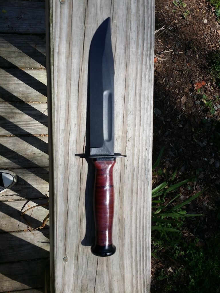

  • Apply some red shoe polish to the handle
  • Put an edge on the blade
Just put on a good helping of Kiwi Cordova Shoe Polish. I am debating whether or not to cut the grooves now. I am afraid I might screw it up. It's not perfect but it's not bad for my first attempt at something like this LOL.
