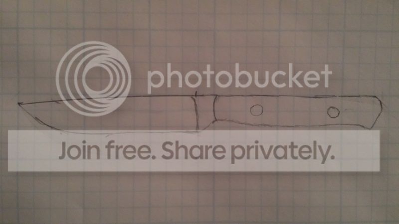

This is my first post on this great forum. I've been reading and slowly learning and building up my tools. I have the files, sandpaper, steel (1084) and just completed a filing jig. I think I'm ready to go for it but wanted to post a picture of what I'm planning on making. It's based on the Bark River Little Creek. The total length is around 5.5 inches. In the picture, each small square is 1/4". I'm looking forward to your opinions. I've talked about doing this for years and I've finally worked up the nerve to try it.
Thanks.
Joe
Looks like as good a place to start as any. I don't see anything terribly wrong with the design. I personally might make the choil area (curve under the front edge of the handle) more of a constant radius or semi circular line. But that's me. I think I'd make the whole design wider top to bottom as well. According to your sketch the handle will only be a half inch deep. And your handle will only be 2.5" long. I'd think you'd want in the neighborhood of an inch at least to fill the hand a bit and at least 4" long. Make a mock up out of cardboard, Masonite hardboard, plexiglass or something similar that is easy to shape. Try different sizes to see what fits your hand the best. I would say, make another drawing traced over this one. Make the lines basically the same except that the top and bottom lines of the handle are 1" apart and lengthen the handle a bit. Then adjust the curve of the blade to work with the wider dimensions. Make a mock up of that and see how that feels.

The basic shape and design looks good....with the problem Marc pointed out. The blade is 3" long and the handle is 2.5" . That is a very small handle. I would reverse the two. A 2.5" blade is a nice small knife, and at 3" you will be able to get a grip on the handle. Personally, I would make the blade 2.5" and the handle 3.5"
Thanks for all the suggestions. I decided to increase the overall size of this knife. It's the same basic shape with a 4" blade and 4.25" handle. I've cut the basic shape using the drill press/hacksaw method and am in the process of cleaning up all the edges. It's been too cold in the shop the last few days to make any progress but hopefully this weekend I'll be able to start on the bevel. Thanks again for all the help!
