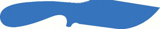

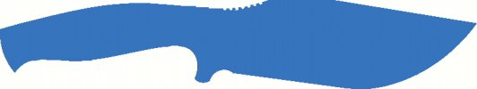

After 20 years of playing at knifemaking and discovering how satisfying it can be, I've finally decided to take a stab at doing a production run of one of the designs I've gotten a particularly positive response on, from family and friends. And, since WIP threads are, and have been over the years, one of my favorite types of threads, I decided to take a shot at posting my efforts as a WIP at the same time. I've ordered a partial sheet of 440C (.187" - .207" thick X 5.250" wide X 77" long) to be cut on a waterjet. These blanks will be my project. I'll be posting pics as soon as I receive the blanks (shipment is due in on 4-8-2010) and then more as the project progresses. According to my calculations and my CAD layout, there should be 14 blanks, but I haven't verified that is how many were actually cut yet. I also have not yet decided what handle material(s) / option(s) to dress them out in. I'm posting a JPEG of the outline of the knife I chose to make and would welcome feedback as to what handle material(s) will look/function best. It is titled "SS HUNTER". I designed this knife to be a Hunter/Skinner so with that in mind please feel free to post your thoughts. I made the handle to be a bit oversized because I am debating converting a few to a slightly different handle style (pic titled "SS HUNTER 2") The grind will be a flat grind as I think it suits the shape and purpose of the knife. A few of these will be finished with a teflon coating and at least one with a "parkerized" finish and I'd welcome your thoughts regarding that as well. This ought to be fairly interesting, but a word of caution: I work a fulltime job that is NOT making knives and have a wife and 3 small daughters at home, so my time will be balanced between all these. I fully expect this to be a long project.
Larry
EDIT: I forgot to post dimensions: 10½" OAL x 2" at widest point (belly) x 3/16" thick 440C.

Both great looking design IMO. I would definitely try different types of handle material (Micarta, G-10, wood etc) if I were you so you can get a handle on what its like to grind and file different types of material and how they grind shape etc. I would start with green, tan or black micarta as a start (Dont forget your respirator). have you decided what kind of fasteners you will use and what kind of glue you have decided on. Also any lanyard holes on your handles? Lots of options when you make your own knives, have fun and good luck.

Larry, I love the overall design, but would suggest a little more butt for grip security on a knife that size and weight, maybe with a lanyard hole as well, something like this:
Contoured canvas micarta is hard to beat for strength and gripiness in handle material.

I drew these up in a program I use for making vinyl decals. That program allows me to export the saved file as a DXF file (a CAD file in case you don't already know). I was then able to email the file off to the company I had do the waterjet for me (I also bought the steel through them). Total cost for steel, waterjet cutting, shipping, and insurance was a little over $500.00 for 14 blanks. I had them ship me the drops as well and I still have about 6 linear feet of usable steel that I can get several other knife styles from. Well worth the cost. I will be posting their contact info later in this thread. I've been designing knives for about 15 years so I actually have over 100 designs saved as DXF files. At some point I may offer them for sale on CD as a DXF library. I am still in the process of organizing the files by style and checking into pricing to produce and market the CD. If there is anything else I can help you with please feel free to contact me. Have a good night, Sir.
black mamba,
Glad you like the design. That's an interesting design that you came up with for the handle. You are the 2nd person to tell me that I should consider incorporating a lanyard hole into the design so I may take that advice and do just that ... at least on a few of this first batch. I was also thinking of a textured handle finish. I will probably drill some lightening holes in the handle since these are pretty hefty without handle material attached. I don't know how much they weigh, but I am taking one with me to work tomorrow and will weigh it just to satisfy my own curiosity. I'll post that info here. I actually made the handle on this one a little oversized to be able to make modifications if need be. I can fit the 2nd option (posted in my original post) onto the shape I had cut out or I can cut the handle down to end up with a hidden or through tang. Lots of options. I actually like the shape the way it is, but a bit smaller. Thanks for looking and I hope you enjoy the thread as I progress with my project. :thumbup:

excellent looking designs. I like simple handle shapes for long days of use, but I actually like your RH, contoured design a bit better overall.
In either case, excellent profile.
I am personally not a user of lanyards on knives I'm not chopping with unless I want to bungee the knife to the sheaht for some horseback riding or other bouncy tasks. BUt people want them, so we do them. I have managed to chip micarta with a lanyard hole too far back.
While I realize it's not terribly popular, you might try making the pins into the lanyard holes (1/4 inch 316 tubing for the pins) on a few. It's realistically no weaker than solid pins, and gives the user options for different lanyard placement. When I do use a lanyard on a larger knife, I prefer a forward mount for it.

Thank you for the compliment, Sir. On the contoured design, I actually made the handle a bit too small as black mamba pointed out. I have to agree with him on that. I was shooting for a look that would lead the eye more to the blade and kinda lost track of functionality. No problem as I actually made the handles a bit oversized so I could offer another handle option on the same batch of knives. Thanks for your input regarding lanyard holes as well. Glad you like the overall design and I'm finally getting started on them tomorrow. I have a boat that I need to put some custom decals on tomorrow morning, so I'll be driving EARLY to Baytown (maybe 1½ to 2 hours away), but the minute I get home the rest of the weekend is MINE! :D
