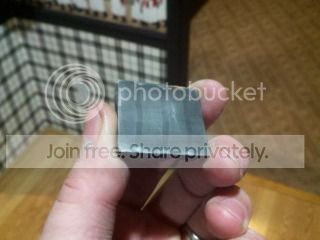

I sawed off the end of the billet and rubbed a little ferric chloride (1st time to mess with FC) and this is what I got.
It welded good as far as I can tell, there is a tiny little spot, that is cracked, but that is from me cutting the sample so close to the edge, it's actually the outside you are seeing.

Welding up all the sides is not necessary and only gives you more to grind off and more to fight against when forging. Simple tack welds on the ends and maybe sides is all thats necessary. (One of my mentors uses wire and just wraps it tight. His hammer and tong technique is way better than mine though...) From the pic, the welds look good. Better than my first few attempts at forge welding honestly.
