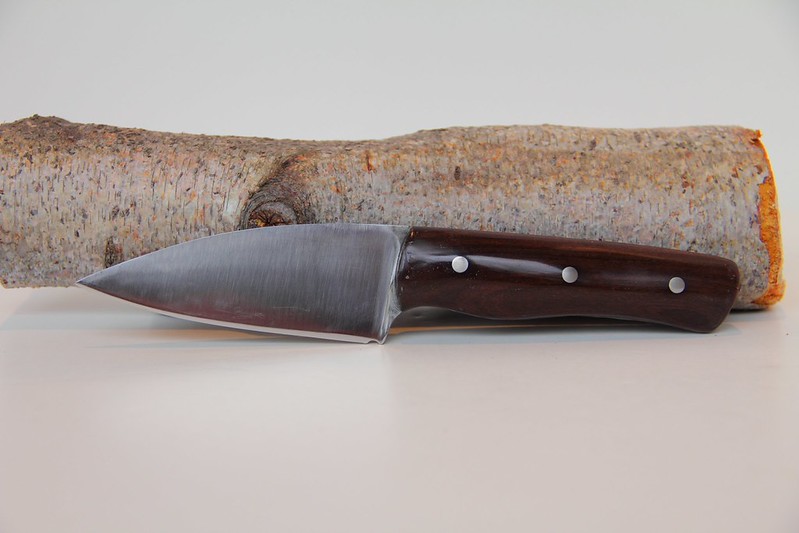

Ok here's a couple. These are the first two I've used the 1x30 sander on, still working on getting it down but it is leaps and bounds from using files. I may still go over them again with the files to true up the grind lines but the knife on top took me about 30-40 mins to put the bevel on both sides.

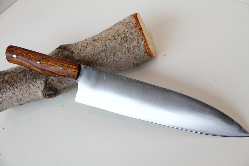

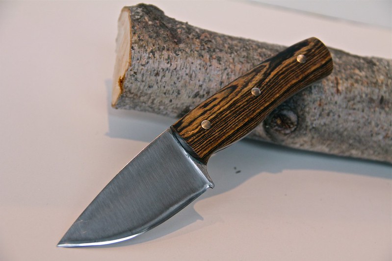

Since I'm already in this thread, I'll go ahead and post a pic of my first three knives that I did with the HF 1x30. I know I was interested in a thread that would show an example, so here you go anyone in the future!
Hey, you start where you're at, right?
