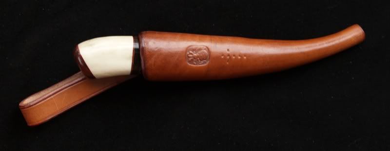

2.5" Scandinavian style with coral
Yesterday I finally made a simple thick leather sheat for this one!!A bit of a scandinavian and my own mixture!!Just some details I might touch up!!
I hope you like it!!
Thanks for looking!!
Regards:Albert

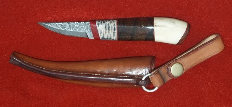

Today I found this piece localy at a place where they sell sea shells,and other stuff!!We don`t have coral here!!Just about $18 for it!!I can now try a bigger project!!
Regards:Albert
Albert, do you sand the coral into the shape you want ?
Also the knife and sheath above is some very fine looking work....
Thank you Dusty!!Yes I sand it to shape(rough) then fill in the tubes with the graphite powder,then use zap a gap.After that is dry I make a muddy mix of zap a gap and graphite and fill in more till flat!!
Then I sand (final) all together!!

Albert, That's another beauty....
Looks very classy with the simple sheath...
Kind regards, -Spinner
Thank you Dusty!!
Spinner!!I am very glad you like the sheath for the little one!!!Thank you!!
Best regards:
Albert
