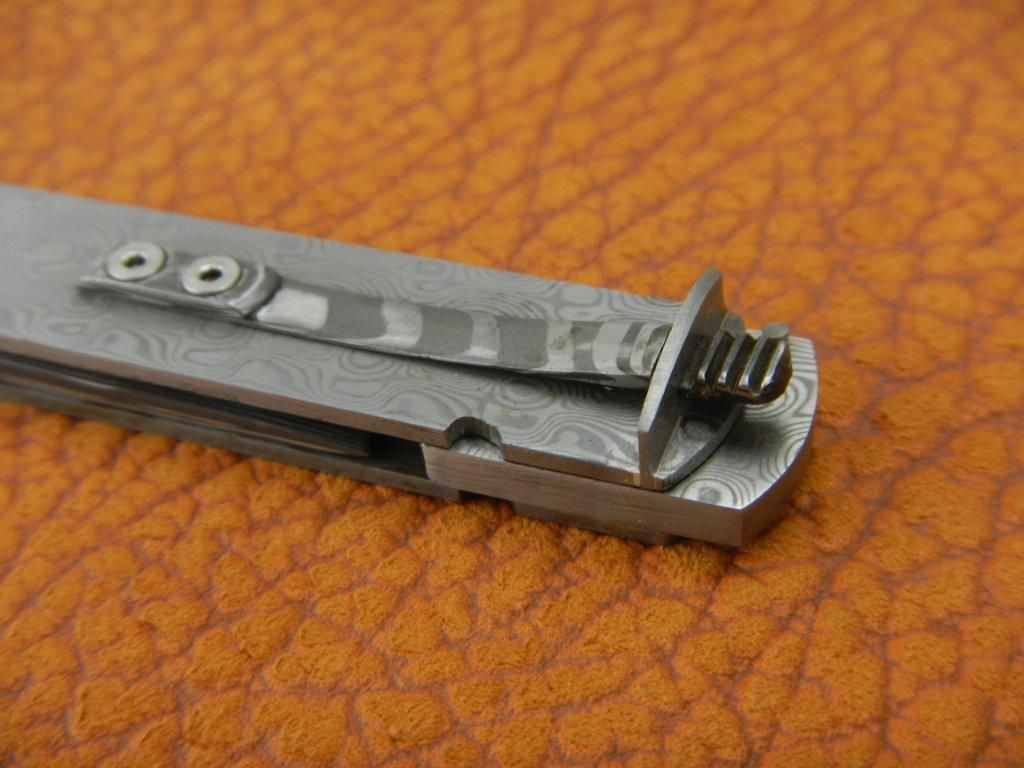

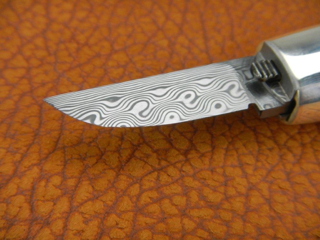

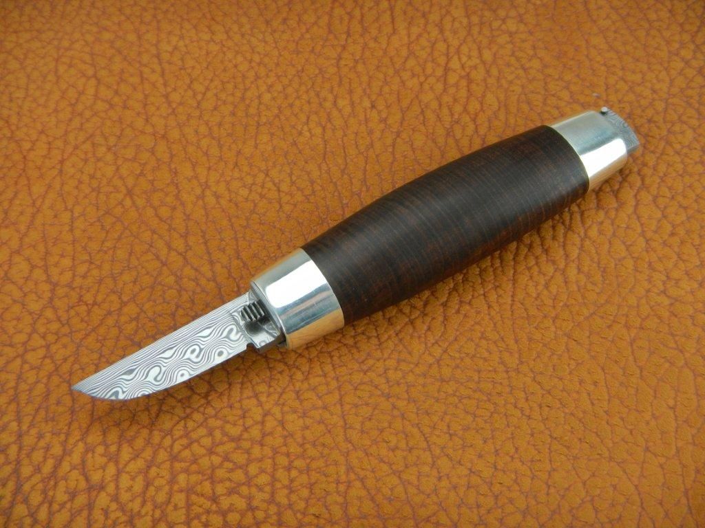

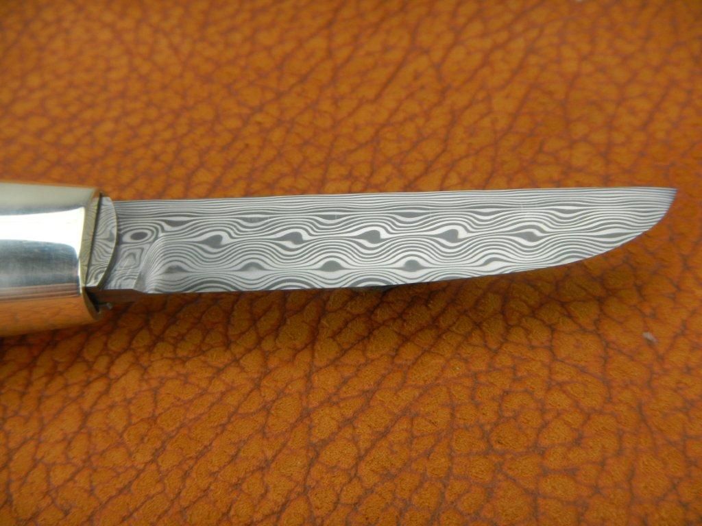

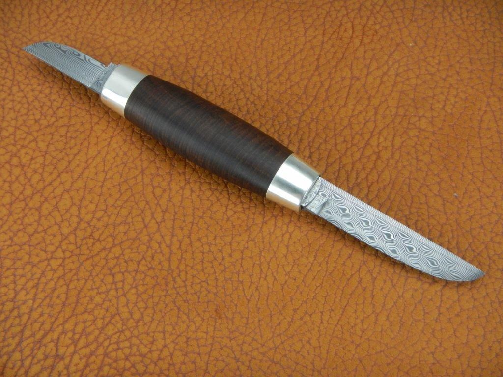

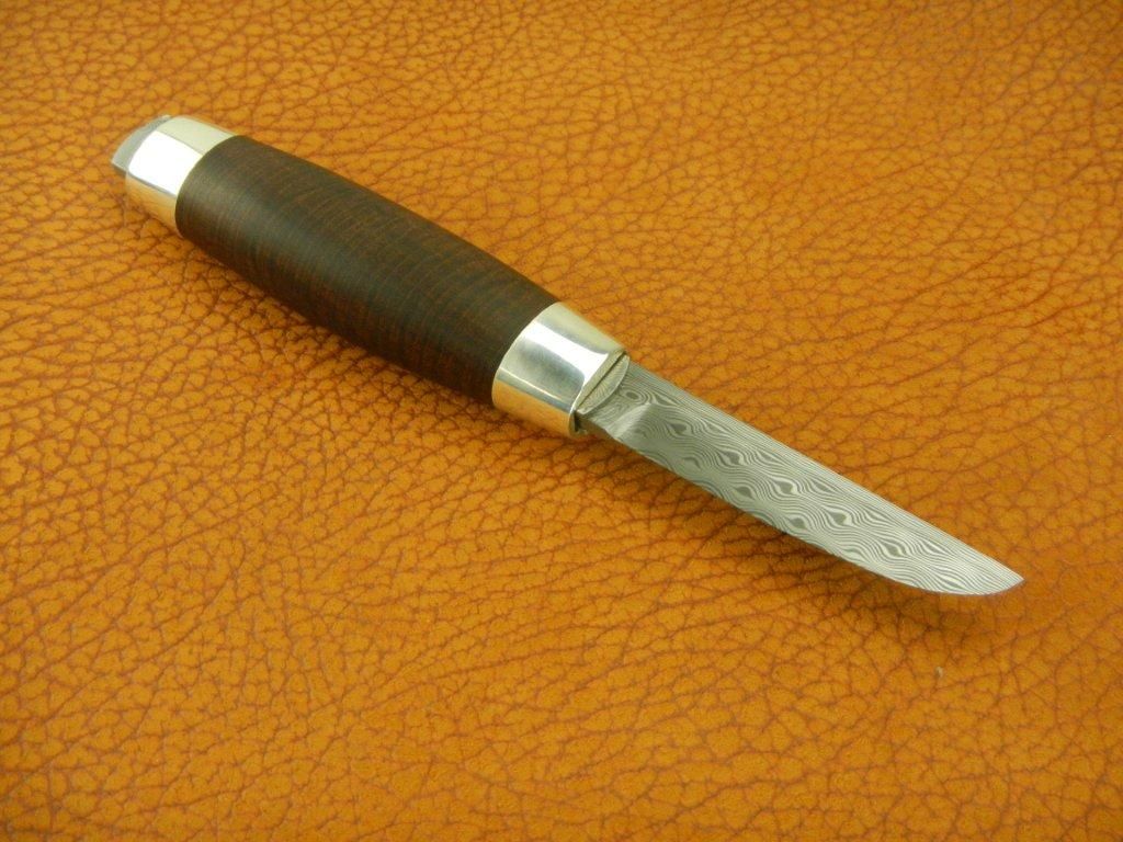

First up, thanks go to ABS Master Smith Mr Thomas Gerner Who showed me in detail how to construct these knives.
I am happy with this knife, but there is still loads I can do to improve.
Two Bladed Barrel Knife
Blades, spring and fittings: Damasteel Stainless Damascus
Timber: Ringed Gidgee
Ferrules: Sterling Silver
Dimensions: Barrel: 4" / 100mm
Large blade: 70mm
Small Blade: 40mm

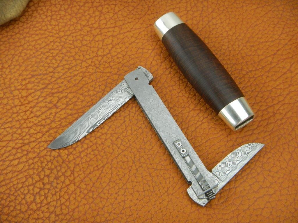

But I'm pretty naive in the world of knives, and have no idea how a barrel knife works. :confused::(:confused:
Anyone willing to give a quick lesson on how to open and close such a knife?

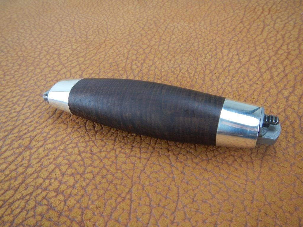

You pull the insert out of the handle and open your blade, then you stick it back in the handle. Voila! Instant fixed blade. The little lever there locks it in place either way.
Fitment of these parts must be close to avoid slop. It must be a bit maddening to get just right.
Many single blade BK's will have a bail on one end for a pocket watch chain, so they only remove and insert in one direction.
First up, thanks for all the positive comments guys, I really appreciate them.
The difference between a good fit, and slight slop can be 1/2 a stroke of the file. yes it is maddening. There is a trick to it though in the way the blades are mounted in the carriers... I would be happy to elaborate if anyone else wants to build one but it needs to be explained with pictures

I did not post pictures of those bits. I have continued to tinker and now fixed a few of them... One thing though, the fit of the ferrules on this knife is the best I have ever done.
The top one in your pic looks nearly identical to my granddads, even the wear, except his has a capped bail similar to the bottom one... Well used and loved. Made by JOH ENGSTROM, ESKILSTUNA SWEDEN. Grandad was a cabinet maker, among other things and a perfectionist. If it didn't fit perfectly, it was done over until it was. His son was the same way. I don't know what happened to me, I give it my best shot and if it works and looks pretty good, I call it done. :D
If you would like to explain the fitment of the inserts, I'm sure many here will enjoy it. I know I will.
The top one is also a Joh Engstrom. It would have had a bail originally and I will make another for it if the mood takes me one day, the middle one is made to take a ring as well, but I just have not made one yet... slack really, but it is off getting engraved with my makers name, serial number and year of manufacture. I like the idea of putting a year on them, hiopefully someone 100 years from now will be showing it and saying, "look at this lovely knife made 100 years ago.." Joh put a date on his, but it was the date of patent and thus useless (1874) He made barrel knives through to around 1915 so all I can say for sure about mine (and your grandfathers) is that it is 100 years old or older.
