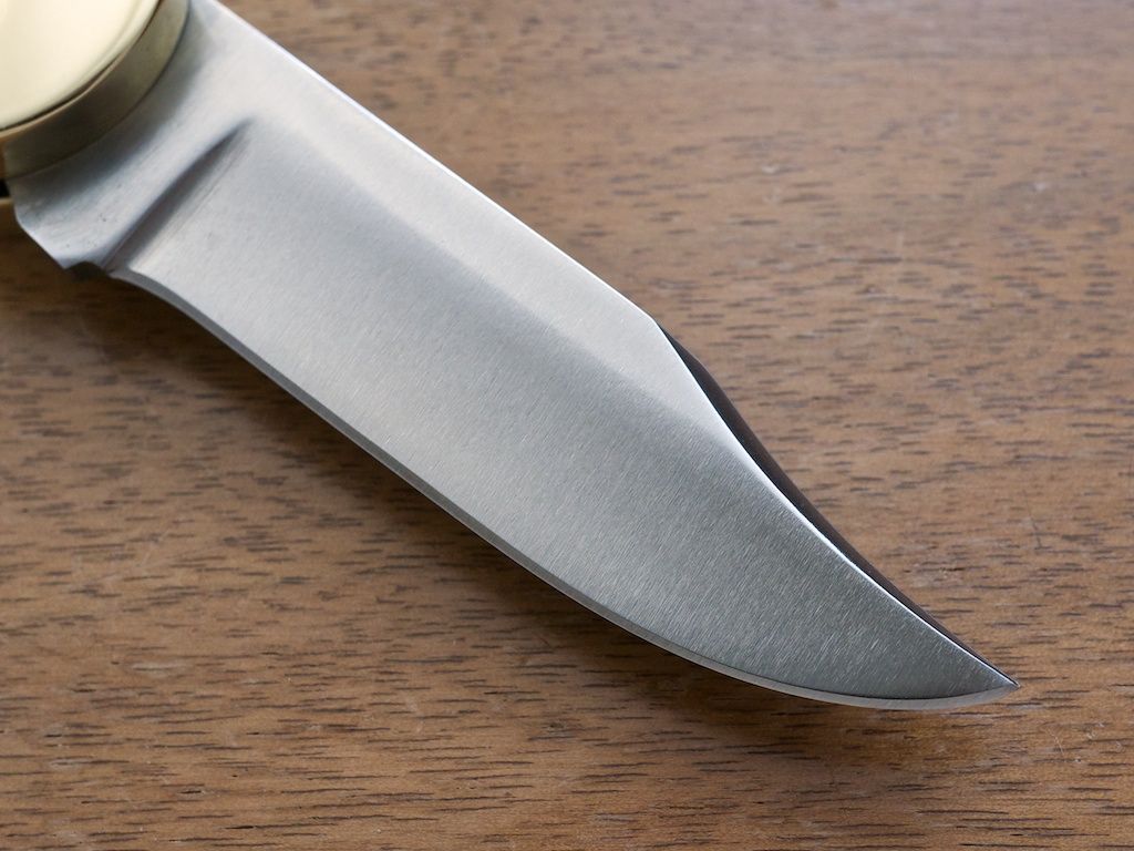

Hi all,
I recently acquired a NIB 2 Dot 112 and I have a few questions for some of the more knowledgeable members about the actual condition of it. When I initially inspected it I thought the tip looked a little strange compared to other 112's I've seen; almost more rounded off and less pointy. The other thing I noticed is the the majority of the blade is hollow ground, but the tip appears to be convex or flat ground. The only similar knife I have to compare it to is my 422 Bucklite. It definitely has a pointier blade profile and longer swedge, but the overall blade length is the same.
I know that a knife of this era was still mostly hand-made and therefore one should expect differences in machining from sample to sample, but I just want to make sure I got what I paid for and not a damaged knife that has been repaired.
I apologize if I'm obsessing over this too much.
Best,
Matthew
Pics of the blade profile and edge.
Picture showing the hollow ground blade and convex ground tip area.

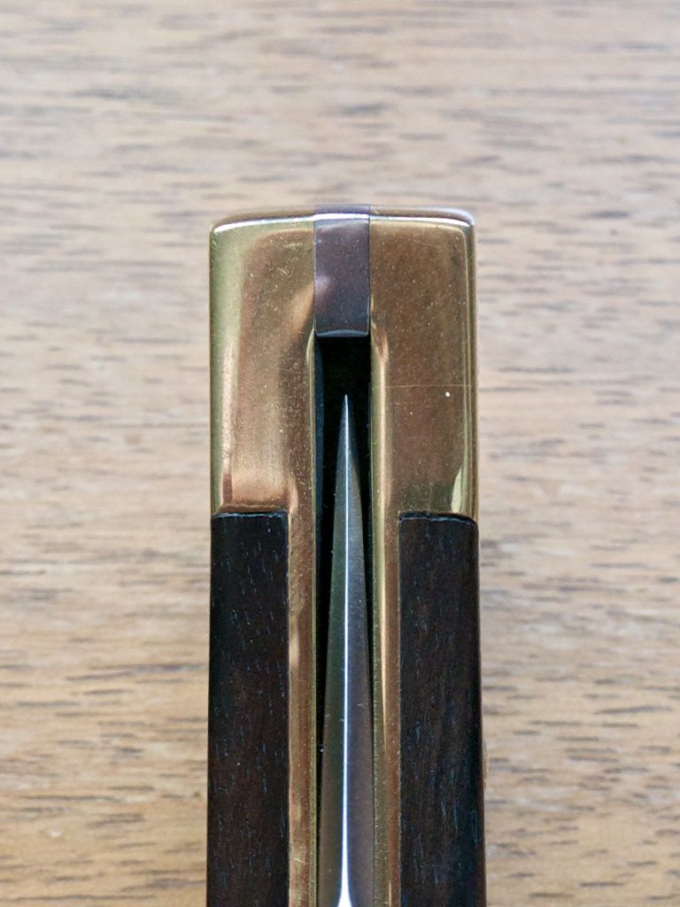

Picture of how the tip sits in the handle.

m., the tip on that era model is convex as well as the secondary edge bevel. That's the manner they were ground. It does not look reshaped to me. What does the blade measure? DM
David,
I thought I had read somewhere that the edge bevel on the 440C blades from the 70's were convex ground, just didn't know about the tip. Thanks for confirming. The blade (depending on where i measure from) is right at 3 inches. Same length as my 422. I think the shorter swedge just makes it look a little stubbier than what I'm used to.

The finishing of the 110/112 is done by hand, by a human, which means you may see a bevel or taper you think is slightly off. They have finished thousands but 'differences' happen. Only experienced knife craftspersons do this. The photos above looks normal to the 2 dot I have.
