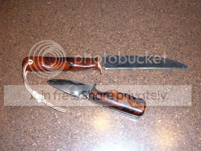

I love it. These two are both Goncola Alves finished in tung oil. Make as glassy or satin has you like. I need more of the stuff :D
