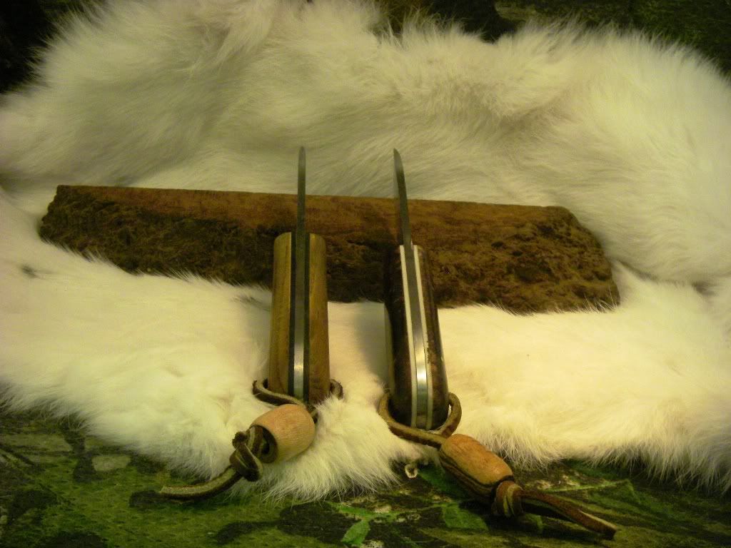

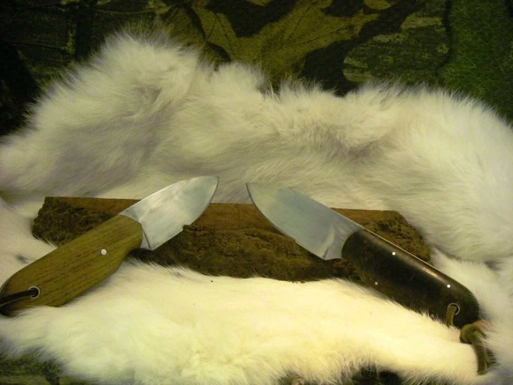

This is my first for sale post here and I’ve got 2 mini-bushcraft neck knives for sale. Both are 1/8” O1 and 6 inches long with different handle treatments. Both are shaving sharp and would make a good strong back-up to your primary bush knife. Blades are 400 grit hand finish. As you can see in one pic, I scorched the G10 on the second one and it didn’t sand out. It doesn’t affect function and hopefully I will go slower next time. The burl on #2 looks better in person; i may try an outside pic tomorrow. Sheaths are hot-oiled with beeswax and include leather lace neck strap. Specs are below the pics.
Number 1 (left)
Steel: 1/8”O1 Heat treat in propane forge, triple tempered at 450 degrees
Blade length: 2.5”, flat grind
Overall length: 6”
Handle: osage orange scorched and BLO finish, 0.090 black G10 liners
Pins: 1/8” 416 stainless pin and 1/4” 416 stainless tube
Sheath: 8-9 oz. hand sewn leather neck sheath, leather thong
Price: $45 Shipped Con US. PayPal or Postal money order
Number 2 (right)
Blade length: 2.8”, flat grind
Overall length: 6”
Handle: stabilized burl (walnut?) , 0.090 white G10 liners
Pins: 4-1/16” 416 stainless pins and 1/4” 416 stainless tube
I accept PayPal (rwnance@vnet.net) or US postal money order. International buyers please contact me first for shipping details.
Thanks for looking, all comments are welcome.
