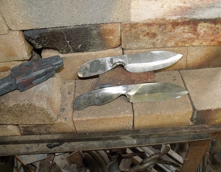

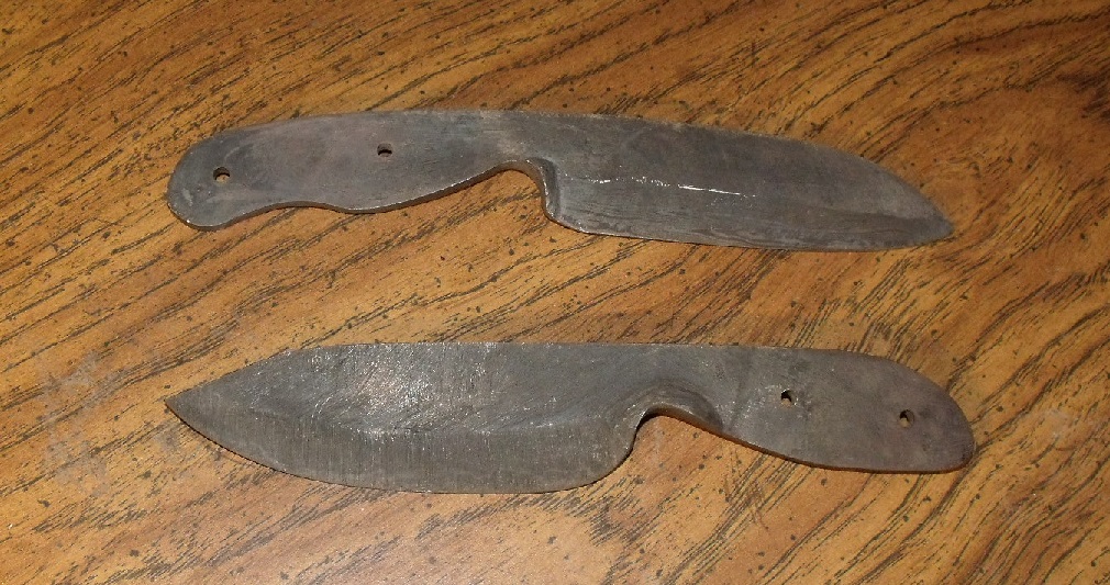

Hello all, hope the newly arrived autumn (or spring for those of you in the southern hemisphere) is treating everyone well. Got another day in the forge yesterday and pounded out these two new blades. The top one is from a billet of 88 layers of 1080/15N20 and the bottom one is from one of 352 layers of 1095/15N20. Didn't really have a pattern or plan on either as I'm still learning this craft and seeing how the steel moves under the hammer, which is why the shorter one ended up with a little bit of a drop point. Here they are after rough grinding:
and here they are after the heat treat and 3 one hour tempers at ~400 degrees:
Not sure how to finish the forged swell at the finger guard before etching, most likely a lot of hand sanding. Was thinking about leaving it as forged, but not sure how that will look after etching the rest of the blade. Any suggestions?
Comments and critiques are also welcome.
Have a great day.
I would just finish grinding the bevels ( a bit higher up ) and leave the flats of the blade and everything else with the forge finish. That is usually how "brut de forge" style knives (forged integral guards) are done anyway. Unless you want to completely clean up the integral finger guard by grinding it clean and smooth, I think it could look a bit odd just leaving that the only area untouched and everything else polished.
So yea, just bring your bevels higher up to show more of the pattern (and to refine the blade geometry for cutting) and give the bevels a good hand rubbed finish to at least 600 grit and then etch the entire thing. That's what I would you anyhow.

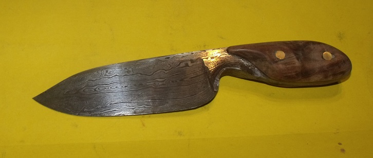

Thanks JT, but too late :o. Not to worry though, the handles went on fine (on one of the knives, anyway), but I don't think I'll be doing many of these finger swells in the near future. I found out that I'm not skilled enough to make them look good. (btw - how's the cutlass coming?)

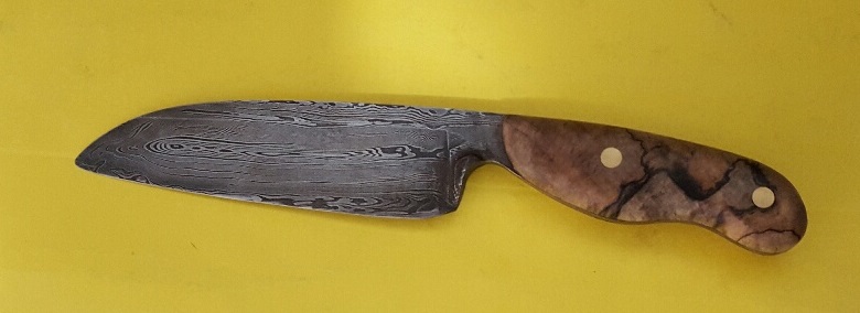

Took your advice, Paul, but didn't change the pattern much.
Looks good man! I'm glad you brought the bevels higher up the blade (for better geometry and cutting ability), nice work! I have always been a fan of brute de forge. :thumbup:

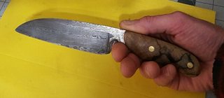

Thanks Paul.
You and JT are correct about the other knife. I tried to shape the scales around the swell, and it looks absolutely terrible. I'd say I'll post a pic, but the knife is at my home/shop and not down here in Longview where I rent an apartment during the week, (and I blew out a chunk around a pin when shaping...AND I'm embarrassed at how it looks). I'm planning on grinding off the scales and re-doing it sometime in the near future. Maybe I'll post pics at that time....

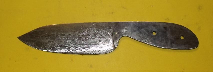

Here are pics of the terrible knife before removing the scales and grinding off the poorly designed swell.
Well, here it is, scales removed, finger swells ground off and ready to re-etch and new handles, but it looks to me like the pin holes may need to be adjusted now, I'm thinking moving the front one forward a bit. Also, does the belly of the blade look a tad fat? Any opinions are welcome.
