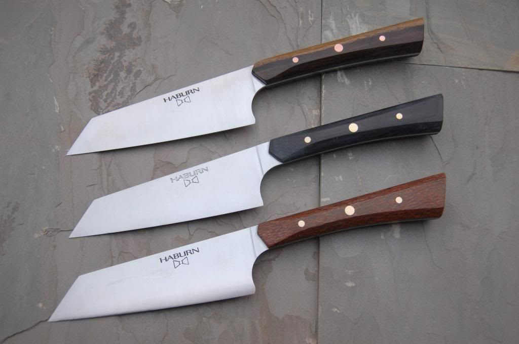

Hand ground from Aldo's 1095 high carbon steel.
Three normalizing cycles, austenitized, quenched, tempered.
Flat grind then convexed behind the edge to reduce food stickage.
Blade has a belt finish at 400.
The handle is hand finished at 1000 in a octagonal shape.
The edge was taken to a 6000 wetstone then stropped.
Top petty: (SOLD)
Bottom petty:
Stabilized fishtail oak
Blade thickness at spine: .063 in.
Thickness behind edge: .012
Tip to handle: 4.1 in.
Handle: 3.9 in.
Overall: 8.0 in.
Price: SOLD
Thanks for looking!
