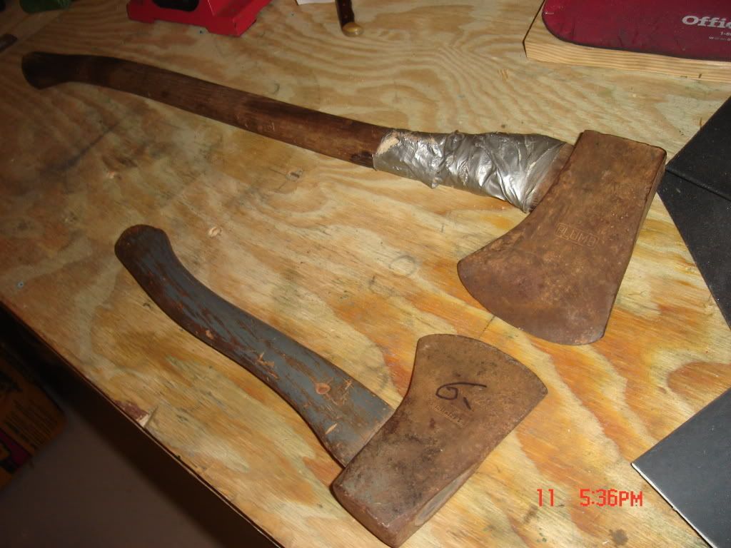

hey guys so i went with my grandparents to a flea market today in texas
and i found these old axes

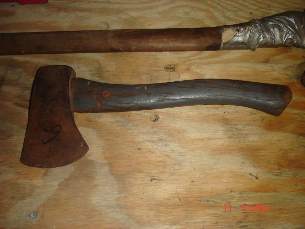

here is the hatchet it is about 10in in length

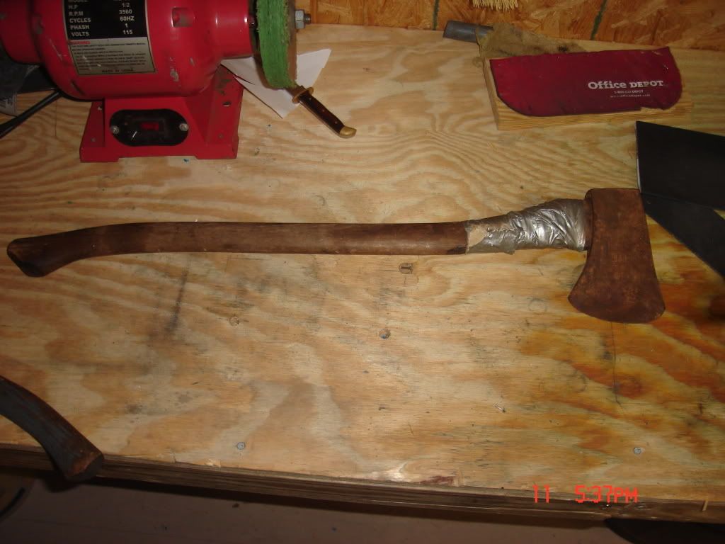

and here is the plumb axe around 24in in length
iam planing on rehandleing them i have already removed most of the rust and have got the edges groud and sharpned i will post some pics later showing the off
Good find, You get em cleaned up & rehandled "You'll be ready, I've got two Plumb's a Very Old Boy Scout Hatchet 12" Handle, And a 28" Handled Double Bit Axe and I like them both there "Awesome Choppers",

The handle on the hand axe looks sound from here. You
might try sanding it down and applying some linseed oil.
Unless you are lucky you may not find another that's as
well matched to the head.

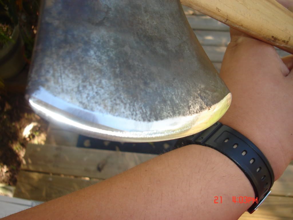

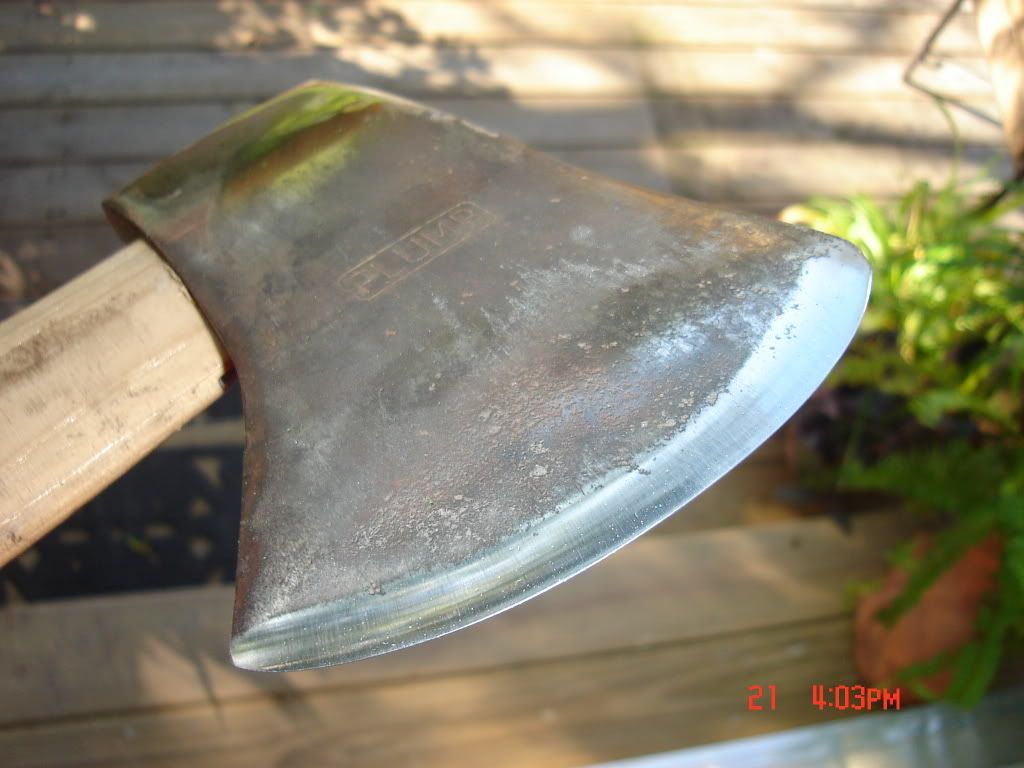

allright gus here a some pics and vids of me grinding and sharpening the bit
gringing vids
the slight mirrior edge after sharpening

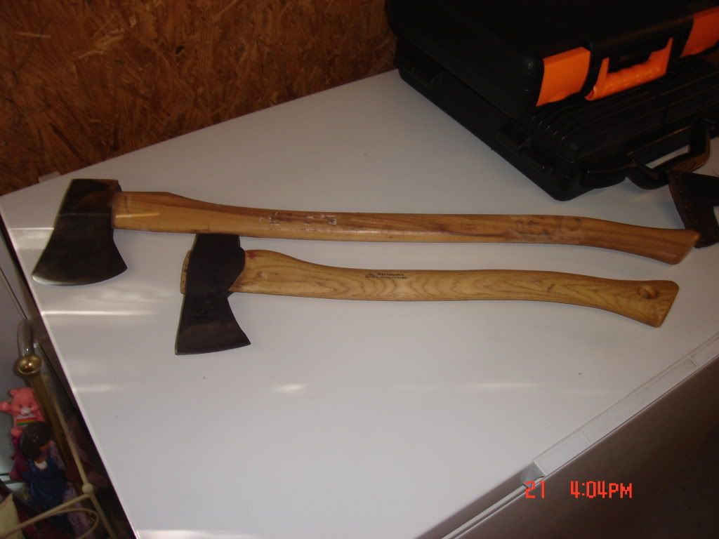

and a compersion with a wettering 19' small forest axe
i have the axe head handle on a 28' hickor handle the axe head weight is aroung
2 1/2 to 3 pounds and it has a 4' cutting edge
Well done ! I just did two a couple months ago and used them over the weekend. Most the time there better than the new ones you can buy.
you got one of my favorite choppers in that hand axe.
excellent steel. usually well turned out, although i have one with a thin side on the eye, all the others are top notch.
the old cutters are as far as i am concerned way better than the new ones. you have a fine tool now.
making a handle to fit is not as big a deal as you might think. look for straight grain, vertical with the eye.
have fun.
buzz
you also did a good job on the edge.
if you want take a look at Old Jimbos web site for some cool info on re-profiling an axe.
