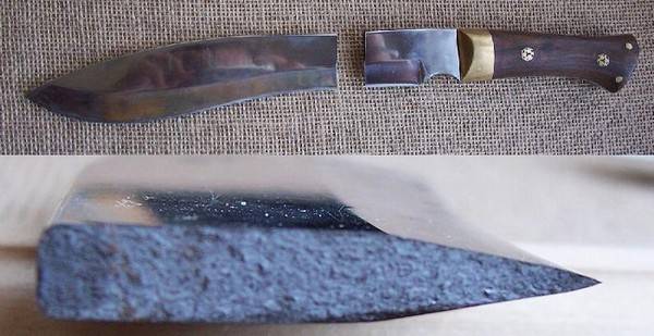

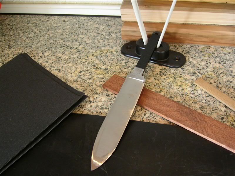

Does someone have an idea about the tang of the CS trailmaster?
I would like to know if there are sharp edges that could cause breaking, for example at the hilt.

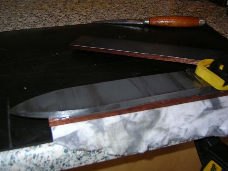

This is how a Trail Master look inside the handle.
I am working on this Cold Steel blade blank and making Rio grande Moran style blade.
Blade is 8" and 5/16" stock Carbon V

Hey Jeffrey where did you get that old Spyderco "Galley V" sharpener. That is one great sharpening system for big blades like bowies and so forth. You must have had that one for a while.
