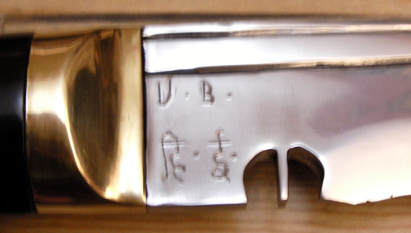

Quick question thought. There is this mark on top of the bolster
It seams to sink pretty deep in the brass. Is this just a cosmetic issue like a birth mark or can it affect the performance of the handle?
Thank you,
That's normal, it's where the brass was soldered into a tube shape to fit the handle.

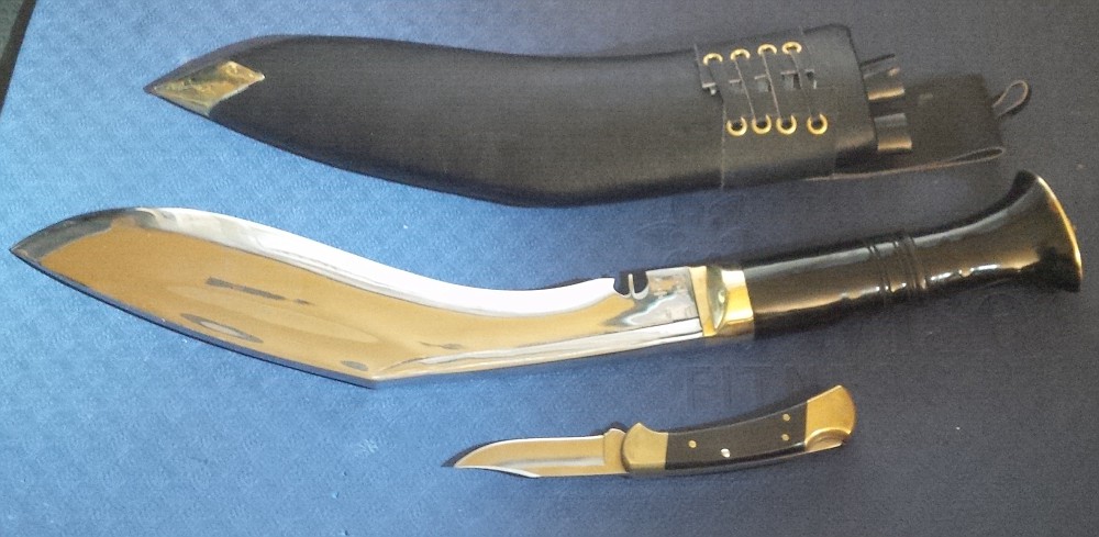

Sorry for poor quality - taken from the phone.
With my good old Buck 112 for size comparison

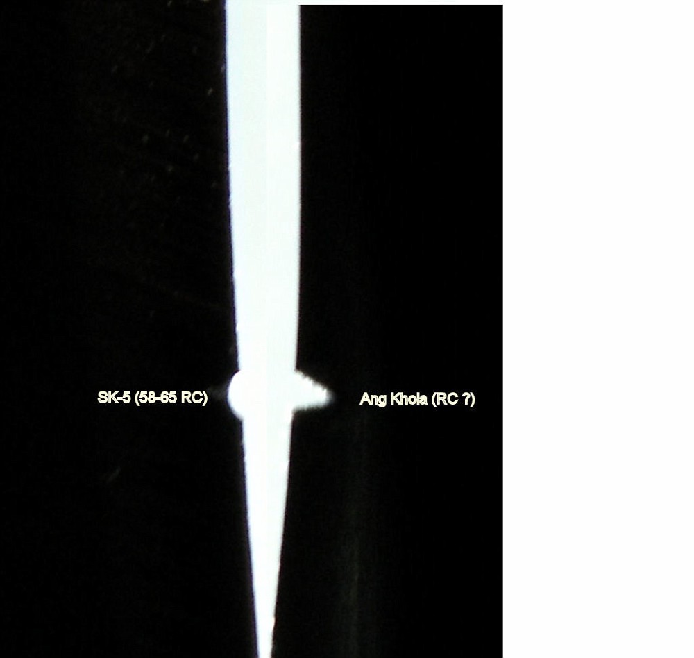

This massive AK has a lot of steel, I was curious about the temper and how the Kamis managed to quenched it.
So I did a nasty thing... A blade to blade test against SK5 which will range from 58 to 65 RC.

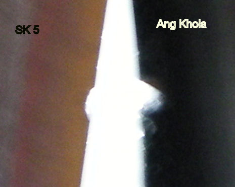

Left SK5, Right Ang Khola. I don't know about the rest of the blade but the area I used (1cm away from the notch) was significanly softer than the SK5. Both pictures are looking at the same thing under different light.
Don't get me wrong, this is with supermacro. The dents are very small. I didn't ruin this art piece. But the result is rather interesting and doesn't surprise me.
What is the supposed to be RC on these AK? My guess is low 50's
What part of the AK blade did you test? The photo isn't clear about exactly where you tested.
HI blades are differentially hardened, so the hard part should be around the edge bevel, along the "sweet spot." If you tested anywhere else, it should be soft -- by design.
If you tested near the cho then yes, it will be high 40s low 50s. If you hit the sweet spot they are high 50s

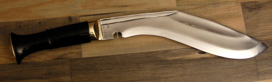

Moar pics of that beast
The first dent right to the notch was there when I got the AK, the second is from the blade to blade test.
Notice the difference of the fuller "design" on both sides.
I personnaly would have prefered the Kamis left it without the connecting lines instead of punching a third line.

Steve I love you!!!!!!!!! So I made the dent in the RED and my gestimate of low 50 was darn good. (petting myself)
David - by (1cm away from the notch) I meant 1 cm away from the notch ;-). You can see it on the middle pic, it is the closest dent from the right end side of the picture.
