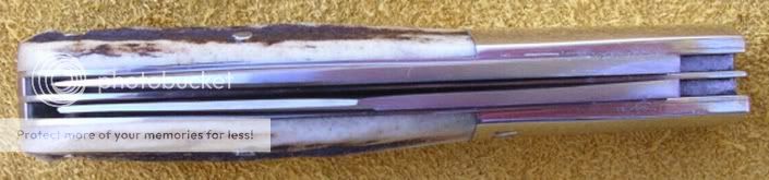

This pic shows blades centered and stag well matched for thickness. I'm not sure which blade had a "re-crinking" but i do not see any curve in either blade.

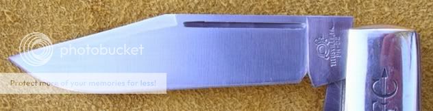

This shows the slight uneveness in the pull on the Clip. To me it's not significant as you have to really 'look' to see it and function is perfect. If this was a $800 Custom (av. price for a well made 2 blade stag Traditional) then i would be a bit disappointed that the long pull has this slight imperfection. Or if it were too shallow for nail to gain purchase, i would not like it. i.e. i put function over perfect looks ("Never make a pretty woman your wife ---")

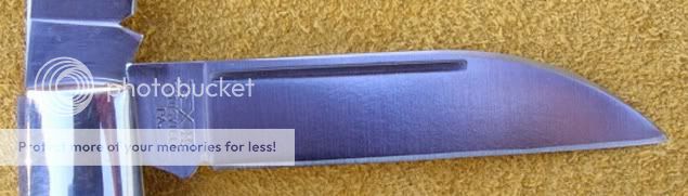

Long pull on Wharncliffe

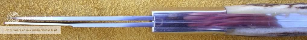

The Wharncliffe side liner is not completely flush with it's spring but i certainly cannot thread a dollar bill(USD) in this slight space and i checked again, no light shines through. This must have been improved from when Stu had it.

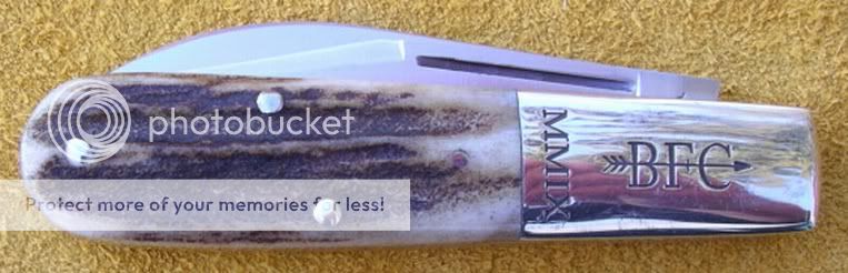

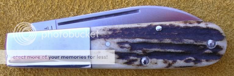

Stag

Bruce, since you are following this thread, how about your opinion on how well the Stag scales match ?
But no "Mr. NiceGuy" reply. "Mr. Experienced Knifemaker" reply please.

I got that $5 bill in there real easy, and it went in that far without being pulled from the inside, just pushed in.
As I said in the email to Charlie, the stag is fine, just not as well matched as it can be and by itself was not worth mentioning, but it wasn't by itself.
How many of your thousands of production knives with long pulls have a "bobble" like that? I only have a few and none of them do.

The stag is lovely, better than the average production stag in my subjective opinion. The knife is arguably the most useful and attractive Forum knife to date!

Mainly the crooked pull. The rest you will find on production knives young and old. You are brighter than you think George - errrrr.... Roland- - - - -yeaaa Roland!!:D:D
