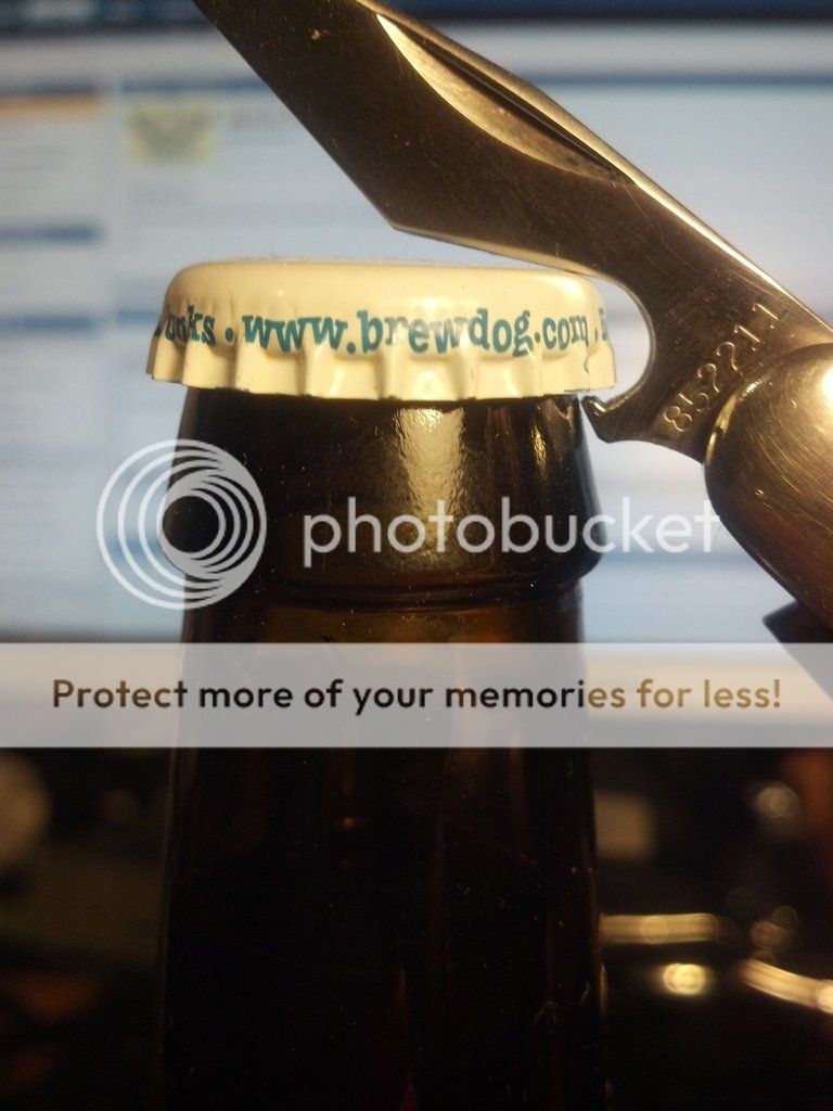

Took a trip with my buddy(a beer snob) to go fly fishing yesterday. For a part of the two hour trip we talked about knives and in particular my 2011 forum knife and how great it is and so on. Come beer time my great knife would not open the bottles. What gives?? At least the fishing was good.
Some people reported this issue and reground theirs to work better. With no firsthand experience I cannot say more.

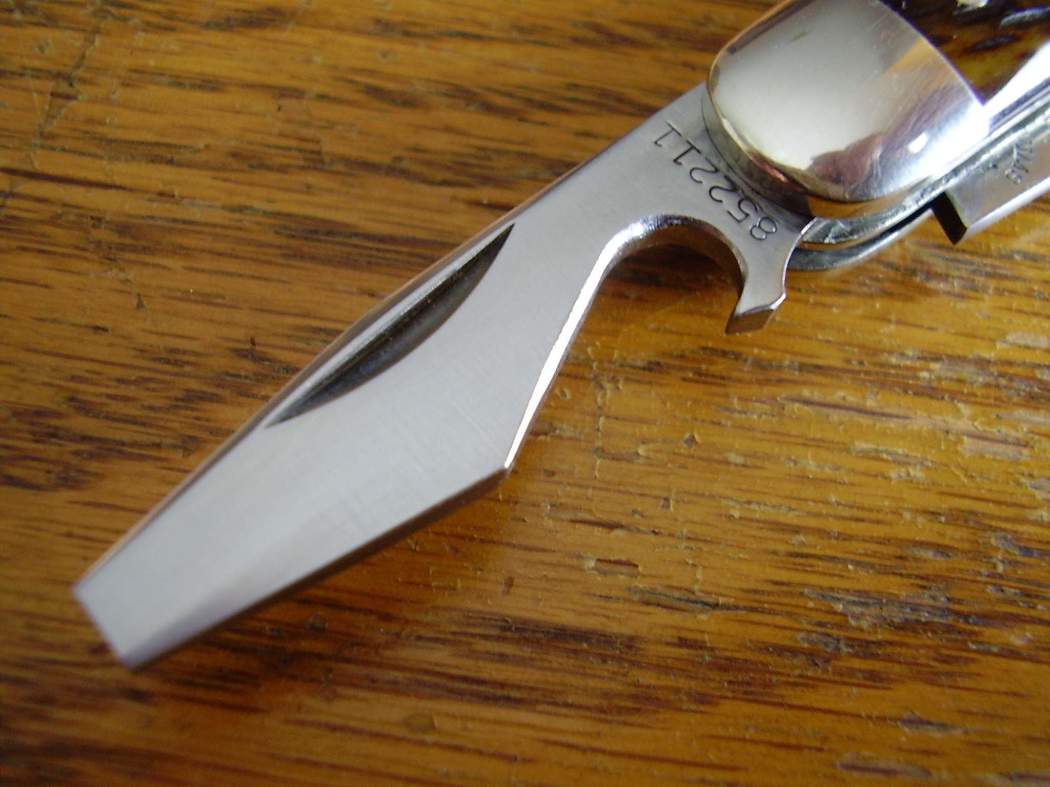

Hunter, great pictures! I love the Bauer also. I had the very same problem with my bottle opener. I had to mod/grind mine a little and it's simply the best bottle opener I have now.

Yup, a quick bit of time on a dremel, and she's easy! Mine get's used quite often.
The grind on the lower lip is not parallel with the top grind. Just cut in a bit steeper, and you get a sharp enough ledge to pull the cap in one try.
edit to add: Nice work on that one, Paul!

I did a little Dremmel work on mine works great, another option some members mentioned was instead of a straight on lift, come off from the side a little and grab the cap crimp with the corner of the lifter.
Yes Ted, that angled fast method works well!
I got a test 5 out of 6 bottles to open like that, the 6th seemed tougher, something must've interefered with my technique:D:D:eek:

At the time they came out, a number of people had the same problem. The manufacturer said they would fix it if you send it in.
