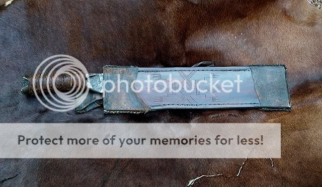

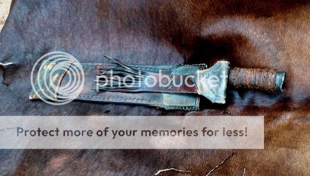

2012 Chopper w/ Sheath
Jan 1, 2009
583
Finally got the sheath finished on 2012. It is veg-tanned scraps w/ rawhide cuff, toe and on the belt loop. Dyed with homebrew Walnut stain and some simple Tribal scratching on the front.
Chopper is socket handled, wrapped w/ hemp. 18" overall w/ 12" sharpened. It was hand forged from a '46 Diamond Rio truck leaf spring in a charcoal forge.
Enough of these monsters for a while, I'm going to go forge a little skinner......Randy
Great whacker man, love the inter tribal sheath, a lititle Sioux/Cheyenne/Hopi mix ;-)) Great work Randy.
Best regards
Robin
Thanks Robin, actually the pattern is from a Crow shirt. I was stitching this one thinking of the Apocalypse of the American Indian 150 yrs. ago and decided to tie the two together. It is a pattern I have replicated in beads before and always liked it........Randy
Looking forward to your little skinner but like your choppers very much. They would serve anyone well after the Apocalypse.
And if the zombie Apocalypse doesnt arrive it'll split melons real well I think. I really like that walnot stain... you going to tutorial us on that ?
Pullrich, Thanks, I'll take pics the next time I make it. Pretty easy, just boil down Walnut hulls in water until it becomes like brown gravy , add more water, strain out the pieces and you have dye. Unlike vinegar, this will turn your hands a nice walnut color.
Thanks Howard, my arm is tired from all the choppers, a lot of iron to move by hand......Randy
