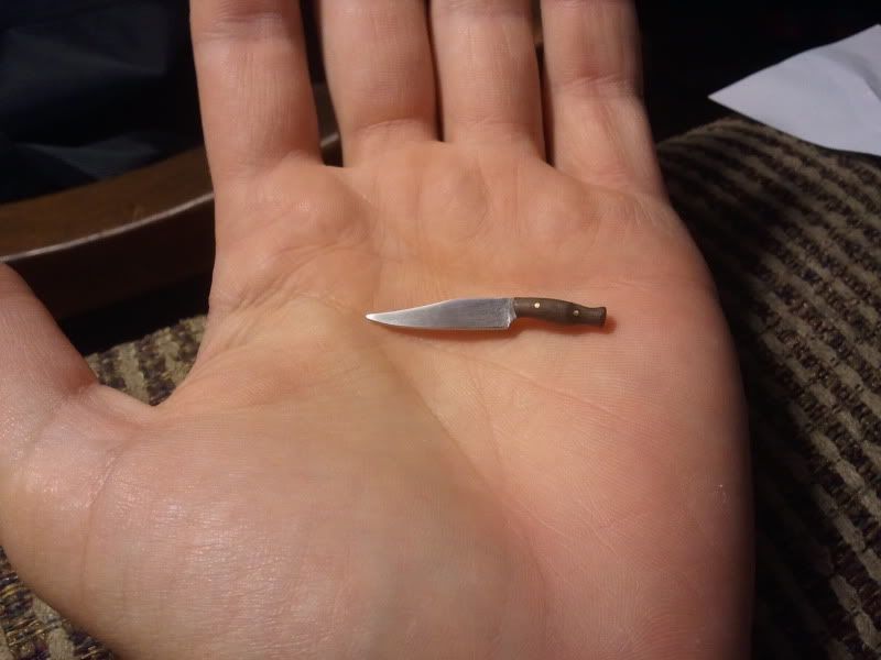

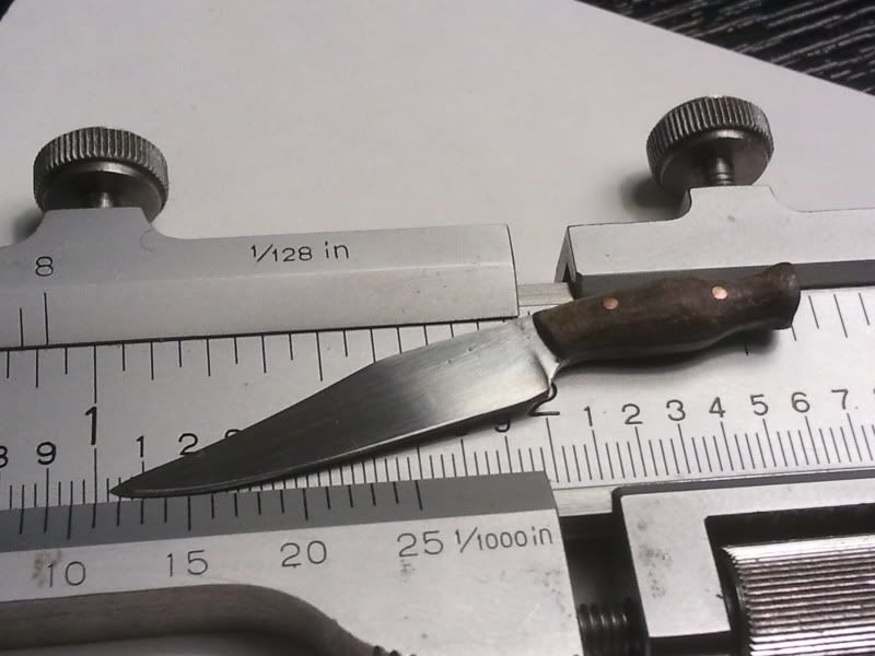

Well I thought I should post some more pictures up for scale.
It's about 1/10 scale
Forged 1080 from .130 scrap
.025 thick
1.6" LOA
1" blade
Pins are .030" strands from eletrical wire
And it is shaving sharp!
This blade is 1.3 inches long and roughly .028 inches thick
-Xander
