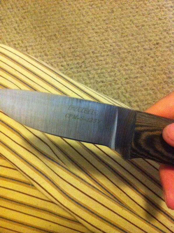

How hard would you say K390 is to sharpen compared to say...
This?:D:
This?:D:
I've never tried S125V. But from the finish on your blade, it wouldn't seem to be any more difficult than CPM Rex 121. I have two of those (from Farid) and they are a diamond and CBN only steel.
