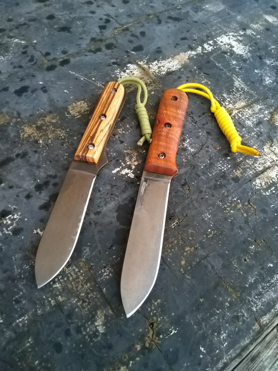

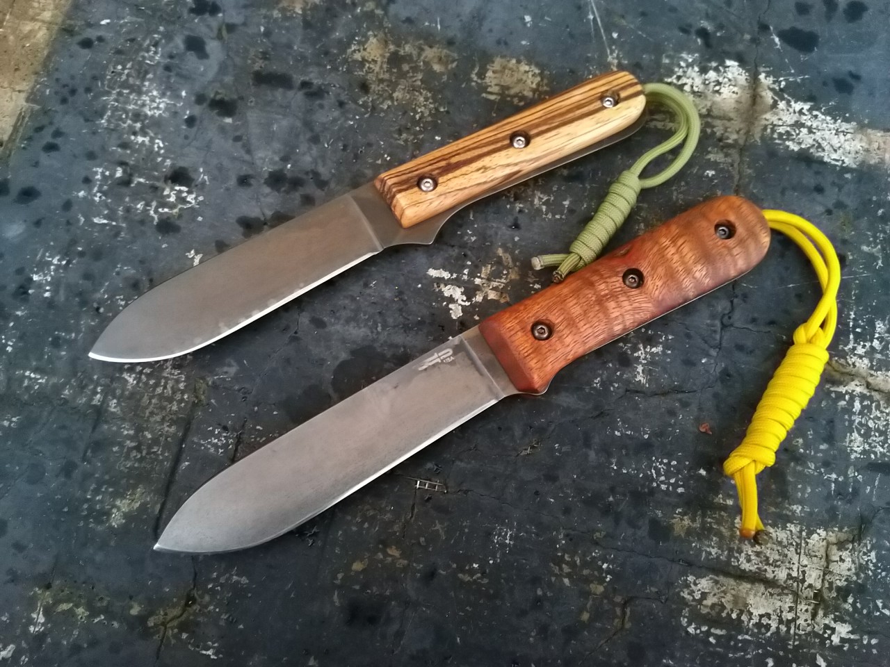

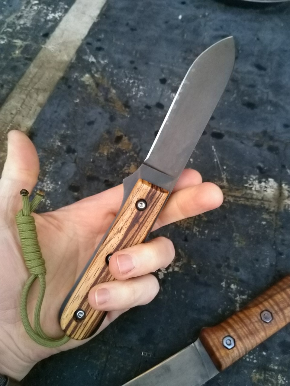

This variation is the AuK4s in burly 0.165″ 1084 with tapered tang, which is shortened to 4-5/8″ of blade, slimmed a bit in the handle, plunge pushed forward for extra grip area ahead of the guard waddle, and has the same hidden lanyard hole.
This one is sporting simple contour rebated zebrawood scales, though I’ll likely replace them with aftermarket scales when available for the BK-62 pattern (minor modification will be required).
Shown with its cousin, whose scales are really dialed-in for that classic Kephart feel:
