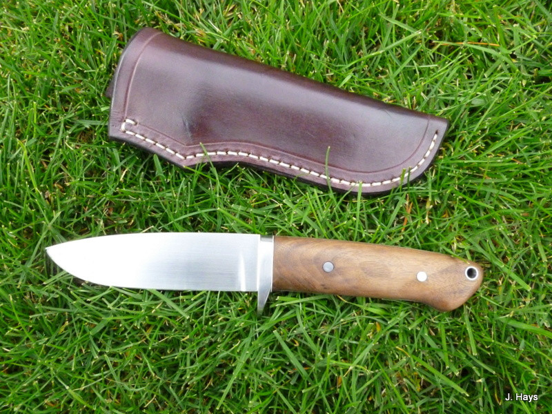

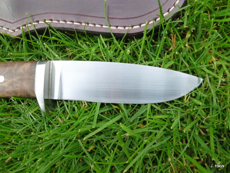

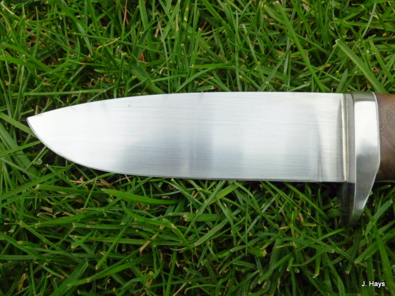

Finally finished off my second knife. There are a few things I missed on the fit & finish side of things when it came to (1) soldering the guard, (2) tapering the tang and (3) getting the handle liners on.
I did manage to get better/quicker at initial beveling and sheath making, the rest I still suck at. Funny thing about soldering the guard, I did a test piece with some scrap which took about 15 minutes from start to cleaned up and it was perfect. Sweet, I'm going to do a soldered guard on every knife from now on, or so I thought. I then spent approx. 10 - 15 hours over the course of a few days doing and redoing the guard on the actual knife, what a pain in the ass.
Loveless style drop-point
Steel: 1080+
Temper: ~60 HRC* (*beginner w/ a blow torch heat treat method)
Blade Length: 4"
Overall Length: 8.5"
Handle Material: Walnut (left over from flooring my kitchen) and white vulcanized liner. Used a walnut oil based finish called Pens Plus.
Guard and Pins: 410 Stainless
Finish: 800 grit hand-rubbed

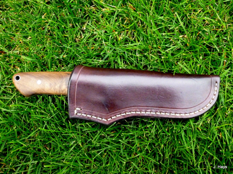

Sheath: 8 oz. Dark Mahogany stain (Eco-Flo brand), White thread (Tiger/Ritza brand).
The Tiger thread is way better than the stuff I have from Tandy. Also got some John James harness needles which certainly broke less than the Tandy ones, but maybe I just got better at not breaking them.

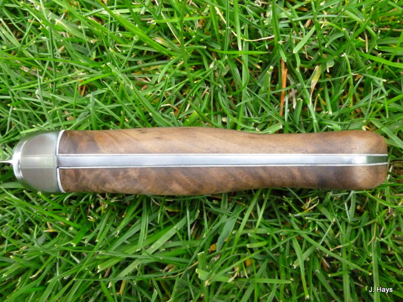

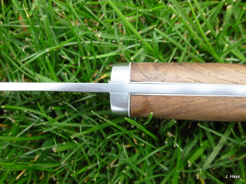

You can see where I messed up the placement of the liner on one side, leaving a gap by the guard :-(
This is probably a problem with my (slightly) tapered tang, doesn't look like I got the taper all the way to the guard again leaving a gap that the liner couldn't quite make up for. Also not sure how some guys make the blade to guard transition seem-less looking.

Nice job...
If you watch The Loveless video or SR Johnson video they both show how to get that nice fit on a tapered tang to the guard.
If I may make a suggestion?
Next time, when working with white liners, use white epoxy pigment with your clear epoxy. It will help cover small errors. You'll still need to get it 99% right, but it may have made the gap much less noticeable.
I used this method here and there could be a small gap or two, but I can't tell.
Love the knife. I'm too chicken to try my hand at guards like that for now. :) Taper could be a hair more dramatic, but it looks very nice.
Keep going!
I really like your sheath. Looks very well made and I love the mahogany color with white thread. I think I'm going to have to give that type of thread a try as I haven't been very happy with the tandy stuff I've used. This is just my personal preference but I kind of like my sheath to go up a little higher on the knife handle(maybe 2/3 of the way up). Either way it looks great.

The other problem I ran into with the white liner and clear epoxy is that it picked up some of the pigment from my black sand paper. It looked pretty good before I started sanding with the finer grits that came on black paper. Part of that might be that I started out w/ crappy paper from HF before getting some 3M.
Totally agree with you on the taper. Put everything together and I was less than impressed. I was scared on this one, next time I'll be going thin.

I like the sheath too. I don't know about white thread, never used it. I've read that some people have had issues with the thread picking up dye as it goes through the stitching holes, but yours looks good. For now I'm using Tandy thread and needles (haven't had any problems with either, knock on wood), but have read excellent things about the thread and needles that you're using. :) Those are probably going to be my next purchase, or at least the thread.
My opinions are the same as Nick's. You certainly have talent and abilities for this ! Recognizing any problem areas will help you to move forward more quickly and with the quality of work you are showing you will complete well done work all the time. Frank
I broke an entire 10 pack of Tandy needles doing my first sheath. I actually broke the first 9 less than 1/3 of the way through. I was doing something wrong. I had the needles with the big eyes on them but they weren't very strong and broke off almost every time I tried pulling one through the hole. I made 2 changes on my next sheath and didn't break anything: 1) I went back to tandy and bought the bigger needles with smaller eyes. Not sure what they're called or exactly what size they are. b) instead of drilling 1/16" holes like I did on the first one I did 5/64" holes. I actually did this for the last 2/3 of the first sheath too b/c I was down to 1 needle and didn't want to break it. I still ended up breaking that last needle but luckily it was half a stitch short of where I planned on ending so I just cut it off and stopped there.
I did have trouble with the dye getting on my white stitching. However, I think that was just because I didn't wait very long to stitch it after I dyed it. I used the same kind of Eco Flo dye as the OP and his looks just fine so I think it was me rushing the process that caused the problem.
