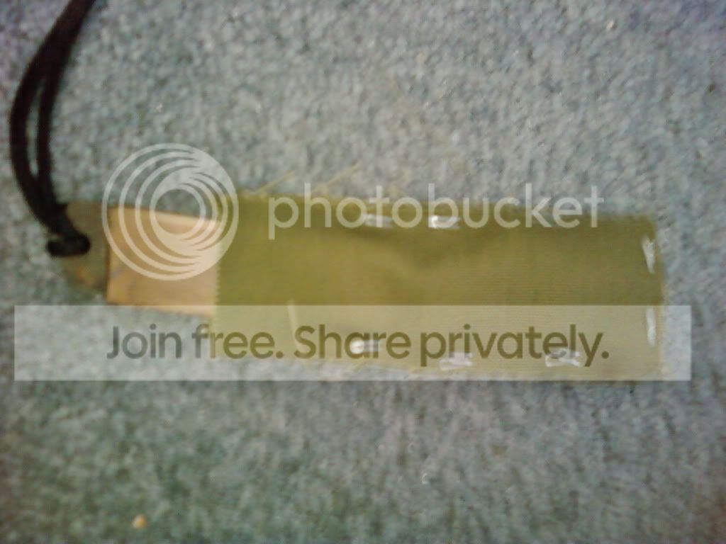

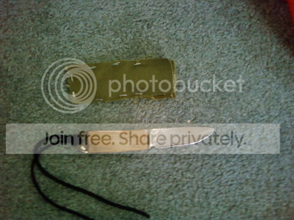

Ok go easy on me as this was build out of a sawblade, and the tools used were; bench grinder, angle grinder, cutting torch, various files and sandpaper, and last but not least the drill press. this is my second knife as my first was crap and made from a lownmower blade. anyways lets get the specs. It has a 3in. blade and about 7in overall. then handle scales are 1/4in oak plywood. the sheath was made out of od canvas that was stapled, then a imitation lambskin piece was inserted on the side of the sheath where the edge is to prevent the staples from dulling the blade. Anyways, heres the pics, and dont forget to comment.
Its very rough but shows lots of promise. Good Job! ... The handle scales should be more rounded. the blade needs to be polished. did you heat treat it? if so, How? Does it atleast skate a file?
Jason
It was annealed twice, then quenched in oil. then it was tempered with a propane torch on the spine. I figured it was tempered good enough when I could drop it on concrete from about 10 ft. up without it having any dings. as for polishing I have a polish wheel and white compound but I dont know how to polish correctly. since i took those pics ive sewed the sheath and hand sanded the scales a bit.
ouch i think i might be at risk of tetnus just looking at it !
at least use sewing needle and thread to put the canvas layers together
did you read the above post before posting such a ludicrous comment about the sheath. If you do not have anything constructive to say, then say nothing at all.
Looks a lot better than my attempts at knifemaking.
Like Jason said, I'd round the edges on the handle some more. Also, if you're going to pocket it in that sheath, I'd take a couple pieces of scrap leather or plastic and sew to at least the tip area to prevent it coming through. Otherwise, it's a good size and good shape and should make a handy user. :thumbup:

as for polishing , all you have to do is take the polish and put it on the blade one way or another .. anything from hand polishing, up to a bench mounted polishing wheel ..
Keep working at it. I've seen the first efforts of some top makers of today and they weren't any better than what you've done here. It will all depend on how much effort you put into improving.
